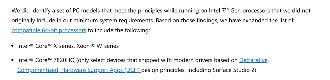

Microsoft has updated the requirements to include the Xeon-W, but I assume a later beta build will be required that includes this change.

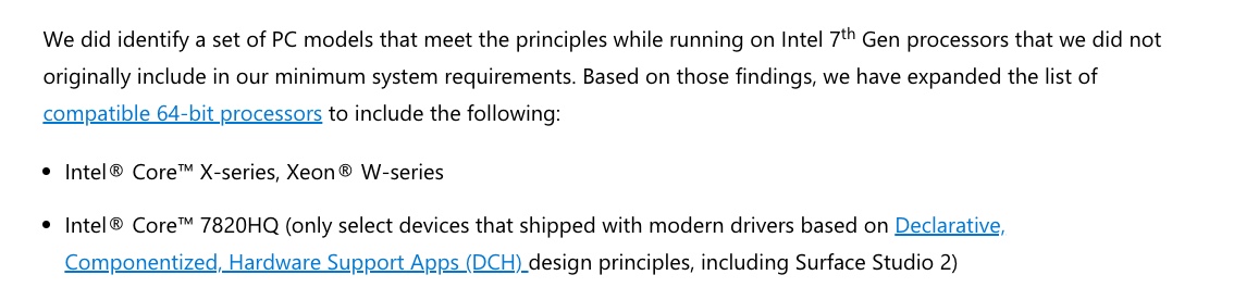

Thanks for the information. But I think as long as TPM 2.0 is required, it is still difficult to let the intel-mac install the boot camp windows.

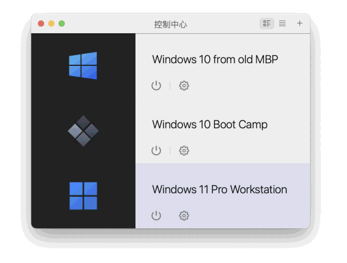

By the way, I have successfully installed a virtual windows 10 and upgraded to win11 withouth any difficulty. See the attached screen print (bottom one) as a proof.
