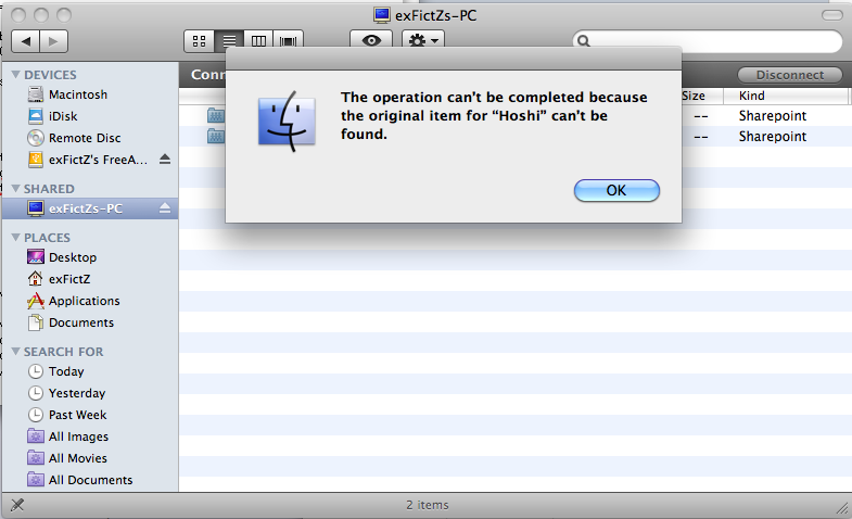

I typed the local IP address of the Windows PC, and I could see 2 folders are shared, which are 'Users' (sharing automatically preset, I didn't set this one up) and 'Hoshi' (which I set the sharing up, and it is an entire partition, not just a folder). Strangely enough, I could access the 'Users' folder:
but not the 'Hoshi' folder. This message popped up when I try to access the folder via its directory in Finder (exFictZs-PC from sidebar, then the folder itself)
And I got the message if I try mounting the folder at authenticating step:

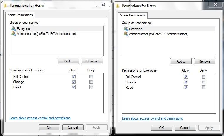

However, if I check the permissions on the Windows side, they show the same settings:
Any ideas ? 😕
