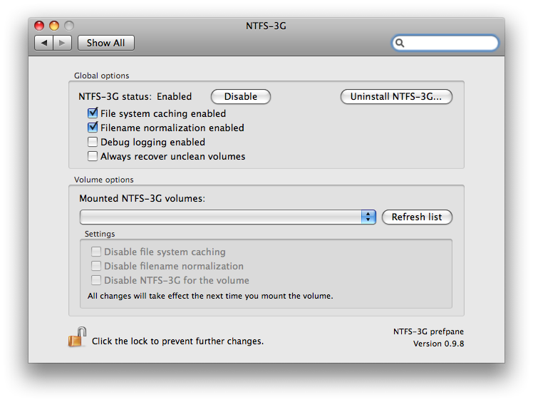

Well now i is the opposite ! I can boot from the Windows partition but I can't mount it in OSX :s Before I could mount/read/write the ntfs partition without problem. Now I see only disk0s3 in the Disk Utility. I also updated my ntfs-3g driver but it can't see any partition (see screenshot). What's wrong ?!
Any ideas ?
Thanks,
T
EDIT: I think this was because during the installation I removed and created the partition instead of just formating it to NTFS. I installed Win7 again and now it's ok again 🙂
