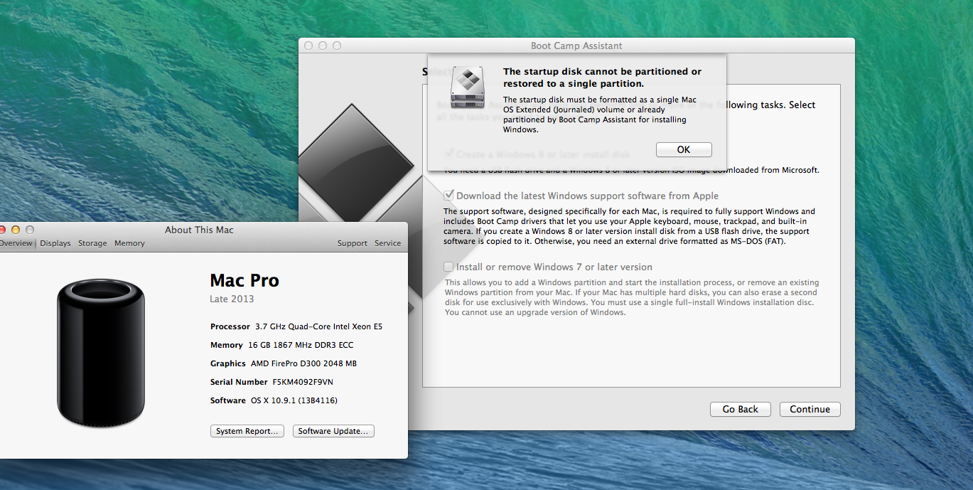

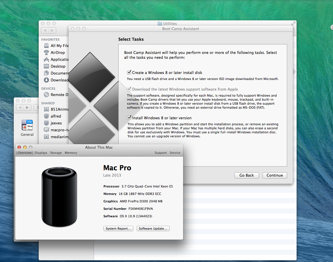

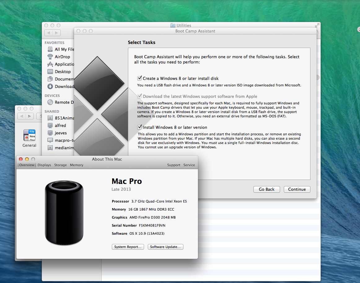

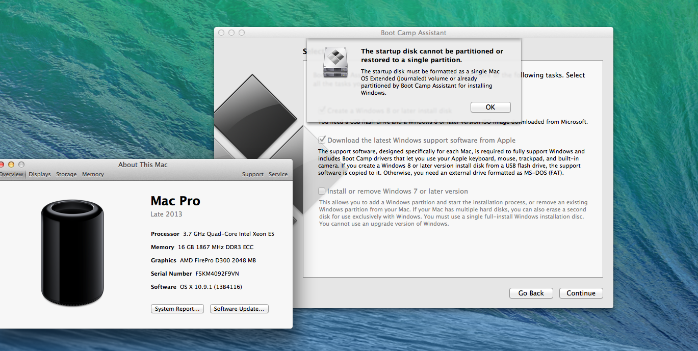

We actually got two MP Cylinders and it turns out the Bootcamp options on my co-worker's machine allow for installing Windows 7, but the Bootcamp on my machine only offers options for installing Windows 8. Same specs for both machines! I've attached the pictures from both machines (even though it's not reflected in the picture, I updated my OS so it matches hers, but no change in the Bootcamp options).

I've read that only have one drive can be plugged into the USB ports when Alt-booting, so maybe that's the problem.
(1)Yes, do not attach more than one USB drive when booting the DVD installer, and uncheck the first item if you are running Boot Camp Assistant with DVD.
(2)It's very interesting that your colleague's Boot Camp Assistant has different settings than yours for whatever reason, but I think yours is the official version. I believe you can hack the "info.plist" to get the same result, but it might not be worth the time. The easiest way is to make a copy of your colleague's Boot Camp Assistant in the Utilities folder to a USB drive, then paste it to your desktop. Run it from the desktop and see if it has the same choice. If it works, then you can move it to the Utilities folder if that's what you prefer. But you still need Windows 7 drivers to make the installation work. Hope this helps.
That's a great idea, will give it a try and if it doesn't work perhaps I can copy the info.plist. I get what you're saying about the Windows 7 drivers... perhaps this exercise is a bit of a time waste if I can't get W7 fully functional once installed (if I were to get that far).
