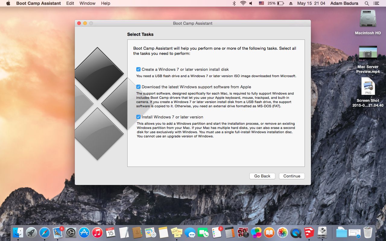

I thought of that until Bootcamp gave me the USB option for Windows 7 specifically. (attached photo)

I read that to mean you can use USB as a media/driver installer drive, not a bootable OS drive. There again, I may be wrong, I've not tried it myself.
After I created the USB it just said it was done, not giving me the option to install, but Ill definitely look into making it bootable.
