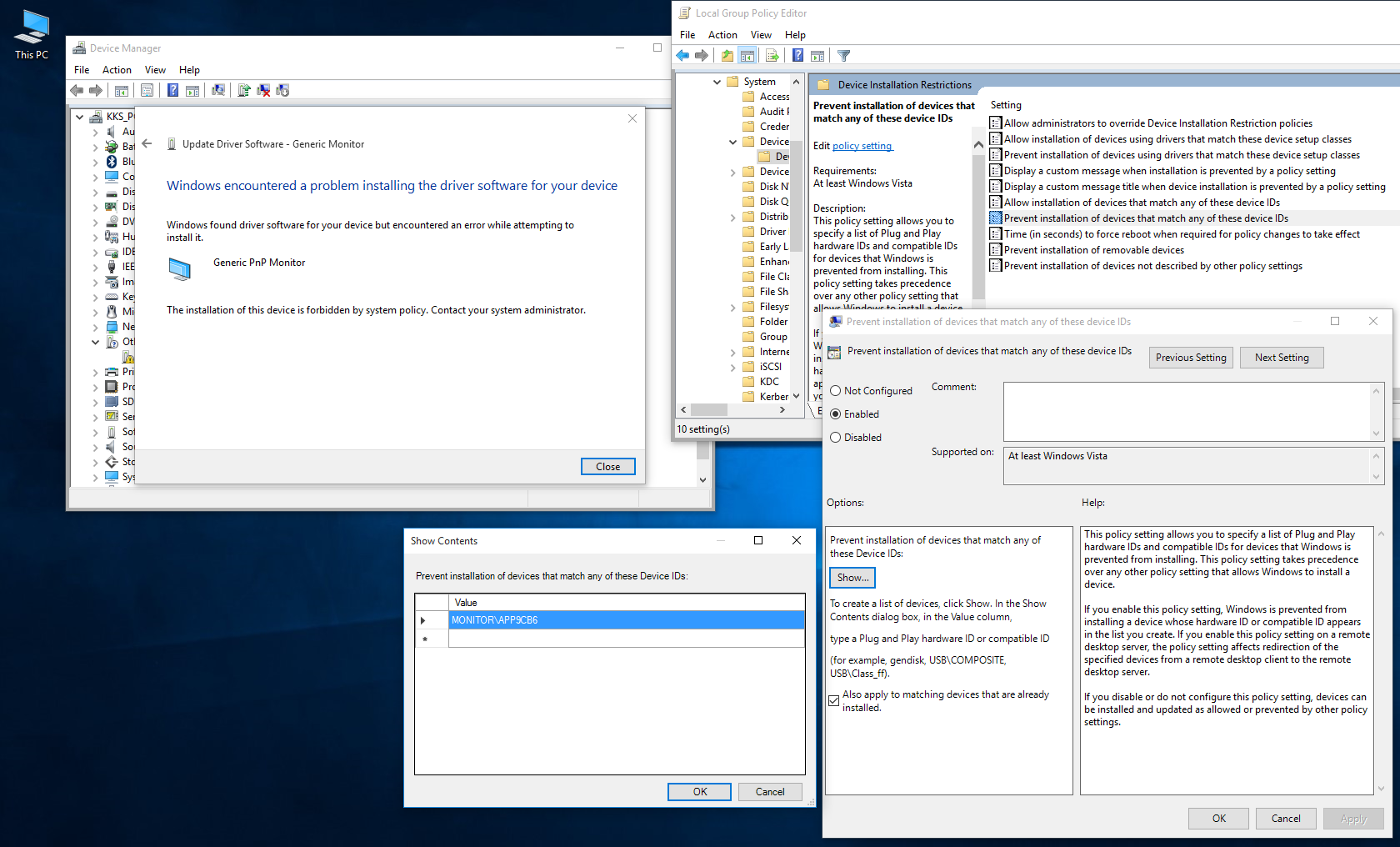

When I reboot Windows 10, the Generic PnP monitor driver reenables itself 🙁 Without turning off automatic driver checking in Windows 10, is there any way to keep the Generic PnP monitor disabled on reboot?
Figured it out. Used group policy editor to prevent device from being installed via device ID.
