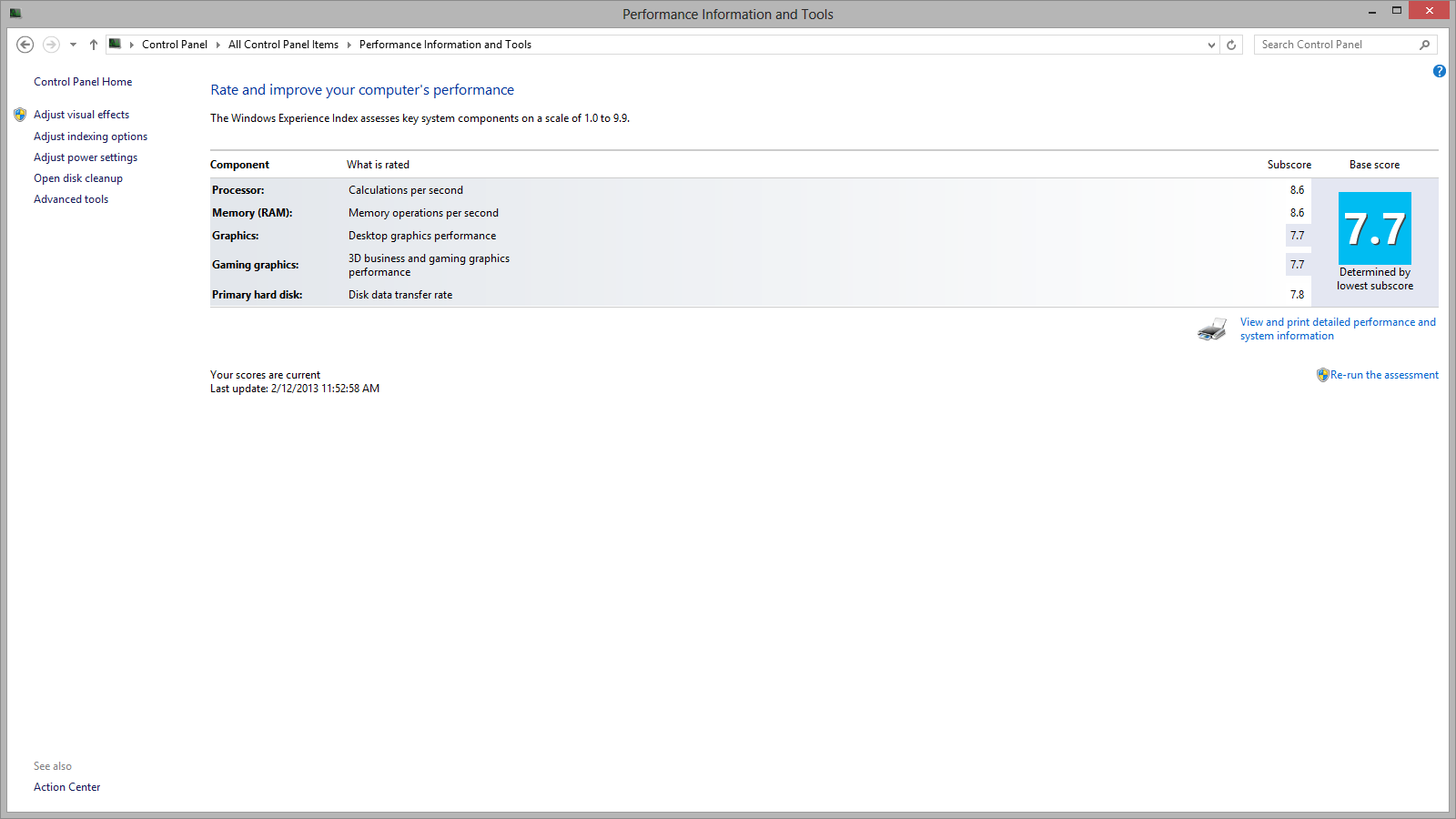

I just wanted to share with my Mac Pro friends that I installed the OS I love to hate on a stock 3.06 x2 2012 Mac Pro to see how it would run. I had time and needed to get some things done in Windows, so I took the plunge. I had all of my OS X data backed up on other drives so nothing of importance on the main Apple 512 SSD drive. I disconnected all other drives, and booted from the Windows 8 Enterprise x64 DVD. I selected EFI Boot as the bootable drive. Windows 8 installation appeared at the correct resolution during setup (2560x1440) and I dropped down to the command prompt and "cleaned" the SSD doing

Here is the WEI for those interested...

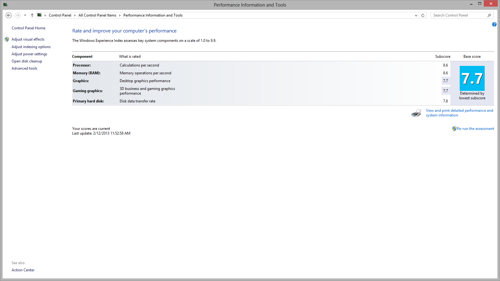

What GPU are you running? I scored an 8.1 with 8 but went back to 7 when I got screwed with that whole shady upgrade program. But with 7, it only maxes to 7.9. I think my 930 256gb SSD only scores a 7.3.
It is a stock 5870.
Have you tried running Windows 7 with EFI boot? From what I have read it may not be easy but have not tried.
