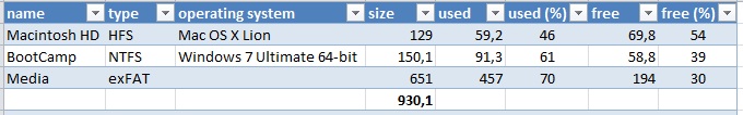

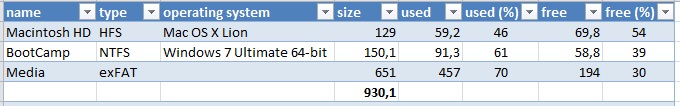

I've 3 partitions on my iMac, pls take a look at the attachment for details about types and sizes (as seen from Windows)...
