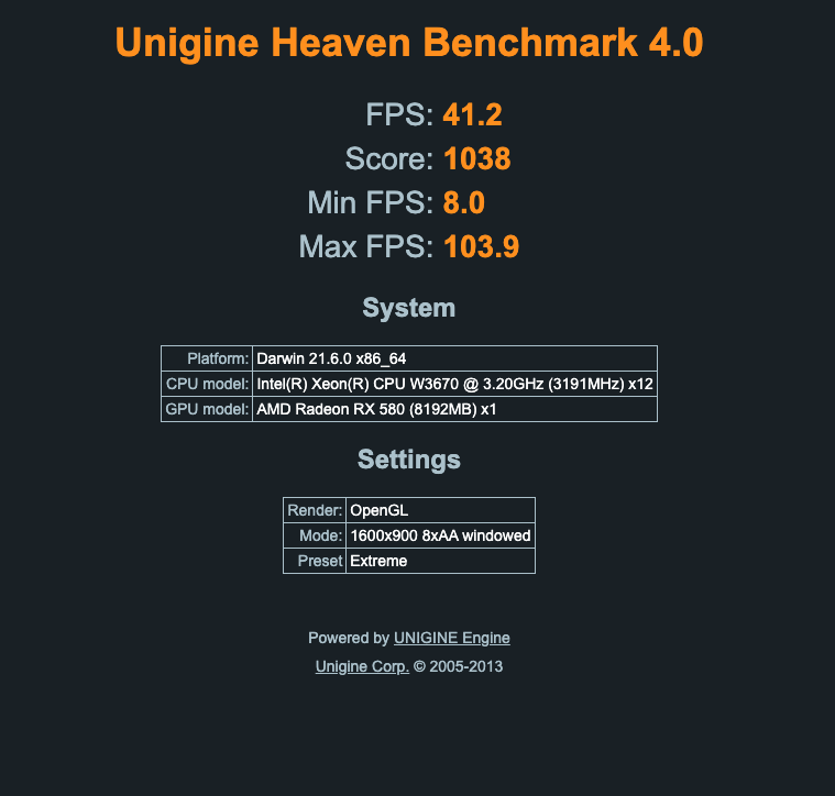

Not sure what a good score is.
Did not seem to do anything out of the ordinary
Only have had 1 other game where the shutdown would occur during a few of the cutscenes only.
This one, as soon as the loading screen started.

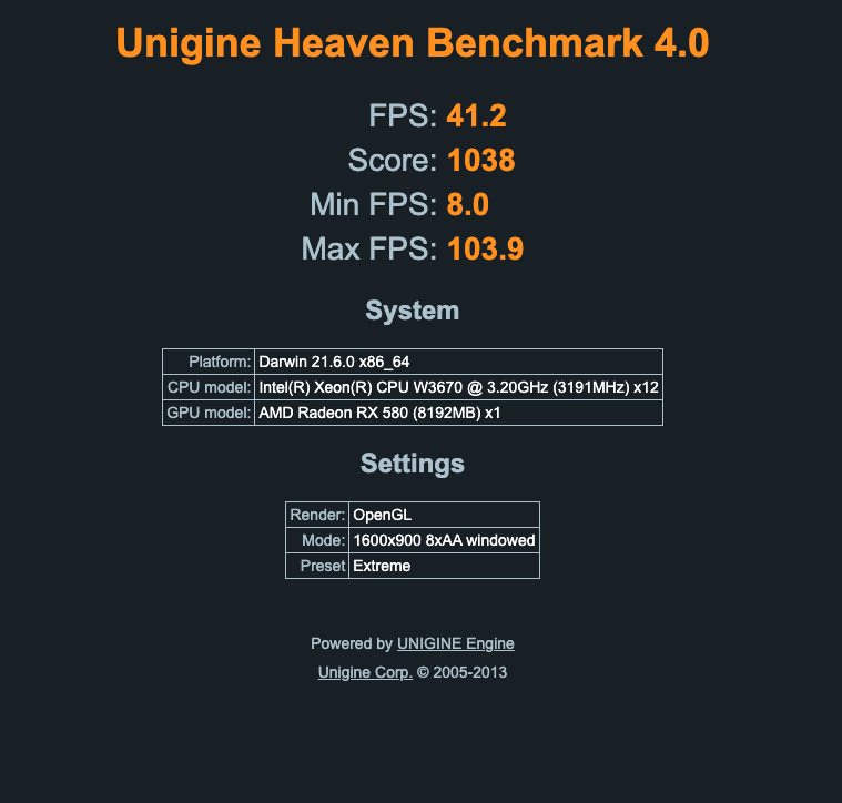

I think you said the problem only exist in Windows gaming, isn't it?
You better do this test in Windows. Of course you can get the benchmarking score, but you don't need to run the benchmark, but just keep it open for something like 20-30min, and see if anything strange.
Yes is windows. I see that makes sense.
