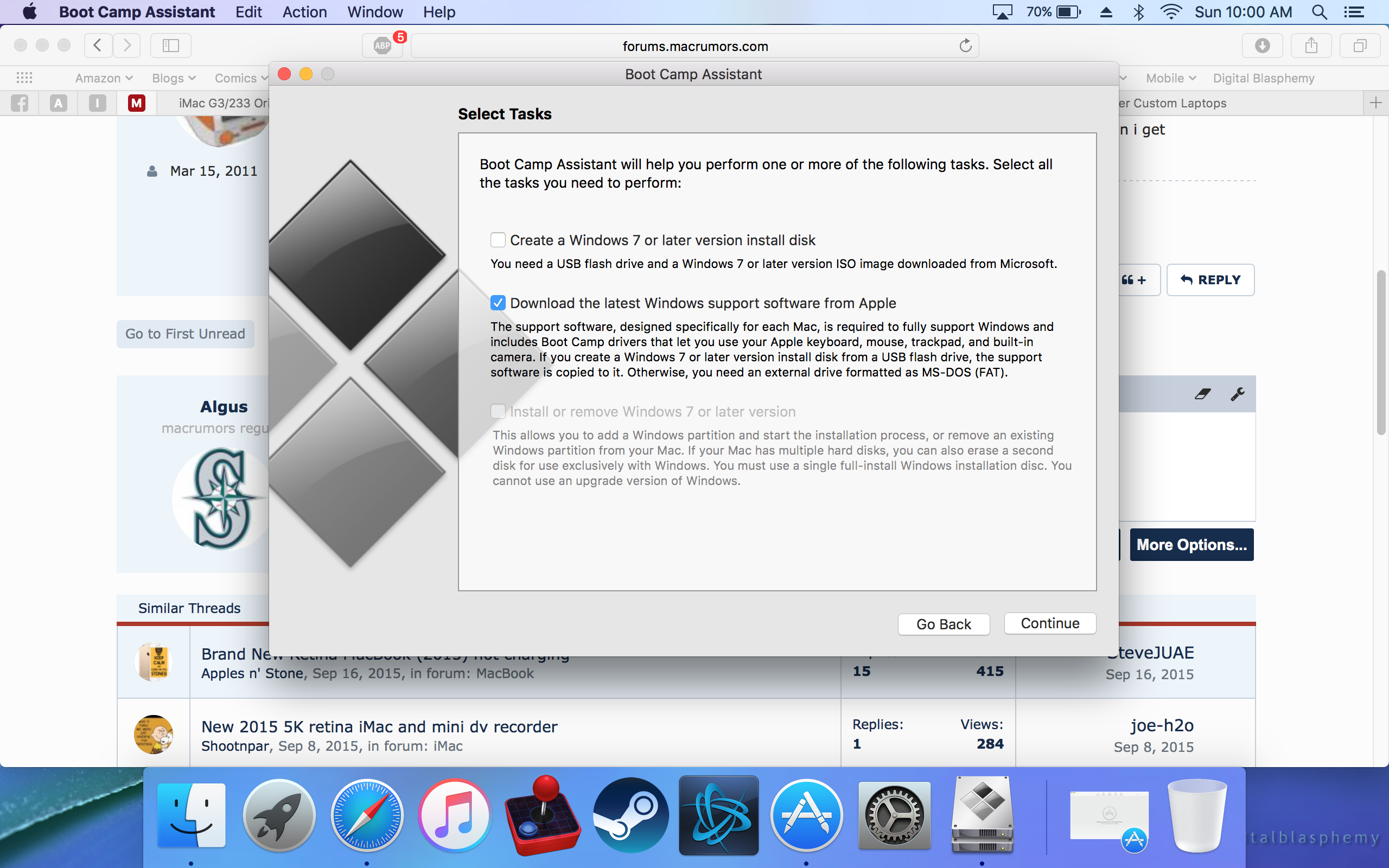

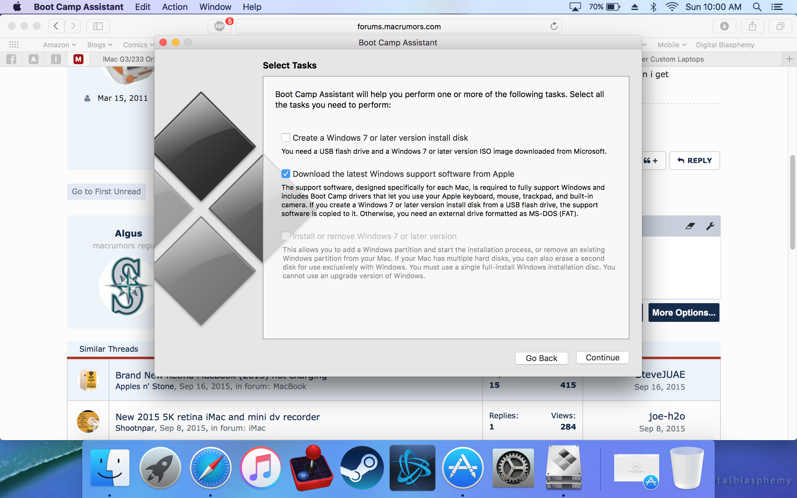

You create a USB with the drivers via Bootcamp tool in OS X. See attached image for the box to check:
This USB has a setup program so once you boot into Windows you run that and it installs all the drivers automatically. Bootcamp ~should~ have installed the drivers when it installed Windows but sometimes things don't work right for whatever reason. If you install the drivers with the USB drive it should fix any strangeness there.
