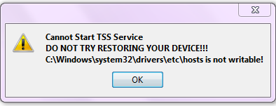

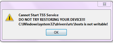

When I download and open tinyumbrella it opens with an error message which says Host are not writable.
A while back I messed up my host file so I searched online and found a "Host file fix" from Microsoft, that from what I understood put the host file back to default. I can restore with Apple fine during the signing procedure but not sure if I wanted to downgrade my firmware via Cydia I'd be able to now due to the fact I can't alter my host file. Which I'm pretty sure also means TU can't alter the host file either.
I've attached a picture of the error message for all to view.
Does anyone have any clue as to how I can fix this issue? Any help or advice would be greatly appreciated.

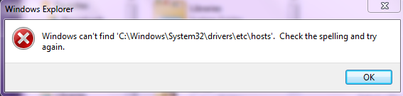

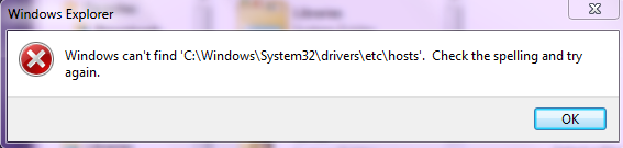

PS...and then when I go into Note pad as Admin and try to open the host file to see if I can rewrite it...I get the second error message saying to check the spelling and try again.

And you're sure you're running TU as an Administrator, logged on as an Adminstrator on the Windows box?
Go to "C:\Windows\System32\drivers\etc", right click on the hosts file and select properties. Make sure the box next to Read-only is unchecked. Click Apply, OK and try it again.

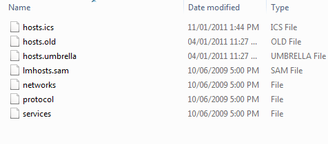

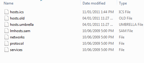

Which one would you suggest doing that to?
Sorry guv but you don't have an HOSTS-file in that list. It should be named HOSTS only.
Rename HOSTS.umbrella to HOSTS and post the content of that file before you proceed or just use this default HOSTS-file
https://forums.macrumors.com/posts/11915265/
You smart Sonofa*itch!! haha changing the umbrella file to Hosts seemed to work great. Now when I open TU I don't get the error message anymore!
