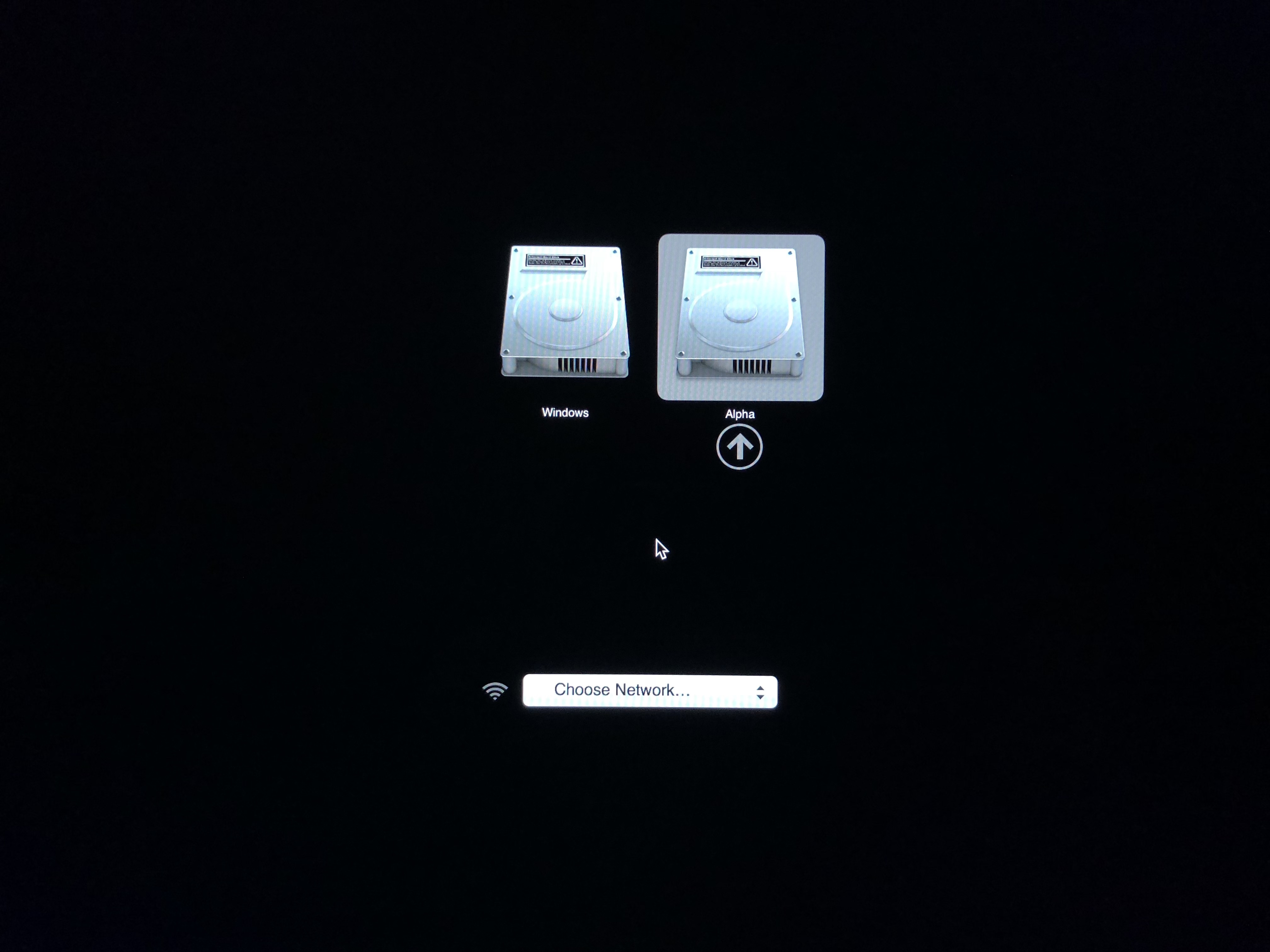

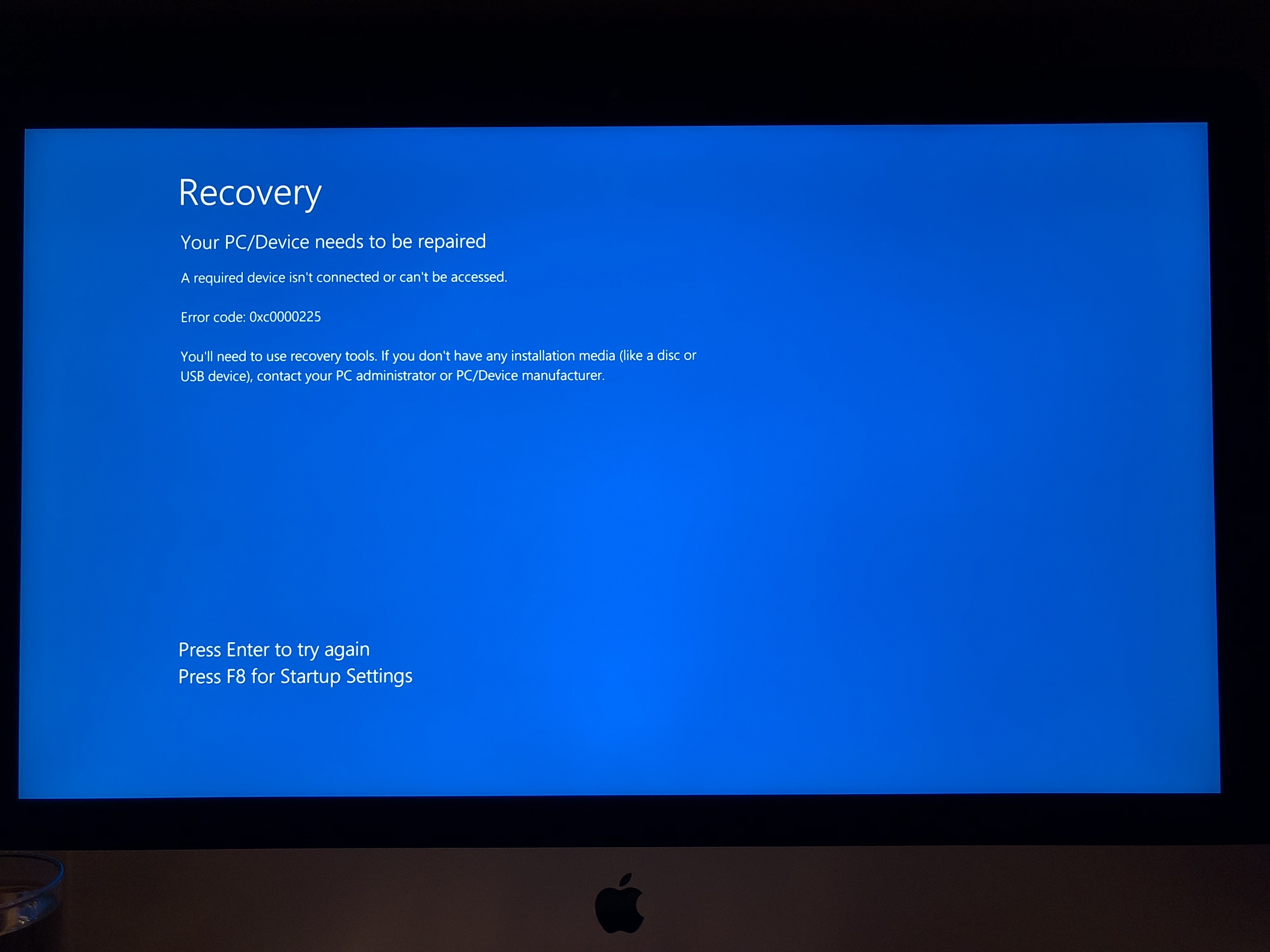

upon hitting the option key on startup I get a windows volume and my Mac OS one
I have never installed windows via bootcamp, I have a parallels 12 installation with a windows 10 vm
why is that?

Can you boot to that drive? I'm not a Parallels user, but since its a VM machine, it doesn't partition your drive, but rather lives in a directory under MacOS. Do you maybe have an external drive plugged in name Windows?
no external drives
when I boot to this volume I get a windows 10 recovery blue screen

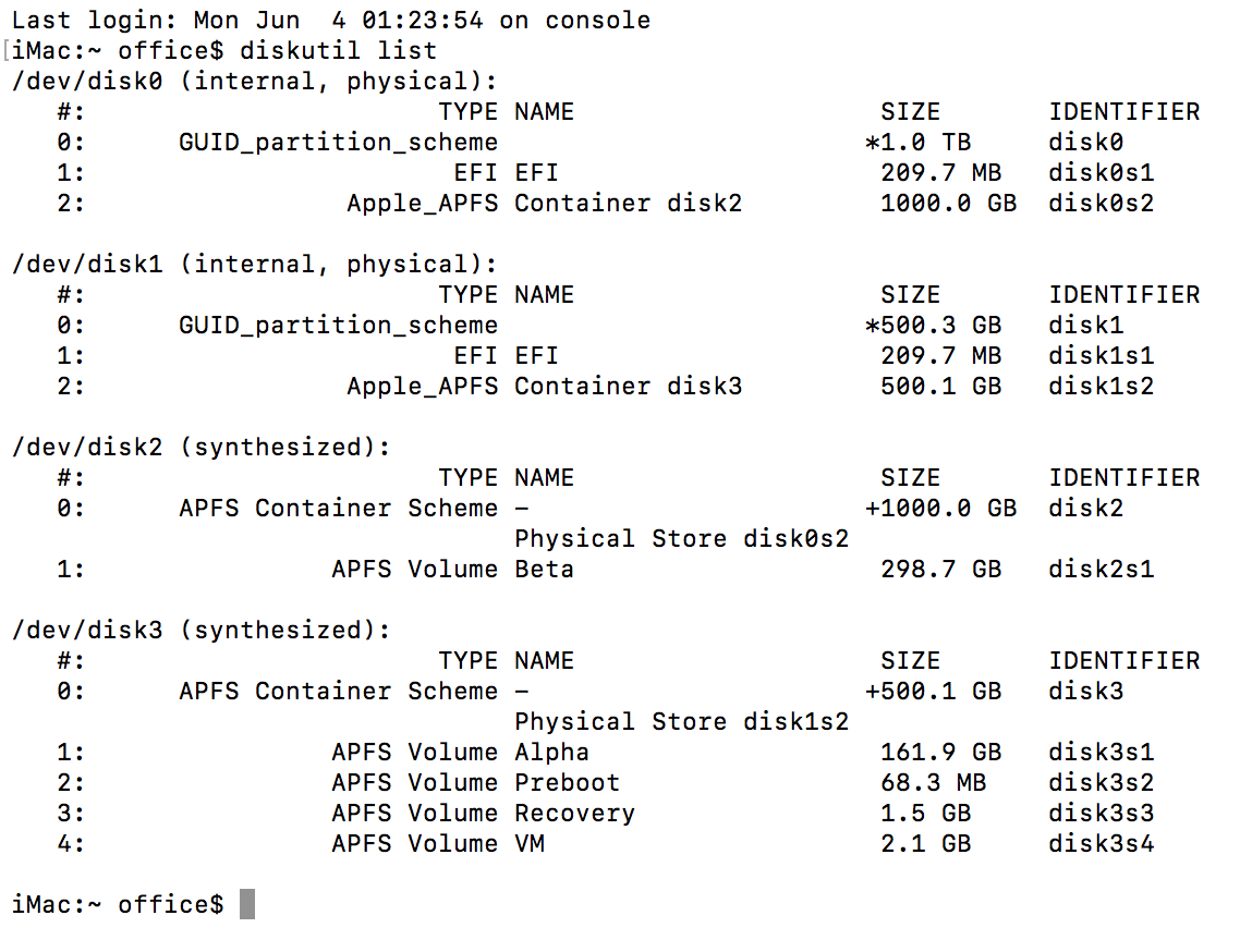

I have two disks, a 512GB flash and a 1TB SSD

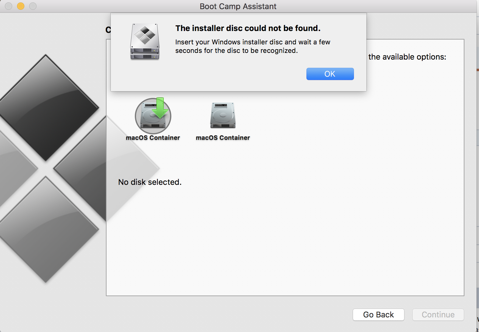

One more weird thing to accompany the problem, I have used bootcamp assistant only to download the bootcamp drivers software for another install, never did I create a bootcamp partition, but the utility now seems broken, I only get this error no matter what I do
"The installer disc could not be found."

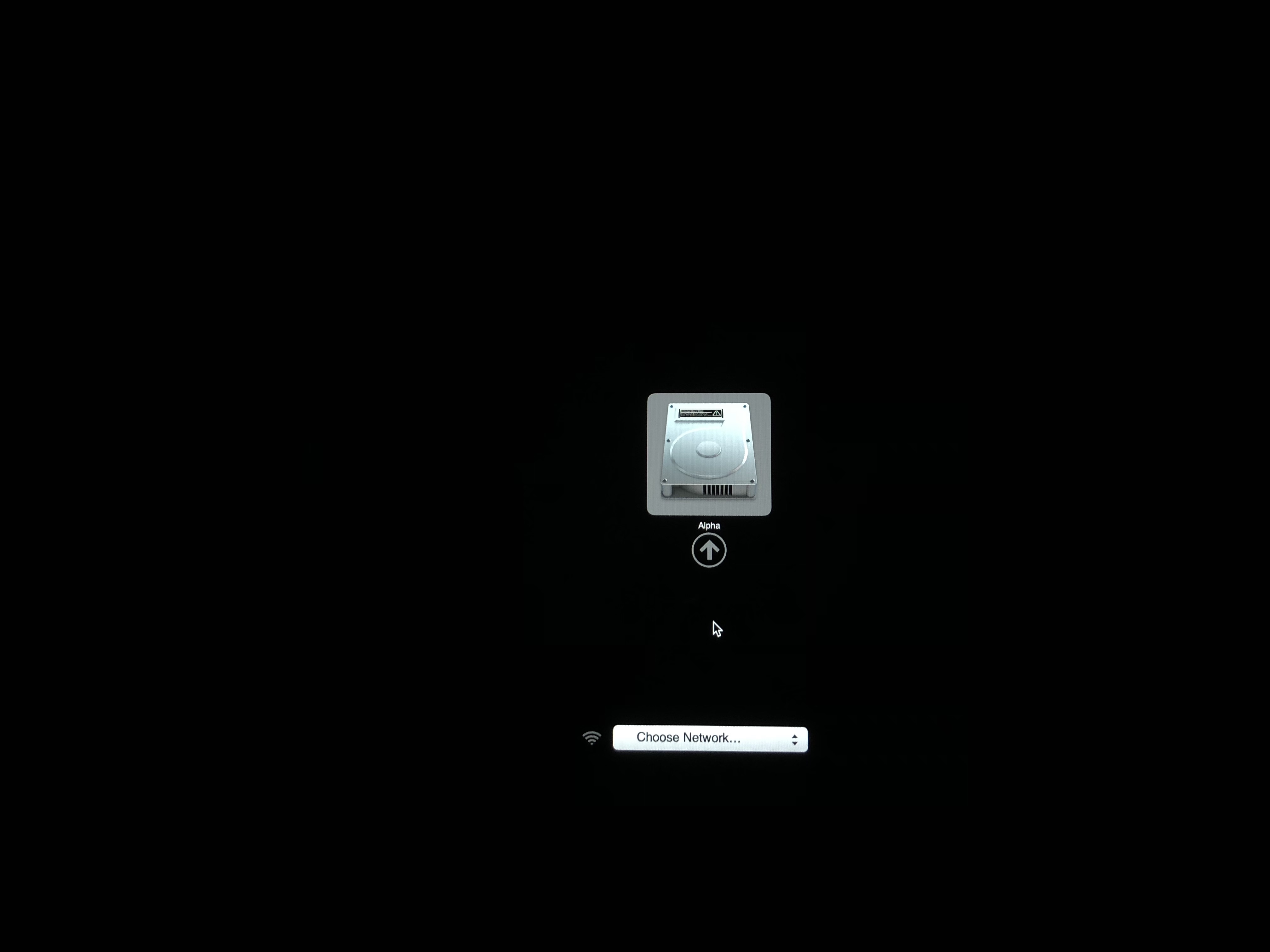

these are shots from my MacBook Pro which is perfectly fine

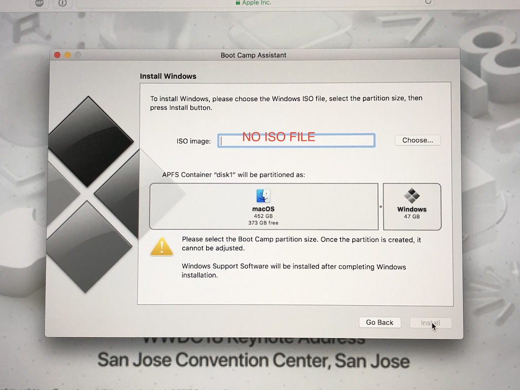

It feels bad bumping but I am in a dead end :Q
I really don't want to do through a clean installation if its something that can be fixed
I would really appreciate some help
thank you in advance
As you can see from my previous message this is not possible due to the error in the Bootcamp assistant

Bootcamp had an error when downloading the drivers, then tried removing the partition it created but it was just laying around without doing anything for hours, so I just quit and now I am having this
Are you the first user?, There was Windows installed on your machine and it was not removed the right way using Boot Camp, instead only the partition was deleted leaving the windows record in the boot partition.
To fix this you need to erase the disk and not the partition and do a clean install.
Leaving it as it is will not harm your Mac in anyway.

Based on what you've said, it seems Bootcamp Assistant did indeed create a partition, then for whatever reason, things went wrong and it wasn't cleanly backed out / deleted. As Shafez said above, the small boot partition in your 500GB SSD is holding a list of boot options that claims Windows is available to boot to, and hence offering that as an option.

What do you mean by "512GB flash"? I don't think that's the right name for it. I can see from the output of diskutil you posted earlier that your mac boots from it. What sort of mac do you have?
iMac 5K Late 2015
1) Apple Blade PCIe Drive 512GB
2) 1TB SSD 2.5"
These are the disks that replaced my fusion drive (32GB PCIe , 1TB HDD)

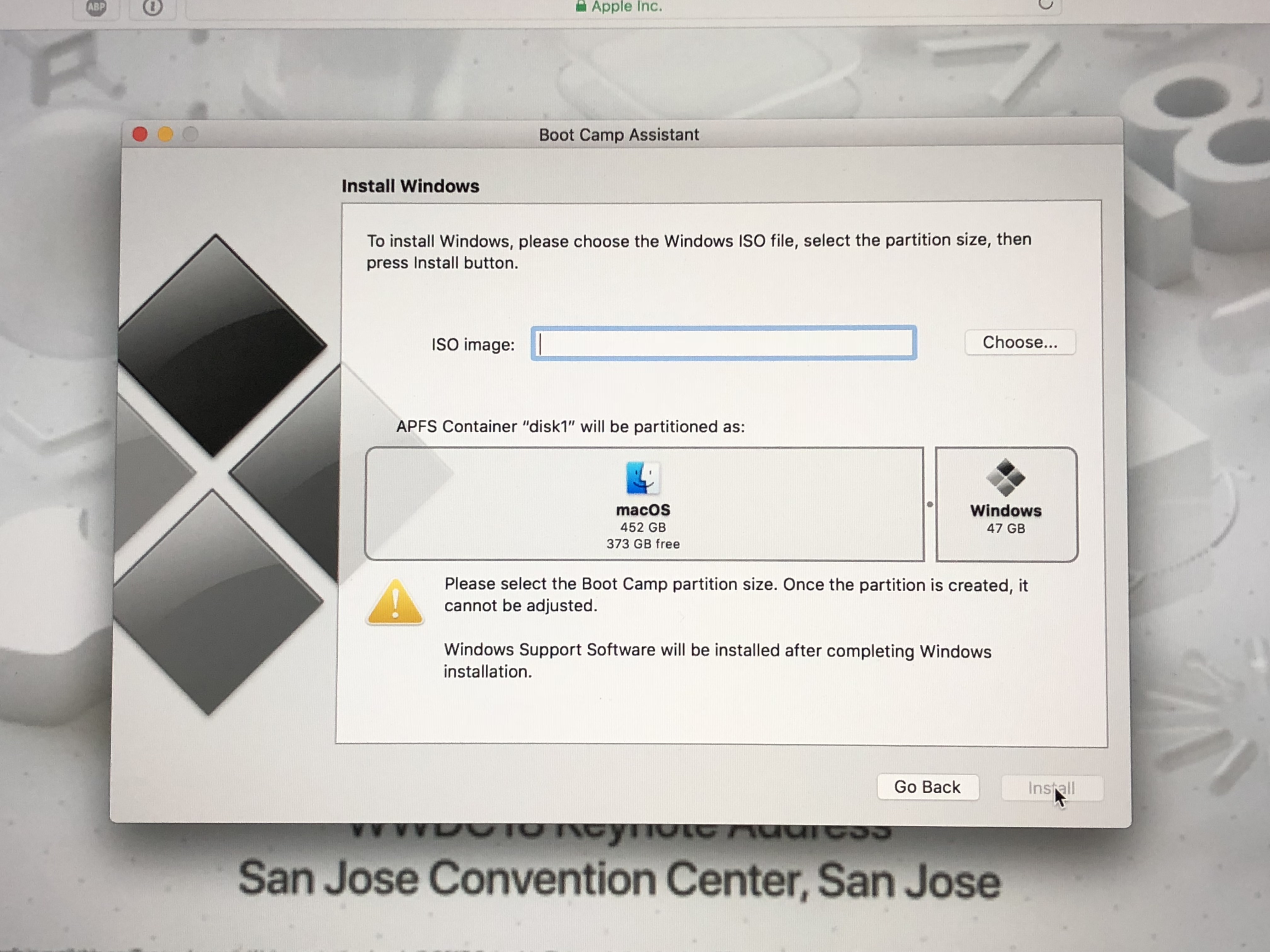

- Create a Boot Camp windows partition and follow instructions till you reboot to windows Setup.
- Reboot back to macOS and go into Boot Camp and remove the windows partition.
This should solve your problem and remove the windows partition from boot.
Tested.
I can't
it fails every time and bootcamp stalls with a message saying that it reverts the configuration by removing the partition
I suppose this happened the first time and now that why I see a windows option upon booting

Mounted the EFI partition and deleted two folders in my case, boot and Microsoft, left the APPLE intact
Problem solved
Thank you for your help and your time
