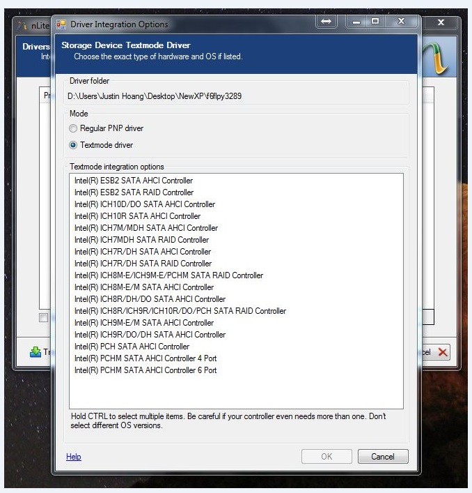

Running XP on VMware is certainly easier, and in most cases it will work just as well as a native installation. If a native installation is required however, then you can do the following:
You'll need a working Windows installation (any version will do) to make a new installation CD/DVD. Use nLite (or similar) to slipstream the AHCI/SATA drivers, which you can get from the Intel website. Use this guide to make the bootable cd: http://www.sevenforums.com/tutorials/72185-sata-drivers-slipstream-into-windows-xp-cd.html
Now create the required partitions with Boot Camp Assistant (I suppose you already have, as you attempted the installation earlier 😉). After the partitions are created you can skip the rest of the Assistant's steps, just put in the CD/DVD created earlier and reboot holding the Alt key, and select the installation CD/DVD. Now the installation should work.
After the installation download the chipset drivers and graphics drivers.
After this you'll have a bootable and working OS, however you won't have the function keys (volume, brightness, etc.), and the trackpad will not have scroll or second button functions. To make those work you'll have to download the Boot Camp Support Software and try to install the drivers individually. Do not use the main installer, but the installers found in the driver folders. Note, that these might not work, and you may not be able to find working drivers anymore!

Any idea which controller is in my MBP 13" latest?
I have a long list, tried the most common 4 port, no go.
Wanted to check in before I started wasting all of these DVDs 😛
I think you can choose to add a *folder of drivers*. I am not sure of the naming, nLite is so far but there is a way to add in one time all the inf and Windows will perform the right choice by itself during installation.
EDIT : You can select all with CTRL + A or CTRL + Clic on each.
No luck.
Tried almost every variation-
Selected every one in the box available, no go.
Selected PCH in Text mode, no go
Selected PCH in PNP mode, no go
Selected multi folder drive and selected all, no go
Selected multi folder drive and selected just PCH, no go
What happens is once it loads all the drivers, bottom left it says, "Windows is setting up," I believe.
Right when it enters the "What do you want to do page" where you can select to install XP, etc, it blue screens. (I don't see the screen, it BSOD's right before it).
Went through so many DVDs, any other suggestions?

Whatever ends up working for you is going to be rather "hackish". So, I'd try downloading and using this driver.
http://support.lenovo.com/en_US/detail.page?DocID=DS033452
Your system should have the Intel 7 Series Chipset 6-port SATA AHCI Controller, going by the lspci output from other people that have installed Linux on their current MBP's.
The Windows XP driver at that URL is for that Chipset ... so it stands a good chance of working for you.
The real trick will be getting it onto a floppy disk and seen by the MBP during the Windows XP installation. Hopefully, you have a USB floppy drive and disk sitting on a shelf somewhere.
If you want to give that *lite utility another shot, then I would select the following TWO entries (none of the others make sense to me, knowing what I currently know about the suspected chipset that's in your system):
- ICH7M/MDH SATA AHCI Controller
- Intel(R) PCHM SATA AHCI Controller 6 Port
You could also try "injecting" that driver linked to above into the Windows XP install media, if nothing else works.
If none of that works, just use it as a virtual machine (you've already put forth way more effort than I ever would have up to this point. I would've create a VM long ago.)
Winner winner chicken dinner!
Don't know what it was, but made a combination of the below:
- Lenovo Intel Chipset:
- Intel SATA AHCI 6 Port
- Intel ICH7M/MDH SATA RAID Controller
Got it right into the installer.
