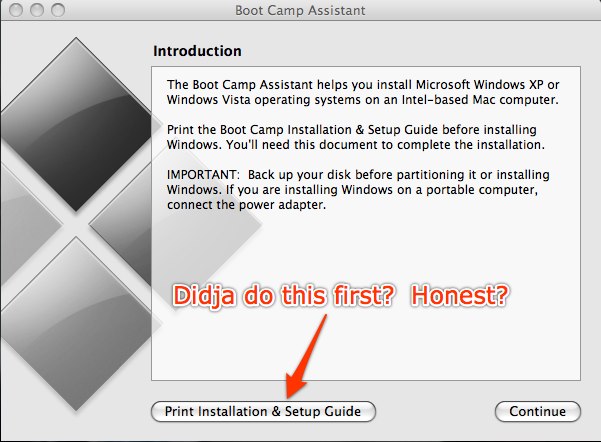

haha did u make that picture after i like screwed up with boot camp , but for some reason i thought it was the control key at first to boot screen lol 😱
Actually, that pic is months old, and has been used quite a few times. You'd be amazed at the number of people that make one assumption too many about Boot Camp setup (myself included). 😱
