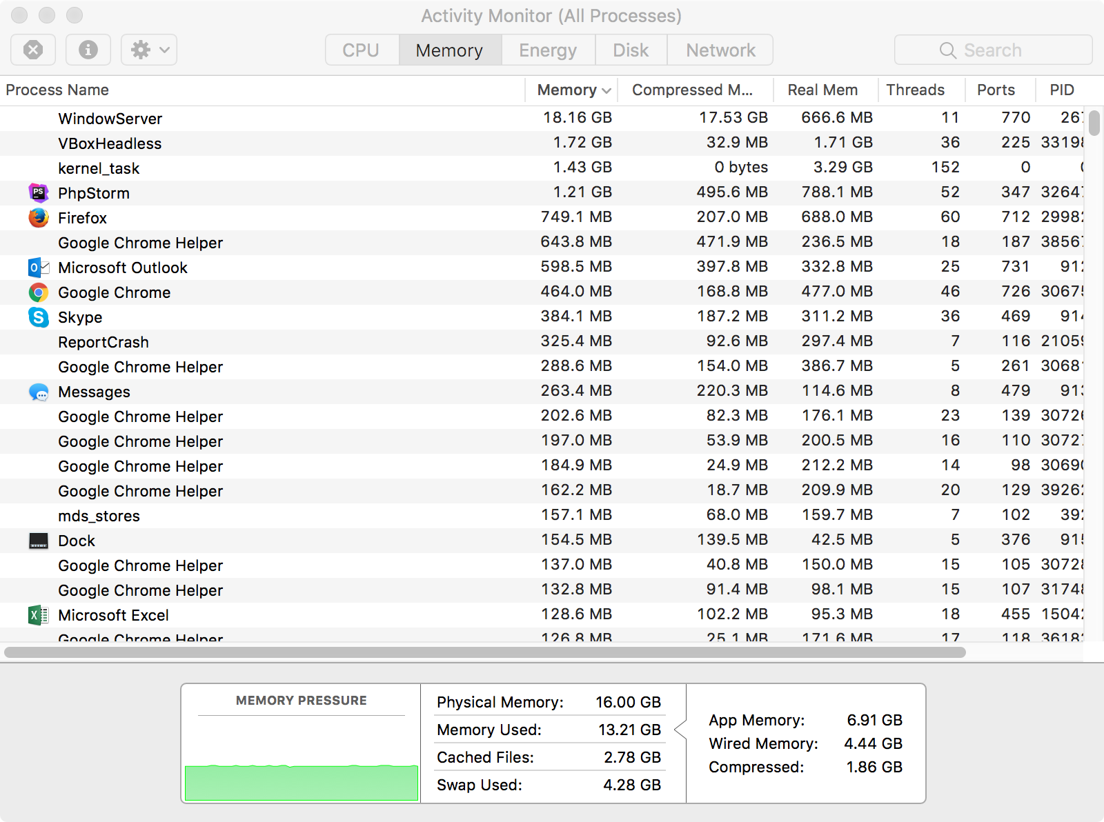

Since upgrading to High Sierra, I've noted WindowServer has become quite the RAM hog on my 15-inch, Mid-2014 rMBP.
Performance is currently okay, but I'm wondering how high this will go. It's also interesting that I am only using 13 GB RAM, but 4 specifically in Swap (give us 32GB machines already, Apple!). It's been running (with some migrations between home and work, where I have two DisplayPort monitors) for about 2 days, 10 hours according to 'uptime'.
Anyone experiencing the same?

I am. Currently at 16h of uptime since the last reboot and windowServer is at ~3GB, but I've seen it going way further up in the past few days. It goes up a bit every few moments and it pretty much never frees up any memory: the only way to revert it back to "normal" memory consumption is restarting the process, but it always starts to climb up again shortly after.
The machine is a 15-inch mid 2015 rMBP, no external monitor (I use a slightly bigger resolution than default, but I can reproduce the issue even with the regular one).

Please include the column 'real memory', and take memory column with a pinch of salt.
The column is certainly there, look at the screenshot. In my recent reboot, I'm now at 2 GB RealMem (as it hasn't had to compress it yet, it still shouldn't take this amount).

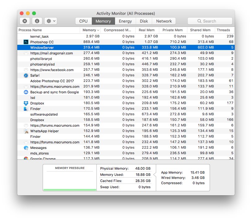

my WindowServer is stuck at 275 MB-- and I have two displays, one of them 5K, and 24 GB.
