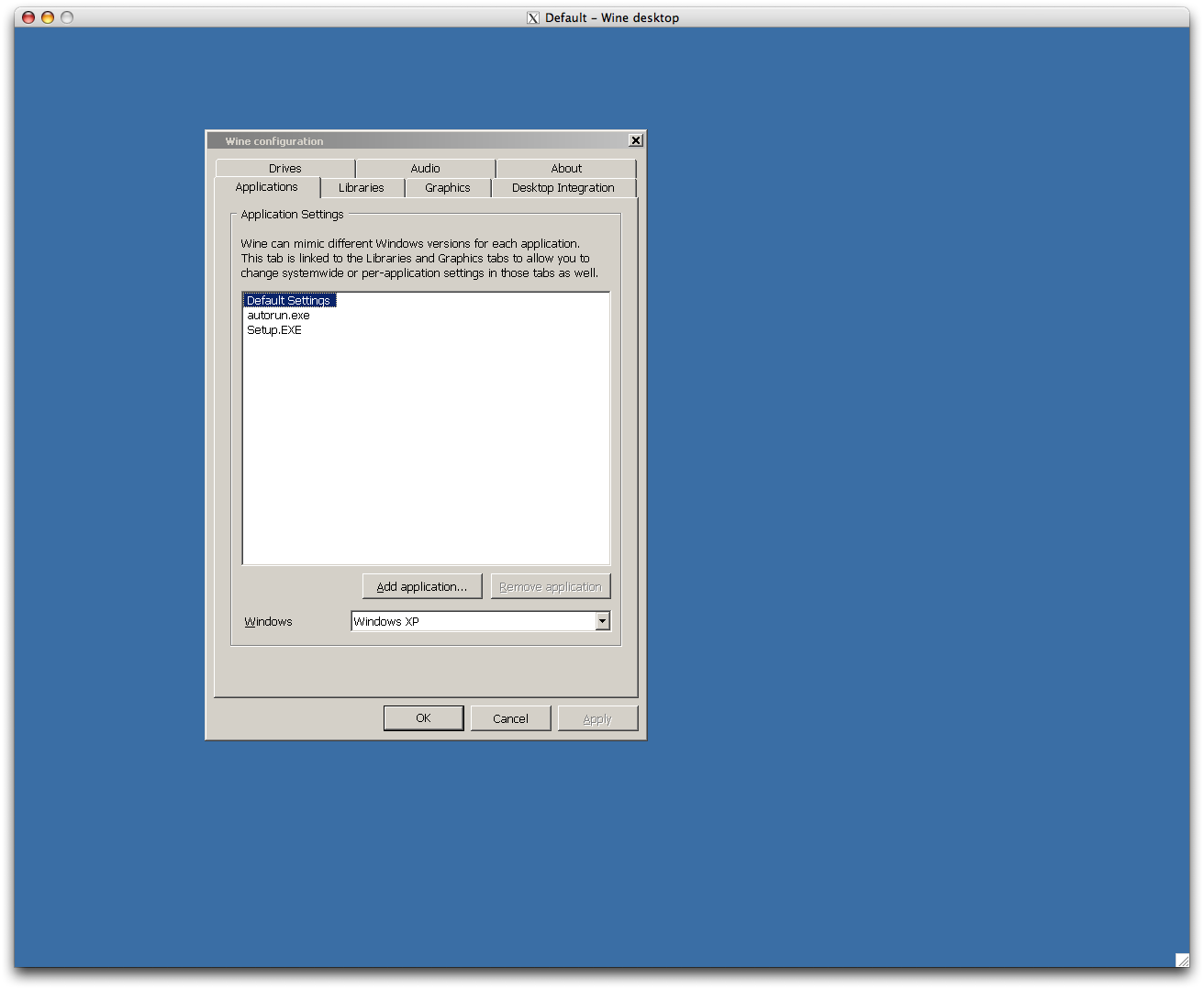

So being an enterprising individual, I got the Wine source code and the required libraries and compiled Wine in Leopard (10.5.8). It's up and running, and I can call up winecfg in Terminal, and it displays properly in X11. Sound works and all that. I have a few old Windows apps I wouldn't mind using again that aren't worth the trouble of buying another Windows license and all that, so I figured I'd give it whirl. A couple of those are old games. [edit] I'd run them on my XP machine if SP 3 hadn't broken them. 🙁
However, I can't figure out how to actually install anything to Wine's fake drive C. Has anyone else fiddled round with this, and know how to actually get things installed?

PS To install apps with WINE, use the following terminal command: wine <installer or EXE file>.
Correct me if I'm wrong, but in Linux for eg, you just need to type wine <path to installer.exe> and it will run the software's installation program.
Steerpikegg is onto it.
Your C: drive is located in the ~\.wine\drive_c directory. To install things you can either copy them in there manually, or if they have an installer like most do you run the installer with wine.
open a terminal and do;
wine <installer.exe name>
I'll try the Wine forums then. All I get from Terminal is:
Code:
$ wine setup.EXE
-bash: wine: command not found
Code:
$ wine setup.EXE
That indicates that the wine program isn't in the PATH. You'll need to add a line to your .profile, .bash_profile, or .bashrc files (create the one you're using if it doesn't exist) that looks something like this:
Code:
export PATH=$PATH;/path/to/wine/binary
Odds are it's in /usr/local/bin, unless you installed it somewhere else.
