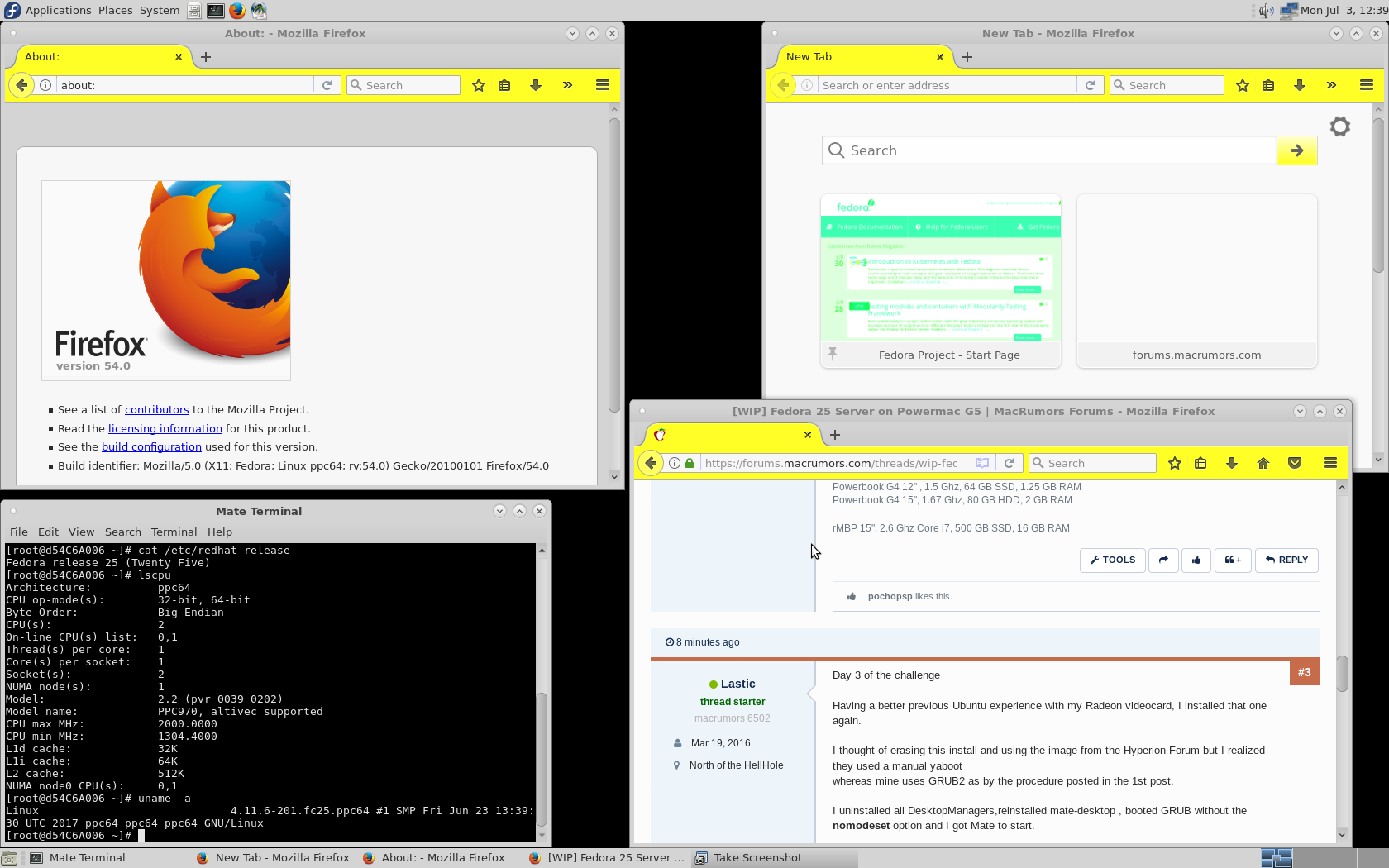

So my first day of the challenge has been a fruitfull one.
Inspired by this thread by the Amiga PPC guys
http://forum.hyperion-entertainment.biz/viewtopic.php?f=35&t=3524
, I decided to give this a try and succeeded after 9 hours of trial and error.
First I would like to state that I only installed Fedora 25 Server on my G5 and have no idea how to dual-boot.
Second I could not SSH into my system so I typed all instructions in manually whilst reading them from another screen.
Third this procedure is not for the faint-hearted , nothing will explode but you have to dedicate some time to complete it.
This is the procedure that I followed :
http://linuxhacker.ru/d/?q=node/360
Some things upfront which I had to do differently.
So I chose my language, selected Automatic partition, waited for the mirror to be found and then clicked on Begin installation .
You will be at a screen where you can set the root password , don't, just wait for the yaboot error .
Press Ctrl+Alt+Fn+F2 and go to a shell.
Now follow the procedure , here is my version :
mkdir /etc/yum.repos.d
cat <<EOF >/etc/yum.repos.d/fedora.repo
[fedora]
name=Fedora 25 - ppc64
failovermethod=priority
baseurl=http://ftp.nluug.nl/os/Linux/distr/fedora-secondary/releases/25/Server/ppc64/os/
enabled=1
#metadata_expire=7d
gpgcheck=1
gpgkey=file:///etc/pki/rpm-gpg/RPM-GPG-KEY-fedora-25-ppc64
skip_if_unavailable=False
EOF
dnf --releasever=25 --nogpgcheck --installroot /mnt/sysimage/ groupinstall -y 'Fedora Server Edition'
chroot /mnt/sysimage
dnf clean all
dnf install -y kernel grub2 hfsutils lvm2
cat > /etc/default/grub <<EOF
GRUB_TIMEOUT=5
GRUB_DISTRIBUTOR="$(sed 's, release .*$,,g' /etc/system-release)"
GRUB_DEFAULT=saved
GRUB_DISABLE_SUBMENU=true
GRUB_TERMINAL_OUTPUT="console"
GRUB_CMDLINE_LINUX="rd.lvm.lv=powermac_ssd/swap rd.lvm.lv=powermac_ssd/root $([ -x /usr/sbin/rhcrashkernel-param ] && /usr/sbin/rhcrashkernel-param || 🙂 nomodeset"
The smiley has to be a colon and a round bracket off course
nomodeset doesn't work with my Radeon videocard
GRUB_DISABLE_RECOVERY="true"
EOF
grub2-mkconfig >/etc/grub2.cfg
cat >/tmp/grub_modules <<EOF
moddep.lst bitmap.mod datehook.mod gzio.mod lsmmap.mod all_video.mod reboot.mod terminal.mod bitmap_scale.mod datetime.mod halt.mod memdisk.mod regexp.mod test.mod blocklist.mod echo.mod help.mod memrw.mod relocator.mod trig.mod boot.mod elf.mod hexdump.mod minicmd.mod scsi.mod true.mod bufio.mod ext2.mod hfs.mod msdospart.mod search.mod video.mod cat.mod fat.mod hfsplus.mod normal.mod search_fs_file.mod video_fb.mod cmp.mod font.mod ieee1275_fb.mod part_apple.mod search_fs_uuid.mod videoinfo.mod configfile.mod fshelp.mod linux.mod part_msdos.mod search_label.mod cpio.mod gettext.mod loadenv.mod parttool.mod setjmp.mod crypto.mod gfxmenu.mod loopback.mod probe.mod sleep.mod date.mod gfxterm.mod ls.mod read.mod suspend.mod kernel.img
EOF
mkdir /tmp/grub-modules
cd /tmp/grub-modules
for i in `cat /tmp/grub_modules` ; do cp /usr/lib/grub/powerpc-ieee1275/$i . ; done
I did blkid /dev/sda3 to get the UUID needed hereunder
cat > ../grub.cfg <<EOF
search --no-floppy --fs-uuid --set=root a732e5bd-e4a8-4ffb-a0fe-f49fca582cc4
set prefix=($root)/grub2
configfile /grub2/grub.cfg
EOF
grub2-mkimage -c ../grub.cfg -p /grub2 -O powerpc-ieee1275 -o ../grub.img *.mod
Set your root password using passwd
# Fan control fixup
cat >/etc/modprobe.d/windfarm_powermac.conf <<EOF
# For Powermac11,2 but likely for any kind of windfarm modules
install windfarm_pm112 /sbin/modprobe i2c_powermac ; /sbin/modprobe --ignore-install windfarm_pm112
dnf update
Then reboot into Open Firmware using Cmd+Option+O+F
I followed these instructions
https://github.com/masterzorag/G5_ppc64-linux
but I had to do boot hd:,grub.img
Now GRUB2 will start and then your Fedora 25 Server will start and you have a console.
For some reason , the Server version needs IPv6, I tried to disable it but haven't succeeded yet thus so far it's Ethernet cable is plugged in directly to my ISP modem since they provide IPv6 addresses already.
Otherwise it will stay stuck during boot at IPv6 ADDRESREQUEST
dnf grouplist will show you all DesktopManagers that you can install , I installed Mate via
(dnf groupinstall "MATE Desktop")
{3-JUL-2017}
what worked for me is dnf group install mate-desktop
then echo "exec /usr/bin/mate-session" >>~./xinitrc
First time you can start it with startx after a reboot lightdm will start automatically.
