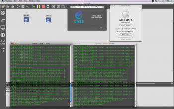

As I like to mimic my x86 setups on PowerPC , I made it my Sunday challenge.
Since the G5 is faster and has more RAM to run virtual machines, I wiped my Fedora 25 install and
reinstalled OS X 10.5.8 from scratch.
WARNING , this install is not for the faint of heart, it took me 8 hours with trial and error to
get a working setup. Might go a bit faster now because the order of the steps is now clear to me.

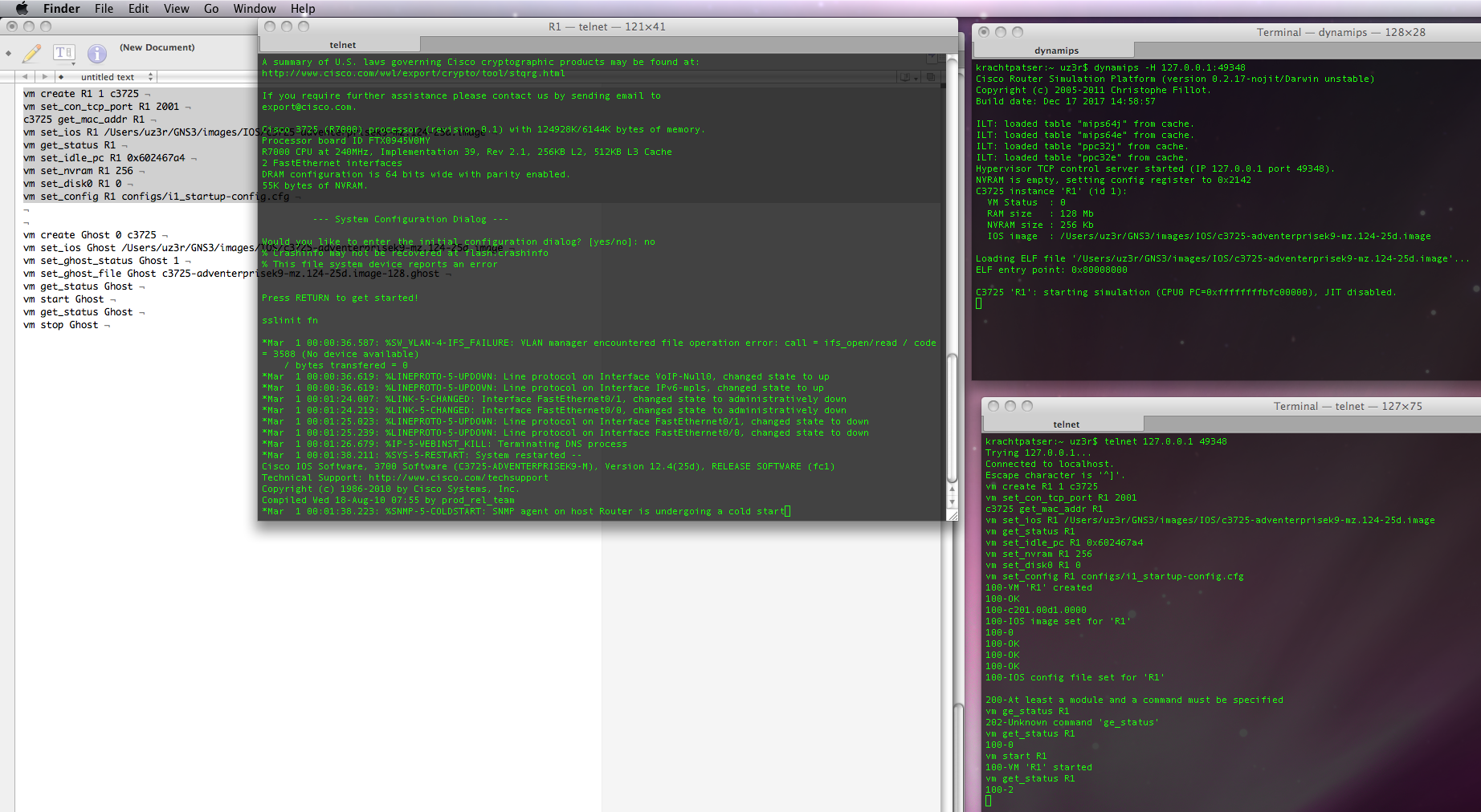

{EDIT 26-AUG-2017}
I edited the Python module for the Dynamips Hypervisor in GNS3 so it works now.
https://www.dropbox.com/s/p4uamient55x9q6/dynamips_hypervisor.py?dl=0
You will then need to copy this file from your Downloads folder to the above folder
sudo cp ~/Downloads/dynamips_hypervisor.py /opt/local/Library/Frameworks/Python.framework/Versions/3.6/lib/python3.6/site-packages/gns3server/modules/dynamips/.

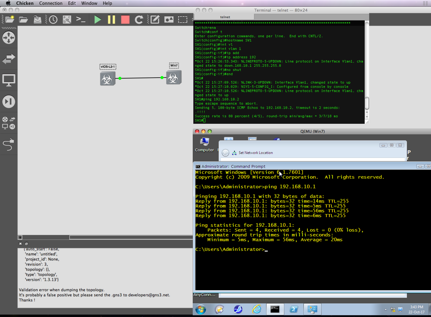

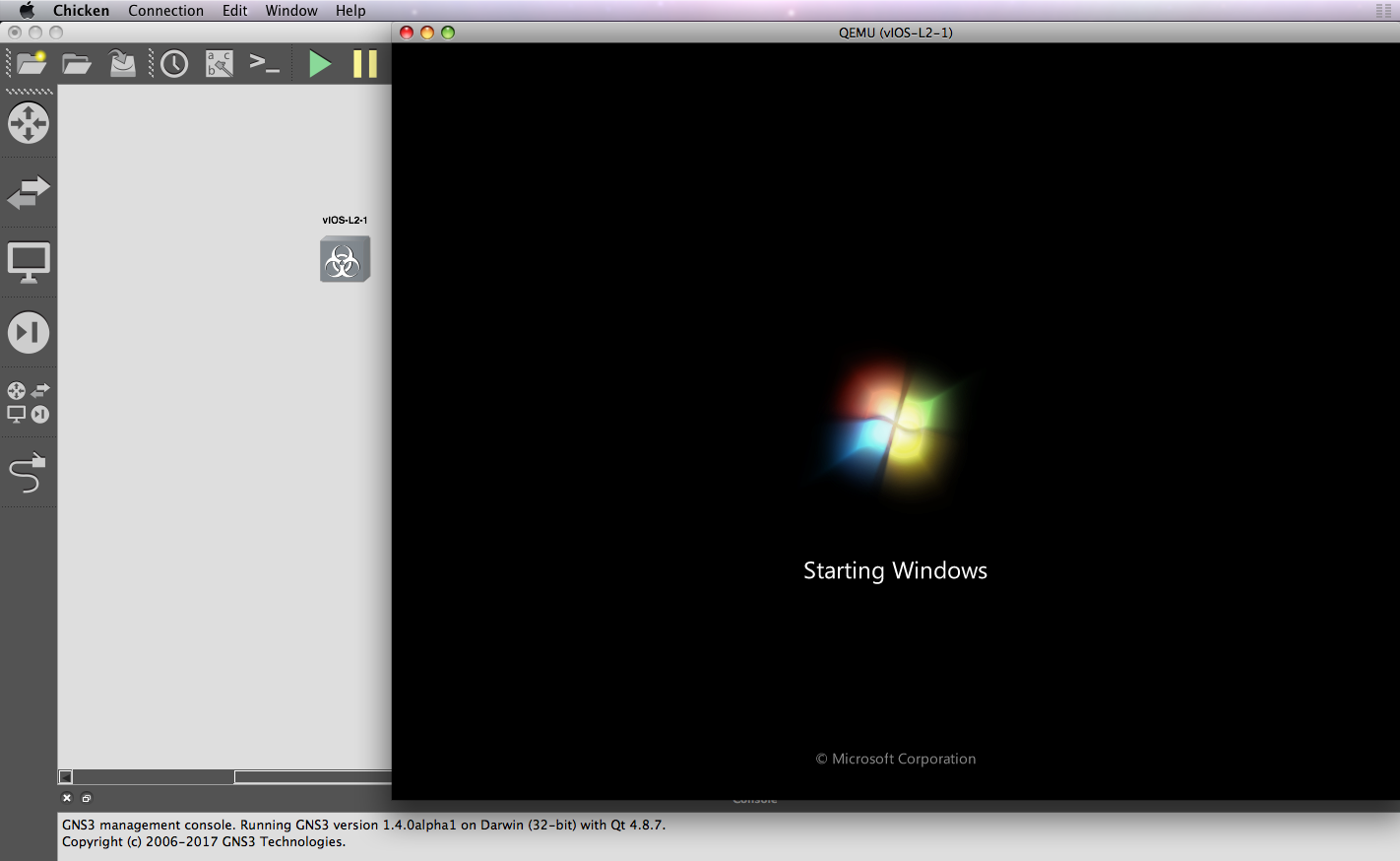

{EDIT 28-AUG-2017 Patched gns3-server Python module qemu_vm.py for working links}
https://www.dropbox.com/s/yervi22svvrkhgu/qemu_vm.py?dl=0
sudo cp ~/Downloads/qemu_vm.py /opt/local/Library/Frameworks/Python.framework/Versions/3.6/lib/python3.6/site-packages/gns3server/modules/qemu/
cd /opt/local/Library/Frameworks/Python.framework/Versions/3.6/bin/
./gns3
YEEEAAAAAHHHH, it works with links and working telnet console between Qemu nodes now

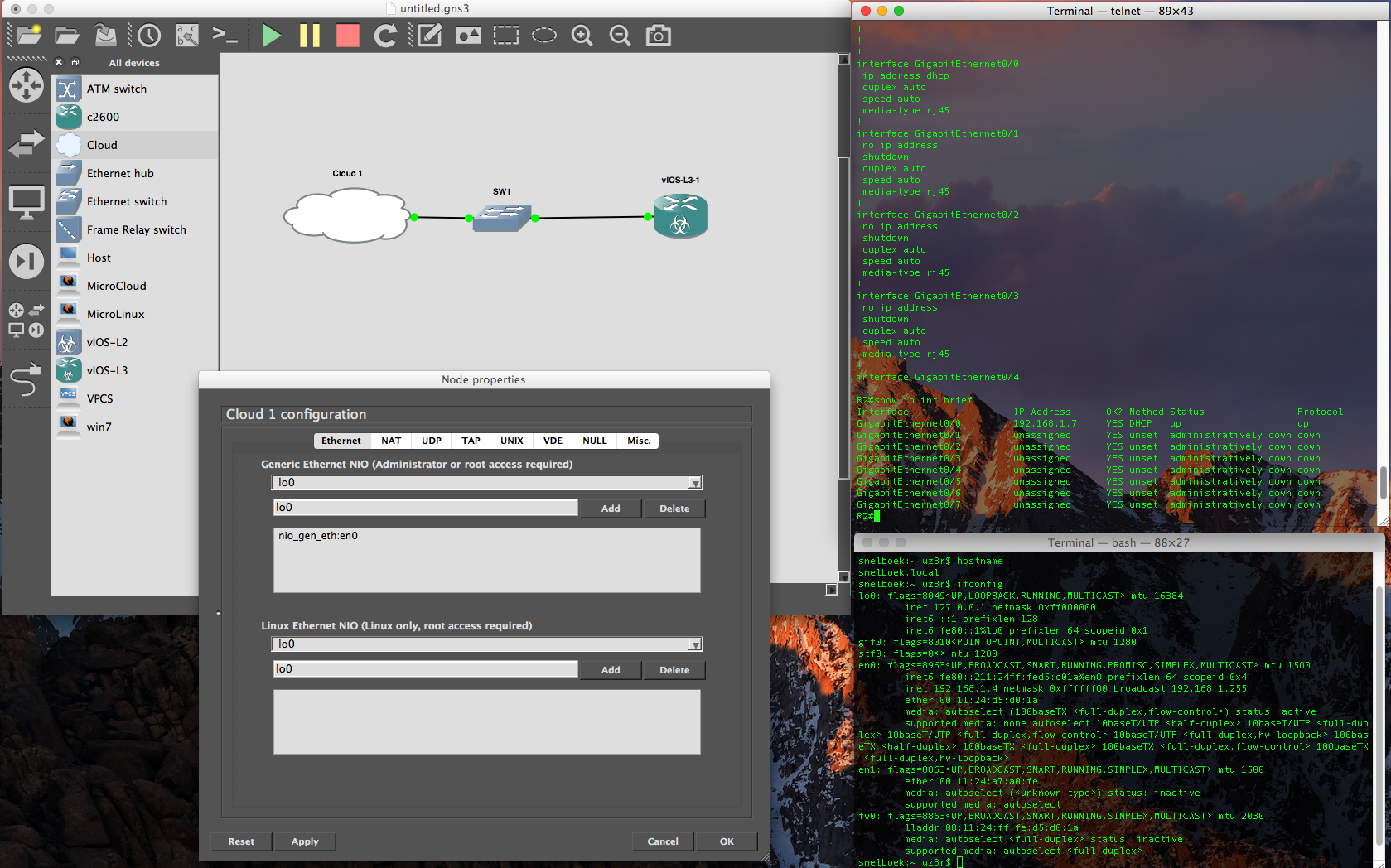

  • getting Cloud (internet) access to work done but only Generic Ethernet Adapter

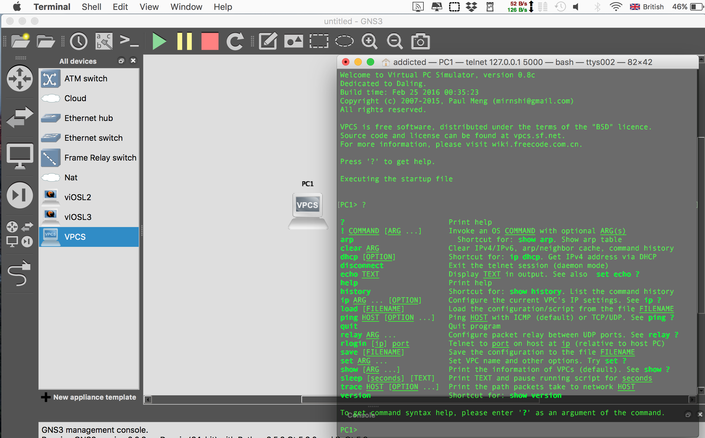

  • vpcs there is no source that can be compiled for ppc
    {24-DEC-2017} got it working , see last post

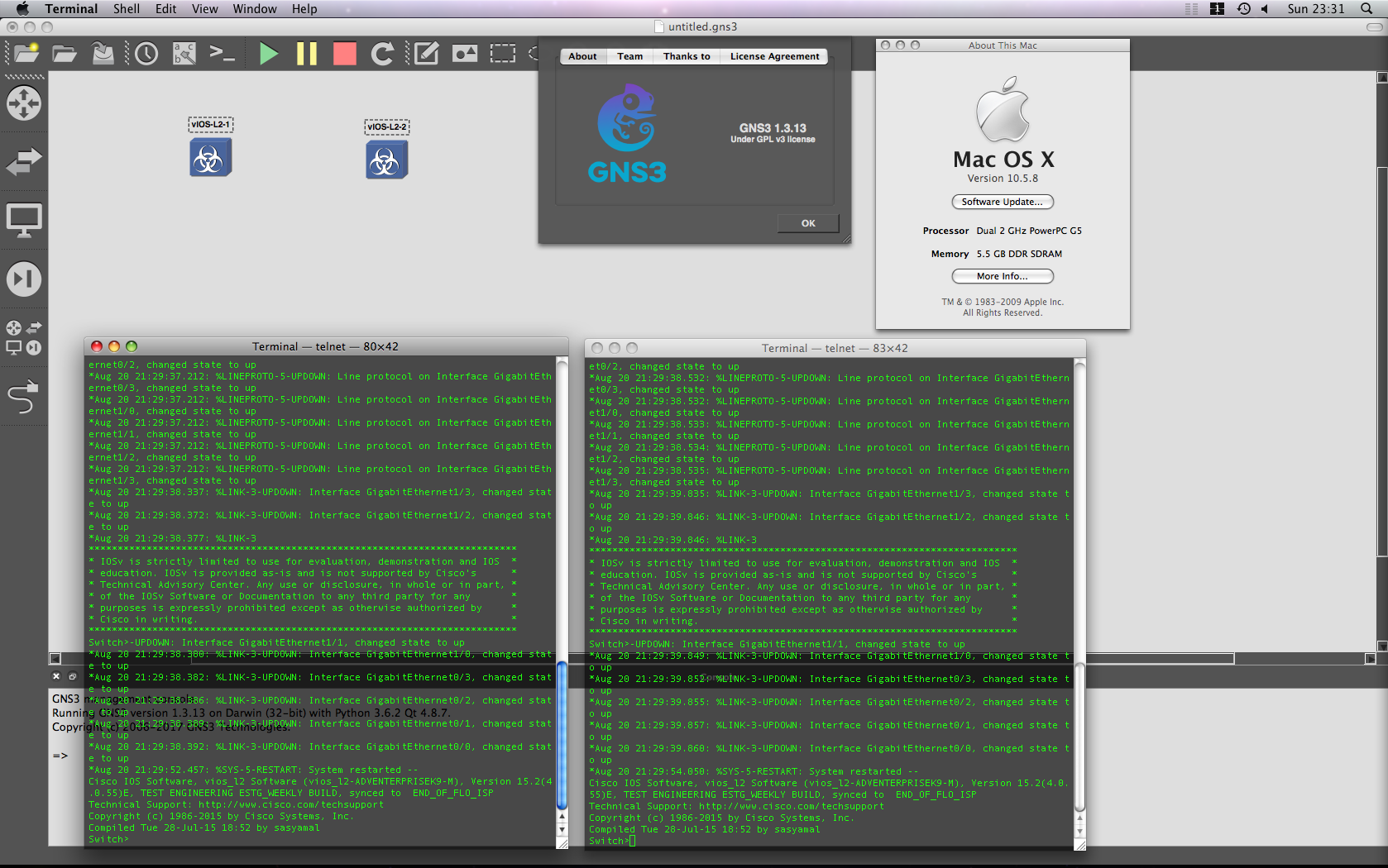

  • Dynamips router images crash but they do also on my x86 GNS3 2.0.3 install
    {02-APR-2019 GNS3 ,Preferences, Dynamips, Advanced, Disable Ghost Support }
What won't work
  • IOL since those are Linux x86 binaries
  • VMware/VirtualBox since those are x86 hypervisors

So I continued to debug dynamips since this causes 3 issues with my install
  1. it doesn't start appliances because of an unsupported 'hypervisor uuid' command no longer working as of dynamips 0.2.13
  2. creating links between nodes doesn't work
  3. when a Qemu node has been connected to another node via a link , the console to the Qemu node will no longer work (it uses the wrong console port to telnet to)
Thus I debugged Dynamips using following info.
Start gns3 with --debug to see the messages when it performs actions
./gns3 --debug
Second place to look for debugging info :
Under your projects folder (which you can define in GNS3 Preferences) which in my case is located at
cd /Users/uz3r/GNS3/projects/untitled/project-files/dynamips
There you will find a logfile called dynamips_ix_log.txt ( x being a number)
( just look for the most recent one using ls -ltrh )
cat dynamips_i1_log.txt
This will show all the commands sent by GNS3 to the running dynamips hypervisor process .
Here I found the error message that exec_cmd : hypervisor uuid was not working.
As such I tried to compile dynamips 0.2.12 but I can't get it to build (make fails) then I started looking and found the reverse solution being adapt the older (1.3.13) GNS3 Dynamips Python module so it no longer sends this non-working UUID command to dynamips 0.2.17
https://github.com/GNS3/gns3-server/commit/93e2d4096d85453e0c8d8afcd8b8d1a906ad21cc?diff=split
cd /opt/local/Library/Frameworks/Python.framework/Versions/3.6/lib/python3.6/site-packages/gns3server/modules/dynamips
sudo nano dynamips_hypervisor.py (or another Texteditor)
I will attach the file to my 1st post which you then need to copy from your Downloads folder to the above folder
Hooray , dynamips nodes now start and linking between nodes seems to work but Qemu doesn't seem to give me a telnet console to a Qemu node once I've linked it to another node

So today I decided to install GNS3 1.3.13 on my PB 1,5 Ghz G4 (PATA SSD).
The entire procedure took me about 3 hours on charger and luckily I found some mistakes in my first post which I have corrected now.
Xcode (was already installed)
Macports 2.3.4 (was already installed)
sudo port install git (was already installed)
qemu 2.2.0 was already installed as well as qt4-mac for another previous project.
==INSTALL PYTHON 3.6 + QT 4========================================
sudo port install python36
Need to update Macports to be able to install pip 3.6
sudo port selfupdate
sudo port install py36-pip
sudo port install qt4-mac (was already installed )
sudo port install py36-pyqt4
Didn't fail on my G4
==INSTALL GNS3-GUI QT 4 =========================================
gns3 2.0.3 => Qt5 no PowerPC Support
sudo pip install gns3-gui==1.3.13
Installing collected packages: idna, asn1crypto, cryptography, pyasn1, bcrypt, paramiko, configobj, gns3-converter, gns3-gui
Running setup.py install for cryptography ... error
cc1: error: -Werror=sign-conversion: No option -Wsign-conversion
Download cryptography from here
https://pypi.python.org/packages/9c...3.tar.gz#md5=24cbdab3fda22be31dd3aef2808f5d2f
cd ~/Downloads/cryptography-2.0.3
sudo python setup.py install
Continue with the install of gns3-gui now the dependency has been installed.
==CONTINUE GNS3-SERVER INSTALL====================================
sudo pip install gns3-server==1.3.13
===gns3-server needs lower aiohttp version===============================
sudo pip3 install aiohttp==1.1.6
==Dynamips install===============================================
sudo port install dynamips => 0.2.7 is too old but will install the necessary dependencies
sudo port uninstall dynamips => the dependencies will remain and now we can install 0.2.17 from source
https://github.com/GNS3/dynamips/archive/v0.2.17.tar.gz
cd ~/Downloads
tar -xvzf dynamips-0.2.17.tar.gz
cd dynamips-0.2.17
mkdir build
cd build
cmake ..
sudo make install
Dynamips will still complain about the no longer used hypervisor uuid command so we need to correct
the GNS3 Dynamips Python module
Things I've learned from this install, typo's 🙂 , uuid is not needed, ubridge also not for the moment.
==startup GNS3=============================
./gns3
Error message No local server found
Go to Preferences, Server , Path , browse to
/opt/local/Library/Frameworks/Python.framework/Versions/3.6/bin/gns3server
Still need to get the links between nodes to work but now I can do it on my lap with the PB G4 🙂

And VNC Console is only available since GNS3 1.4 so I'm going to try to adapt the GNS3 1.3.13 python files so they also include this option based on the GNS3 1.4 source.
And for today's hacking session trying to get a VNC console next to the already working Telnet console.
I had already adapted so my GNS3 1.3.13 Python source files to include the VNC option from the sources of GNS3 1.4.1 that my entire Qemu settings and preferences were screwed up.
So I went the other route, pip uninstall gns3-gui==1.3.13 and pip uninstall gns3-server==1.3.13 and pip install gns3-gui and server==1.4.0a1
GNS3 1.4.0a1 already includes the VNC options , it does still complain that I don't have Qt5 but it starts.
Some first caveats :
  1. I can't add a new Qemu VM with vnc console, this is not due to vnc but due to 1.4.0a1 giving me a Python Qt error when trying to click OK or Apply after changing a setting in the preferences
  2. As such I had to adapt a working Qemu VM with telnet console by right-clicking on it on the Canvas , selecting configure and changing the console to VNC . Here I can click OK and the settings stick.
  3. Then I started my VM but saw the error message in the GNS3 console, qemu does not support VNC.
    Looked like I didn't compile my Macports qemu 2.2.0 version with the +vnc variant.
    Redid my install with sudo port install qemu +vnc
  4. Now qemu would start with the VNC option but it has it set to 0.0.0.0:0 (which should be 127.0.0.1) , the port is translated to 5900
    (looks like I need to do the same patch as with telnet console where the address is always 0.0.0.0 instead of 127.0.0.1)
  5. As such no luck with ScreenSharing since it refuses to connect to local host (127.0.01) , so installed Chicken of the VNC
  6. The Console option also uses the wrong 0.0.0.0 address so pasted manually in Terminal
    osascript -e 'tell application "Chicken"' -e 'open location "vnc://192.168.1.2:0"' -e 'end tell'
  7. Bumped up the RAM of the VM from 384 MB to 1024 MB since it is slow, need to expand my G5's RAM from 5,5GB to 8 GB
  8. QEMU is sloooooow even when running this stripped down Win7 version
Ah well, at least I can VNC console to it 🙂

So another rainy Sunday working on GNS3 1.4.0a1 and I found the solution to my issues.
With installing a newer version of GNS3 my patched files were gone as such I had to make the same changes again to
File qemu_vm.py
self._host = "0.0.0.0"
# server_config.get("host", "127.0.0.1")
File dynamips_hypervisor.py
#self._uuid = None
#self._uuid = yield from self.send("hypervisor uuid")
#@property
#def uuid(self):
# Returns this hypervisor UUID.
# :Returns: uuid string
# return self._uuid
And tadaah , telnet consoles work, vnc consoles work but off course with 384 MB assigned to the Qemu Win7 VM it's seriously slow, oh paycheck where are you so I can order my 16 GB of RAM 🙂

And another Sunday GNS3 troubleshooting and I found that I was doing it the wrong way to get Cloud (Internet access)
Since GNS3 1.4 there is a Cloud appliance which uses Dynamips to create NIO adapters but you need an Ethernet Switch in between the Cloud and your Network Device.
Apparantly on OS X only the Generic Ethernet Adapter seems to work for GNS3 1.4
So far I have only been able to set it up using the Ethernet Adaptor but I'm still trying with Wireless (Airport) also.
I've succesfully had a virtual Router have it's interface IP received via DHCP and could access it via Telnet from another device on the same network .
Also GNS3 on 2 different machines running seperate virtual routers with DHCP , connected to the same network and I can access each router from the other machine.
This ticks off the last checkbox of what I wanted to accomplish with this setup.
I can now even run heavier VM's via qemu on the G5 and acces them from GNS3 on the G4's or run real hardware connected to the same network and have bi-directional access in GNS3 on any PPC machine.
For some reason my GNS3 1.4 install doesn't work , Dynamips -e doesn't list any of my Ethernet adapters so I will re-install during the PPC Winter Challenge to finally have a clean writeup .
Merry Christmas everybody !

So I started up one of my PPC's and decided I really need VPCS to work.
I downloaded the last source-files which was version 0.8b , and decided to see how it compiled.
It uses a Makefile.osx (in /src) in which the CPU architecture was defined as i386 so I changed that to PPC
RM=rm -f
CC=gcc $(CCOPT)
OSTYPE=Darwin
CPUTYPE=i386
HVOPT=-DHV
I then ran the mk.sh script from within the /src directory, it would compile but fail at the end when compiling command.c
on the lines containing IN_LOOPBACK
I found this comment
https://github.com/GNS3/vpcs/commit/44a74cb1221bf5b0443c414469b450fe4149a1f1
and decided that these added parts could be removed for OSX thus I edited command.c to this version.
if (rip == -1 || gip == -1 || rip == gip ||
#ifdef Linux
((rip & 0x7f) == 0x7f) || rip == 0 || IN_MULTICAST(ntohl(rip))) {
#else
IN_LOOPBACK(ntohl(rip)) || IN_ZERONET(ntohl(rip)) || IN_MULTICAST(ntohl(rip))) {
#endif
printf("Invalid address\n");
return 0;
And so I compiled again (/src) ./mk.sh and it worked.
I did a sudo cp vpcs /usr/local/bin and the binary was working ... or not.
It wouldn't accept commands that were longer than 2 characters ?
Must be a flaw in the program itself as reported here :
https://github.com/GNS3/vpcs/issues/10
But wait vpcs 0.8b has been around since 1-NOV-2015 , surely the author has fixed this already by now ?
And yes , he did in the svn trunk , https://sourceforge.net/p/vpcs/code/HEAD/tree/trunk/
So start again but with the latest version from the svn trunk by using :
svn checkout https://svn.code.sf.net/p/vpcs/code/trunk vpcs-code
Under /src I changed the CPU type again in Makefile.osx and in command.c I removed the 4 lines again, then under /src ran ./mk.sh and again a compiled binary which I copied somewhere usefull sudo cp vpcs /usr/local/bin/
And now I have a virtual PC which only has network commands but doesn't use QEMU , is more lightweight and is a single process running.
Only thing I can't get to work yet is DHCP via the Cloud node in GNS3 but that's for today 🙂
Reactions: Traace and AphoticD
So it looks that I have a working Portfile for Dynamips which only worked for connecting nodes in GNS3 1.4 but not for what it is intended , simulate Cisco Hardware and run 'real' router images.
Making a bit of progress there also , now why does GNS3 create a Ghost which seems to crash everything ...
Reactions: Traace
Found the 'Ghost' , GNS3 ,Preferences, Dynamips, Advanced, Disable Ghost Support.
And as such another progress report, on my G5 Dynamips works, I can link 2 router instances to each other , assign IP's and ping each other.
However linking a router instance to the Cloud Appliance doesn't work, bizarre , might have to recheck my GNS3 1.4 install on the G5.
On my PB G4 however, it is slow, the cloud appliance seems to work and not work, starting a router image directly via Dynamips boots in
1-2 min , via GNS3 it takes almost 6 minutes.
But last year Dynamips didn't do anything, so there is progress.
And the past 10 hours have been spent on GNS3 , just one more dependency and everything can be build with Macports
Reactions: pochopsp
