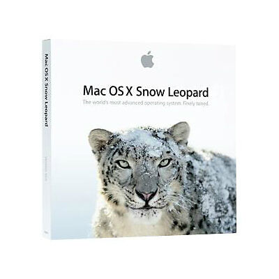

Go on ebay and look for a UNIVERSAL Snow Leopard install DVD.

Yes, that Snow Leopard installer would work for you. Keep in mind that the link that you posted does NOT get you a DVD. It will download an ISO (made from the actual DVD) that you would use to burn a DVD. Or, you can also use that ISO to make a USB installer, maybe on a thumb drive, or, as I have been doing, making a bootable partition for whatever OS X installer you want to use, on an external USB SSD.
Or, you can also find actual original DVD for Snow Leopard, if that's what you want.

If you have another Mac and a DVD burner... like DeltaMac says above... try downloading the ISO file first.
If that isn't working, then you could buy a Snow Leopard DVD online.
BUT -- it must be a "universal" installer.
I don't think you will find something called a "universal" installer for Snow Leopard.
But, get one that is actually the retail DVD. (The system-specific DVDs were never sold in a retail box)
That will be the "universal" installer that you want.
The link that I offered says that the DVD is a retail version, which is what you want to find.
