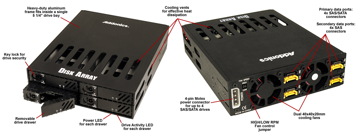

SSDs are particularly easy to fit in the ODD bay. Velcro really is sufficient but there are also manufactured systems that allow you to fit up to four units.
Some people have simply cut up an old CD drive and fixed their SSD to the 5,24" box.
We both mentioned this one. 😉 Cheapest method I know of, and particularly useful for 1 or 2 without making any real measurements. 🙂
BTW, how is the Addonics backplane unit on noise with those 40mm fans?
