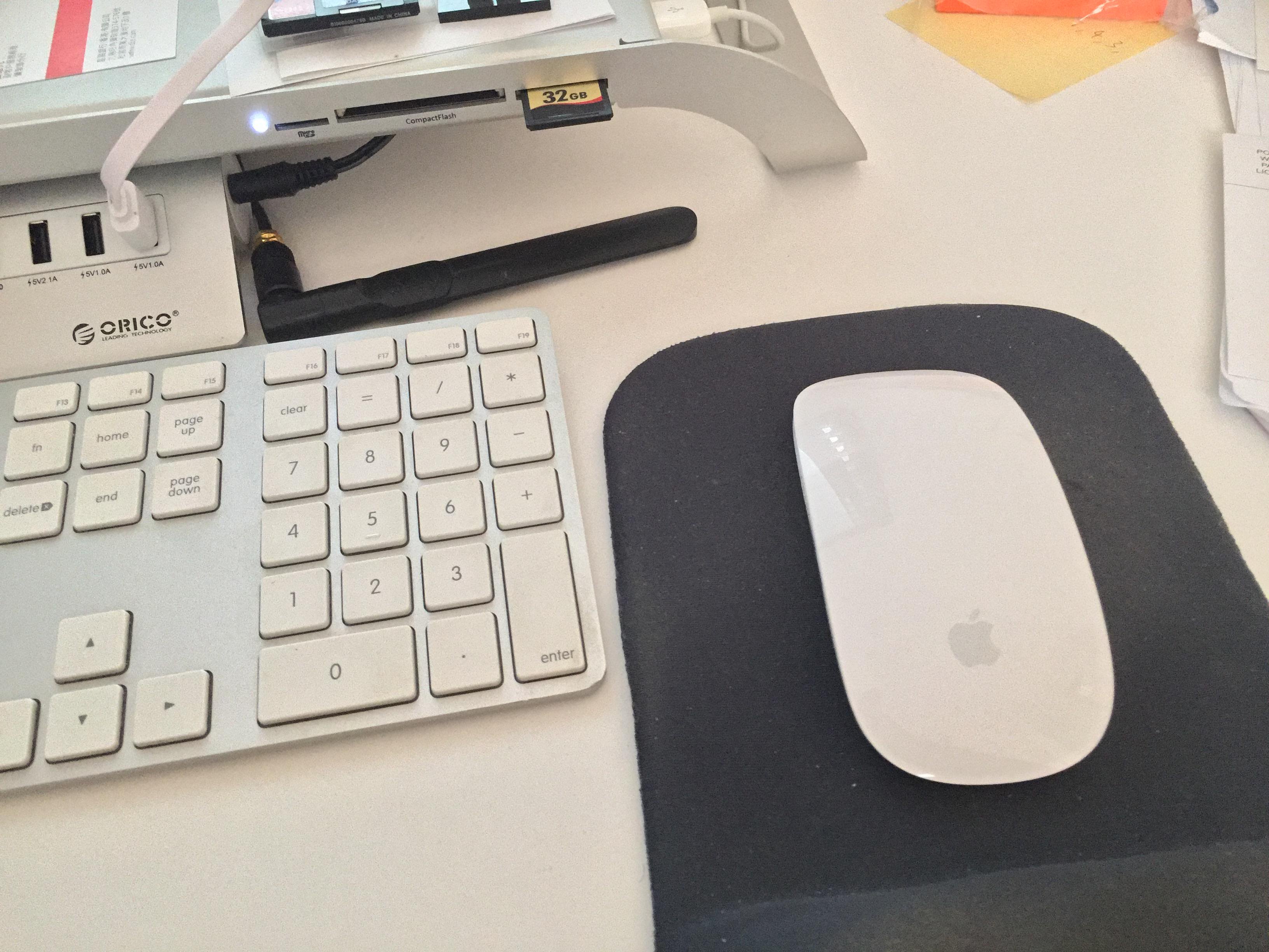

Anyway, I use Magic Mouse (1st gen) since it was released, I experienced some interference, and tried few different solutions.
1) stop using 2.4GHz Wifi, this is important. If it's a must, manually select the higher channel (e.g. channel 11 or 13 etc) avoid the small number channel.
2) If you are still using the stock BT card, then you can simply plug in a $5 USB dongle to replace it (need to activate via BT Explorer, which is a free software from Apple available in the developer page). Since the USB antenna now is "external", it should have better reception, or you can use a USB extension cable, etc to make the USB dongle closer to the mouse.
3) If you have an upgraded Wifi ac / BT 4.0 card, and you prefer to keep that "native" BT 4.0 for Handoff etc. You may use a IPX -> SMA extension cable, and attach a SMA antenna onto it. Then you can place the antenna anywhere you want. e.g. in my case, the black 10cm long antenna is just few inch away from the mouse. With this external antenna, my $20 BT headset can play music 20 feet away from the Mac without any issue. The mouse of course can work properly.
Last but not least, all my native USB 2.0 port is very reliable, never have any issue. Not sure if your issue is the USB ports problem, or the USB devices' issue, or software crash.
