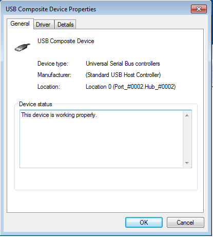

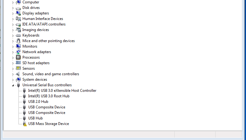

My device manager shows it as a USB composite device, and a USB2 Hub (both entries disapear if I unplug the keyboard).
I still tried the fix, forcing the port power to 500 etc, but it didnt actually work.
Also, the guide video shows that the Hub properties page should have mutliple tabs, including "Power" and "Advanced". Mine doesnt have these.
I can only assume the the apple drivers are not installing the keyboard correctly, or that I am missing a necessary USB driver somewhere.
