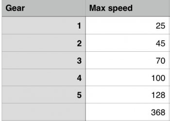

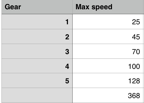

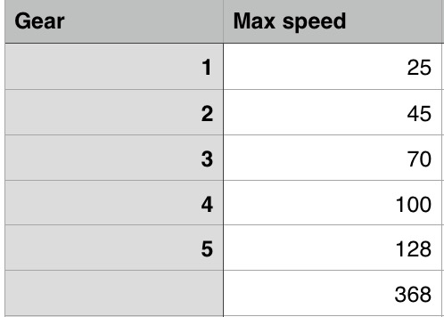

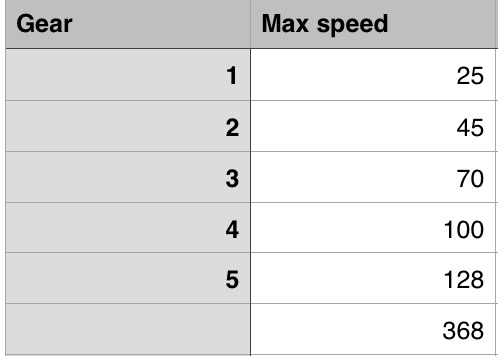

Saying that devices will connect to both bands for a combined speed is none sense.
This probably originated from reading a router ad wrong since now they advertise routers that can do "1750 Mbps" when in reality it is 450 Mbps on Wireless N (2.4 or 5 GHz) and 1300 Mbps on Wireless AC (5 GHz).
Imagine if other things were like that! (Sorry, car analogy in 3, 2, 1...) My car can go 368 miles per hour!
