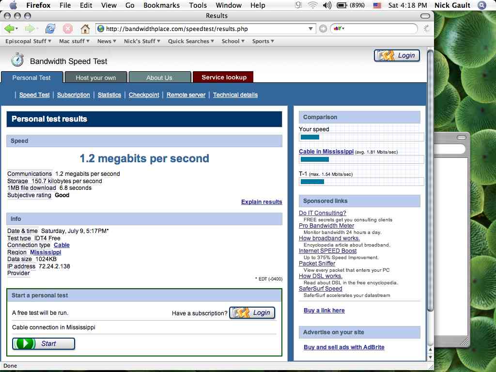

Hmm... I'm unimpressed with my speed, seems I'm only getting 2.1 mbps (out of 3)... But then again, I was using AirTunes, so whatever... Oh and I only pay $40 (without the promotion [$19 for first year]) a month for "3Mbps" DSL, I suggest shopping around.

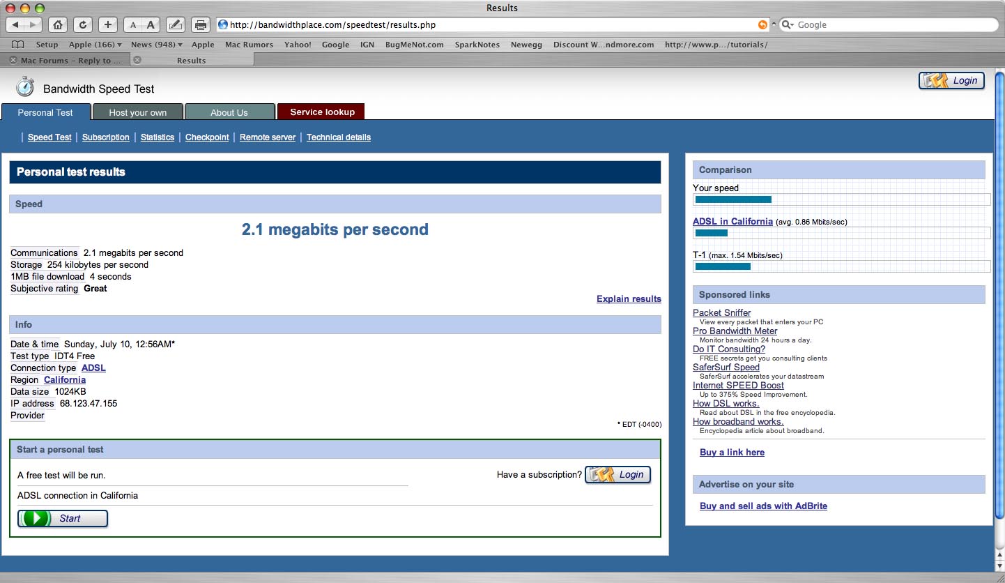

My AirPort widget (Air Traffic Control) is saying I'm getting about 19% reception which is pretty lame yet I still manage about 8Mbps so I really don't think reception has all that much to do with internet speed. 🙂
WOW! 😱 How much do you pay? I wish I had your speed...

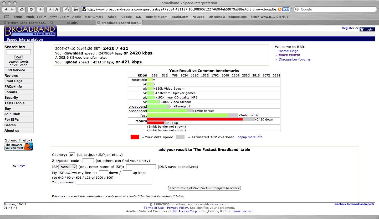

I just tried my speed on that site, I did better there, this time with Airtunes on...

It's about AU$50 per month which is about US$35. It's called ADSL2+ and it's rated at 24Mbps but it doesn't really get close all that often. 🙁
It averages about 2MBps whatever that is in Mbps.
