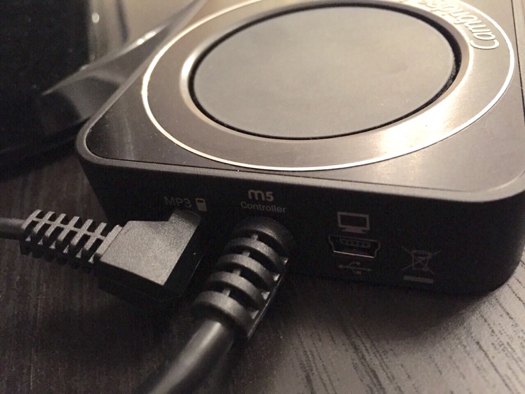

Sorry, I'm massively out of touch with audio. I've attached a photo of the thing I've called the 'Controller'. It handles volume of the speakers, provides inputs and is the on/off switch too.

Actaully, your only option is the Airport Express because it has a 3.5mm analog audio output jack.
Apple TV will not work for you because it has an HDMI and optical output only. There is a micro USB, but it is reserved for service and diagnostics. You could add a digital converter to the USB, but that would add more complexity and expense.
Another option, for not much more than the Apple Airport Express is an Airplay speaker. The act as the Airplay 'receiver' like the Airport and they usually have an audio input jack or even a dock for an iPhone etc. Many of them likely have better sound quality that what you have now.
