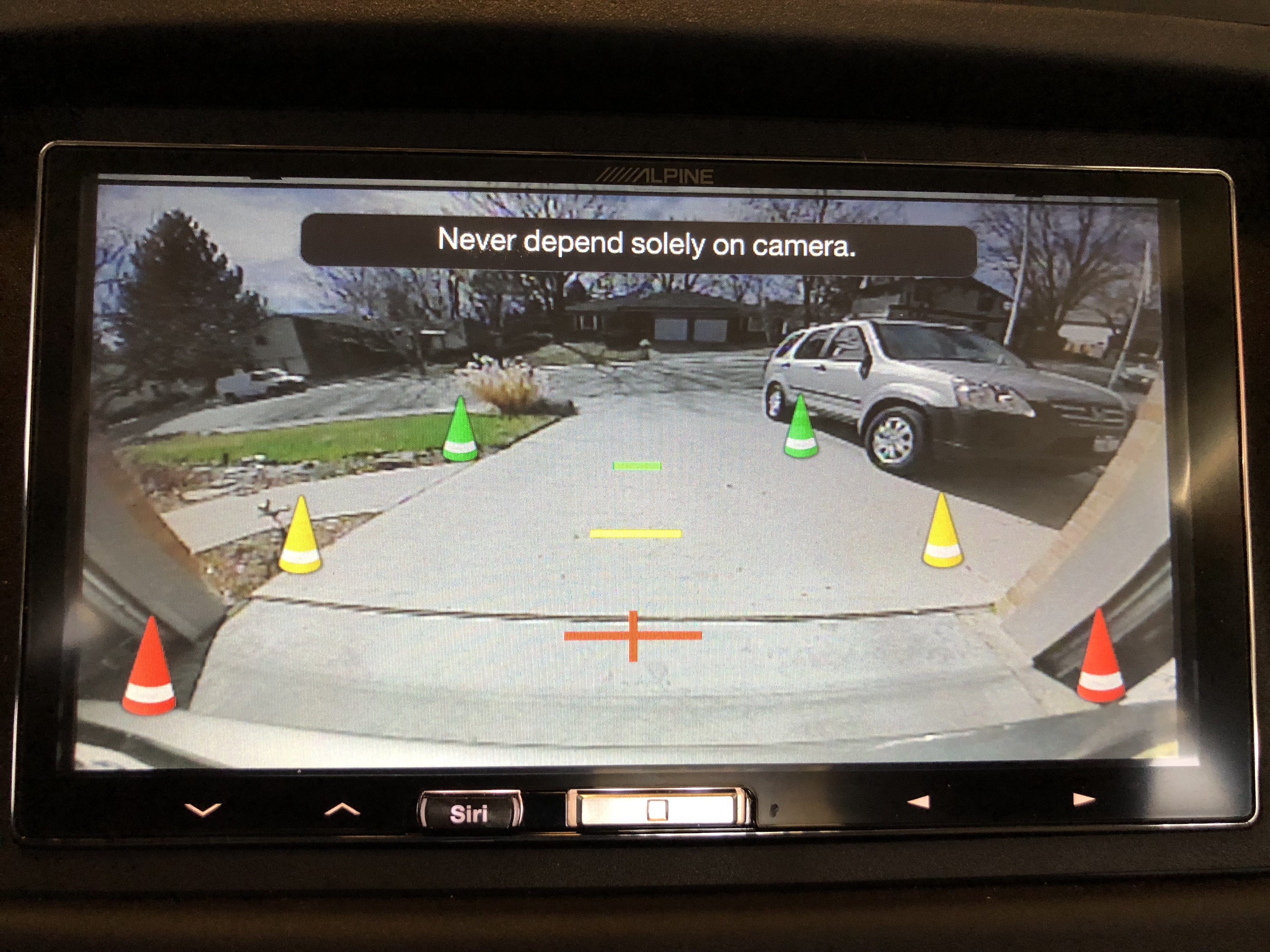

The rear view camera looks super clear and sharp. Are you going to adjust the guidelines? For mine I took the car to a parking lot with double spaces which have perpendicular lines. Squared up the car and lined up the bumper with the dividing line. Set up some water bottles at 18", 3', and 6' intervals. I adjusted the camera down so I could see edge of the bumper and then moved the guidelines as close to the marks as possible. The Alpine controls are a bit clunky, but I got them to work well enough to get the cones aligned fairly well.
Your's looks like it has both the cones from the radio and brackets from the camera turned on. Here's how mine looks with just the radio's guides.
dang
I like your cones better than mine.

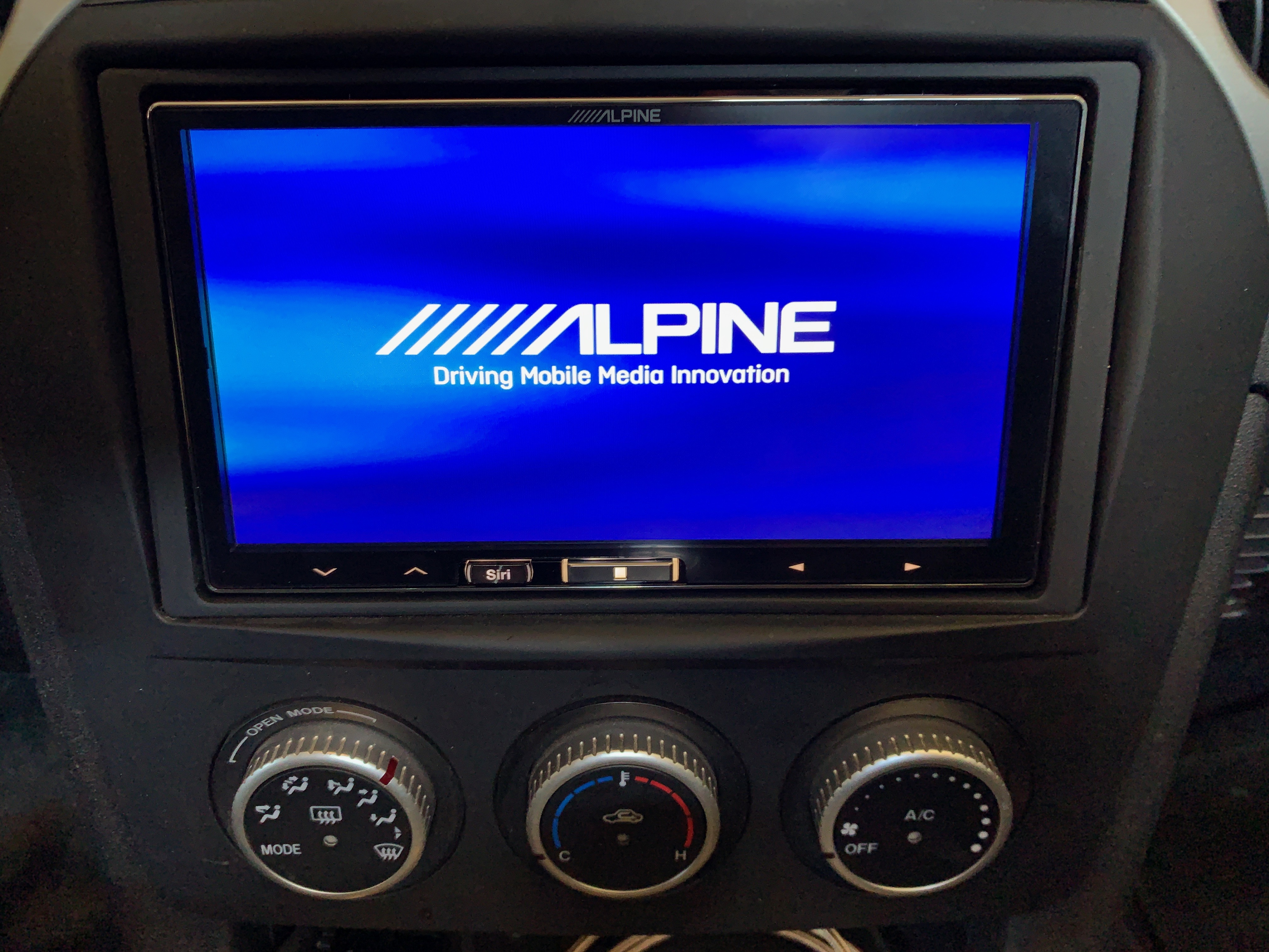

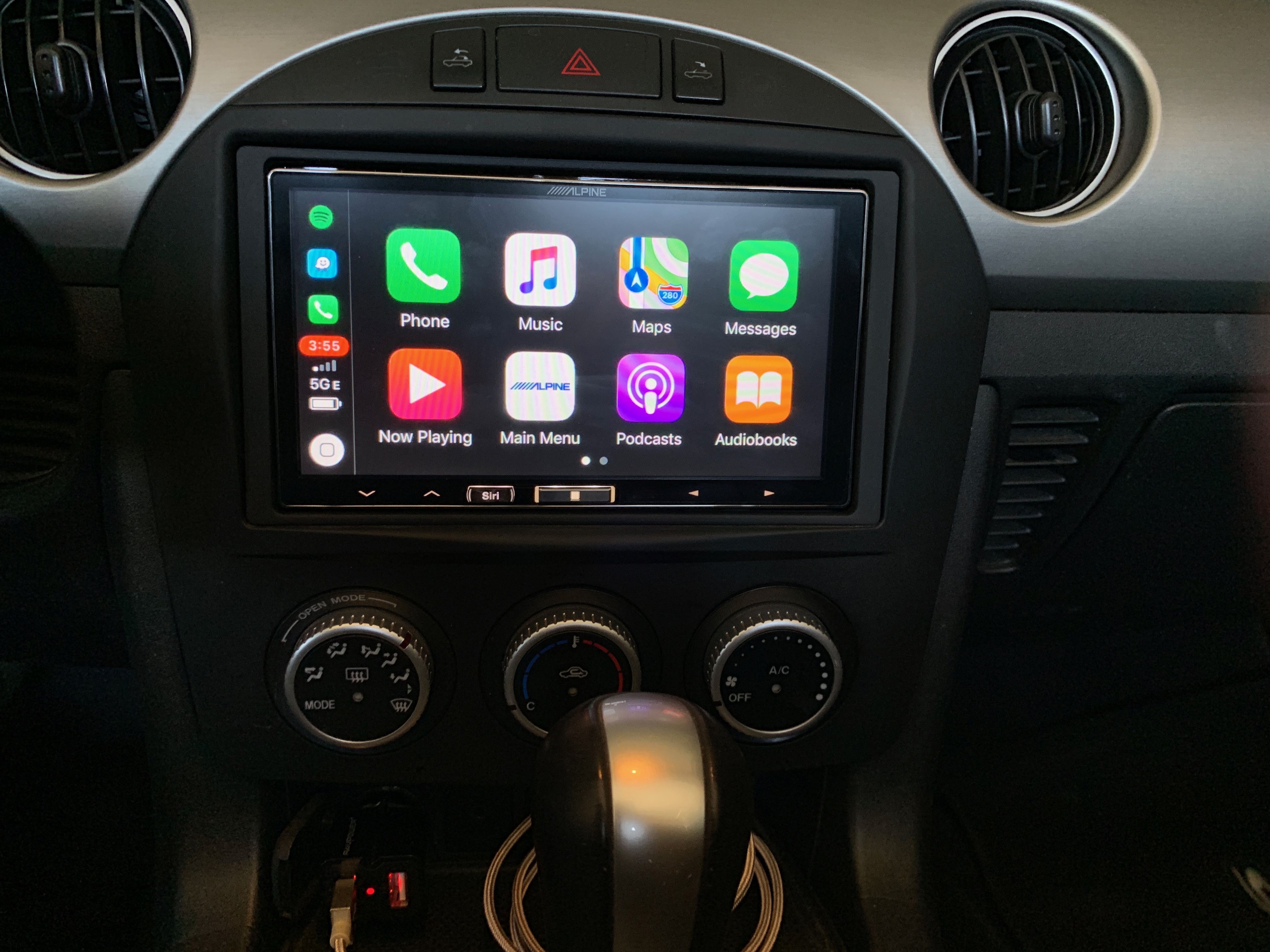

Just had my Alpine ILX-107 installed today...still trying to figure out everything, but I think this is going to be a pretty amazing experience.
Reactions: ColoArtist
You're going to love it, especially wireless CarPlay.
Loving it. Start my car, the radio finds my iPhone and launches CarPlay... it's so great to be able to use Waze, Apple Maps, Google Maps, Spotify, IheartRadio... I have a Pitaka MagMount Qi career mounted to the dash ... so I can charge my phone wirelessly and use CarPlay wirelessly... life is pretty good! 😀

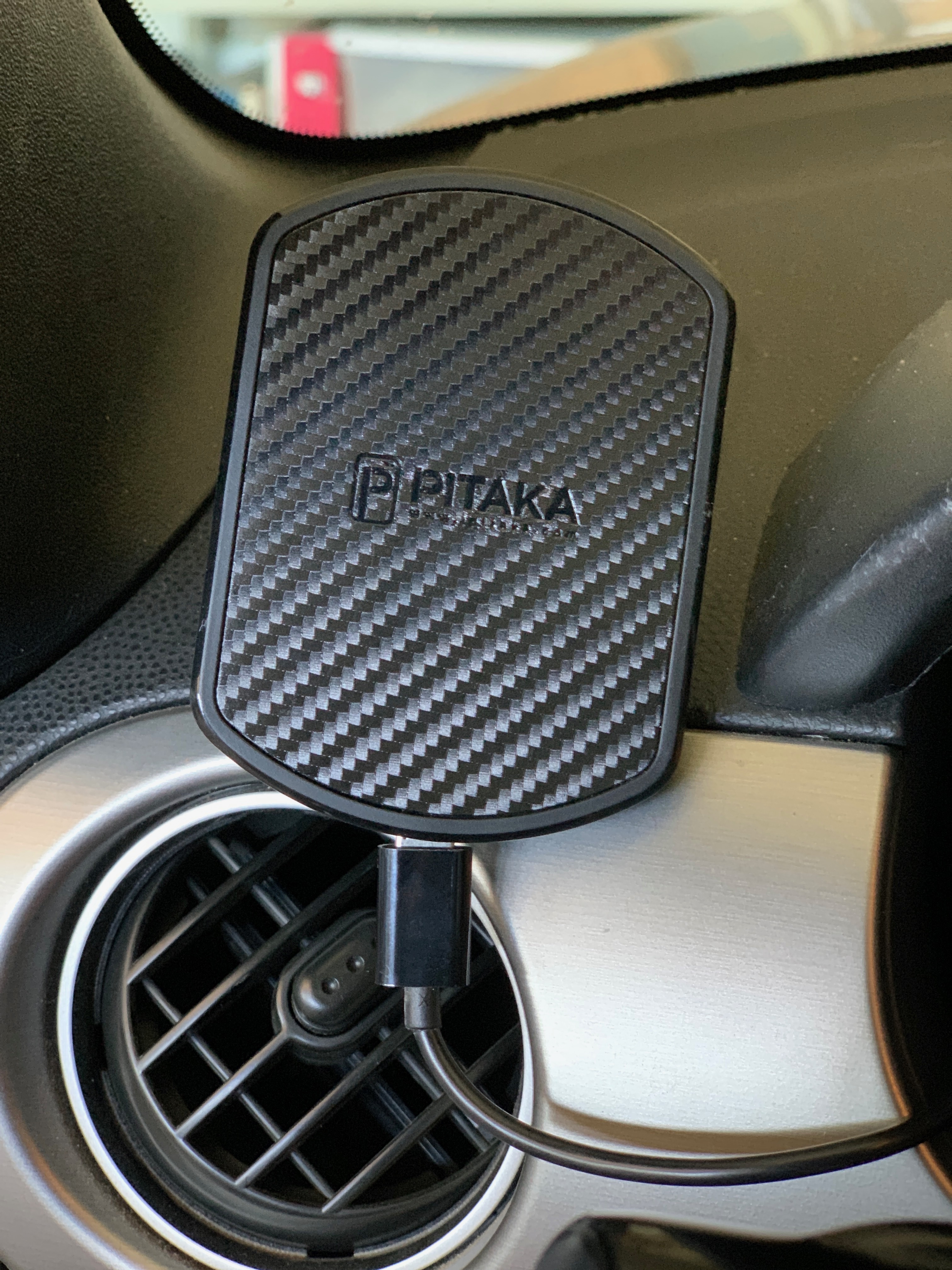

Never even thought of car wireless charger!!! Just got an aftermarket unit, so I'll look into finding a wireless charger. Does the model you have require any specific charging accessories? I use an Apple silicone case (and a Belkin wireless charger at home), so looking for something that doesn't require anything extra.
Unfortunately wireless charging feels noticeably slower than wired charging and my commutes and drives throughout the day aren't very long, so I need all the juice I can get, in a short period of time. So I'll be plugging in, regardless.
Just had my Pioneer Wireless aftermarket installed & CarPlay is so cool! This is my first experience with it, so I'm sure I'll be adapting (and IOS13 will be released in about a month or so, so it won't be a drastic change since I'm just getting used to everything, lol)
I also picked up a Belkin wireless car charger, so I'll see how that works (worst case, I can still do wired CarPlay).Hopefully the wireless charge works well enough for now.
