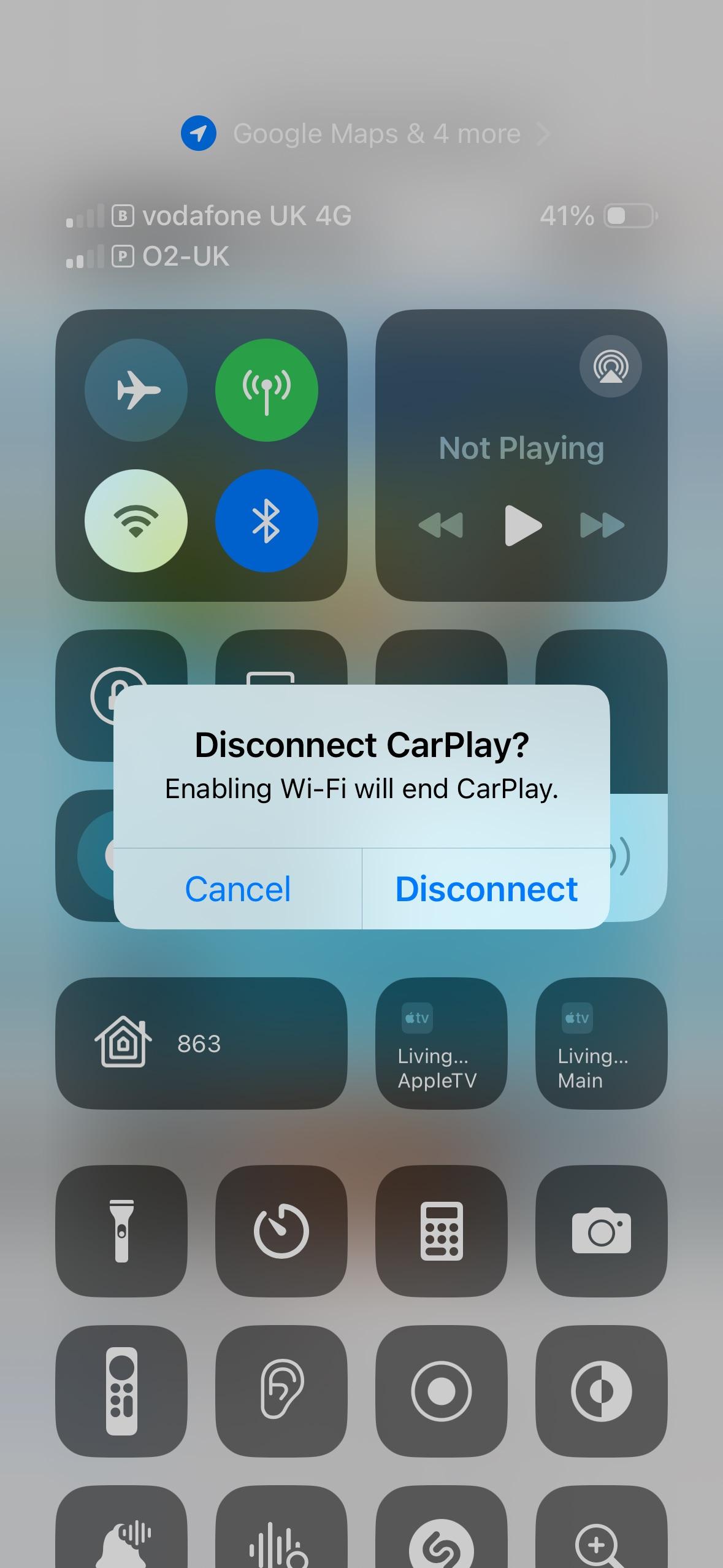

This bug has been present for me in the last few seeds. When using wireless CarPlay with an Ottocast U2 Air after leaving the car the iphone is retaining a connection to the wireless connection. Even though the unit is powered down.
To get the hone to reconnect to any WiFi (including getting back into the car for CarPlay) I have to toggle the WiFi to force it to disconnect from the retained connection.
Anyone else having this issue and if so have you got a fix?
