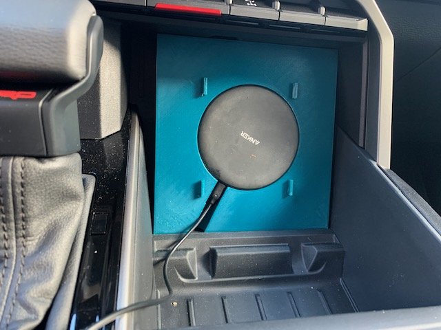

Here is my current setup:
tundraqi-jpg.840069
Did a little better today, 2 hour drive running Carplay with google maps, but no music streaming, and the phone charged from 58% to 80%.
