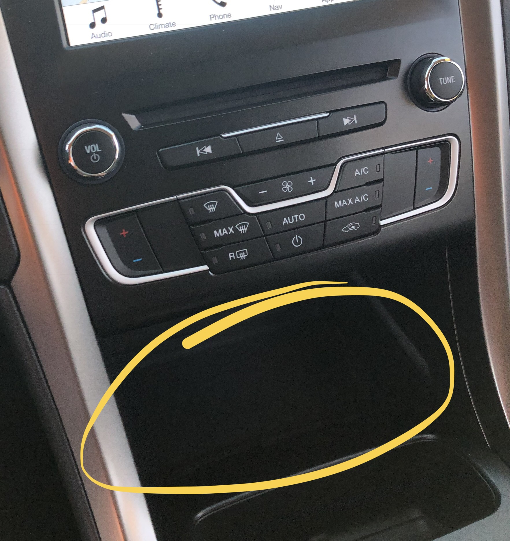

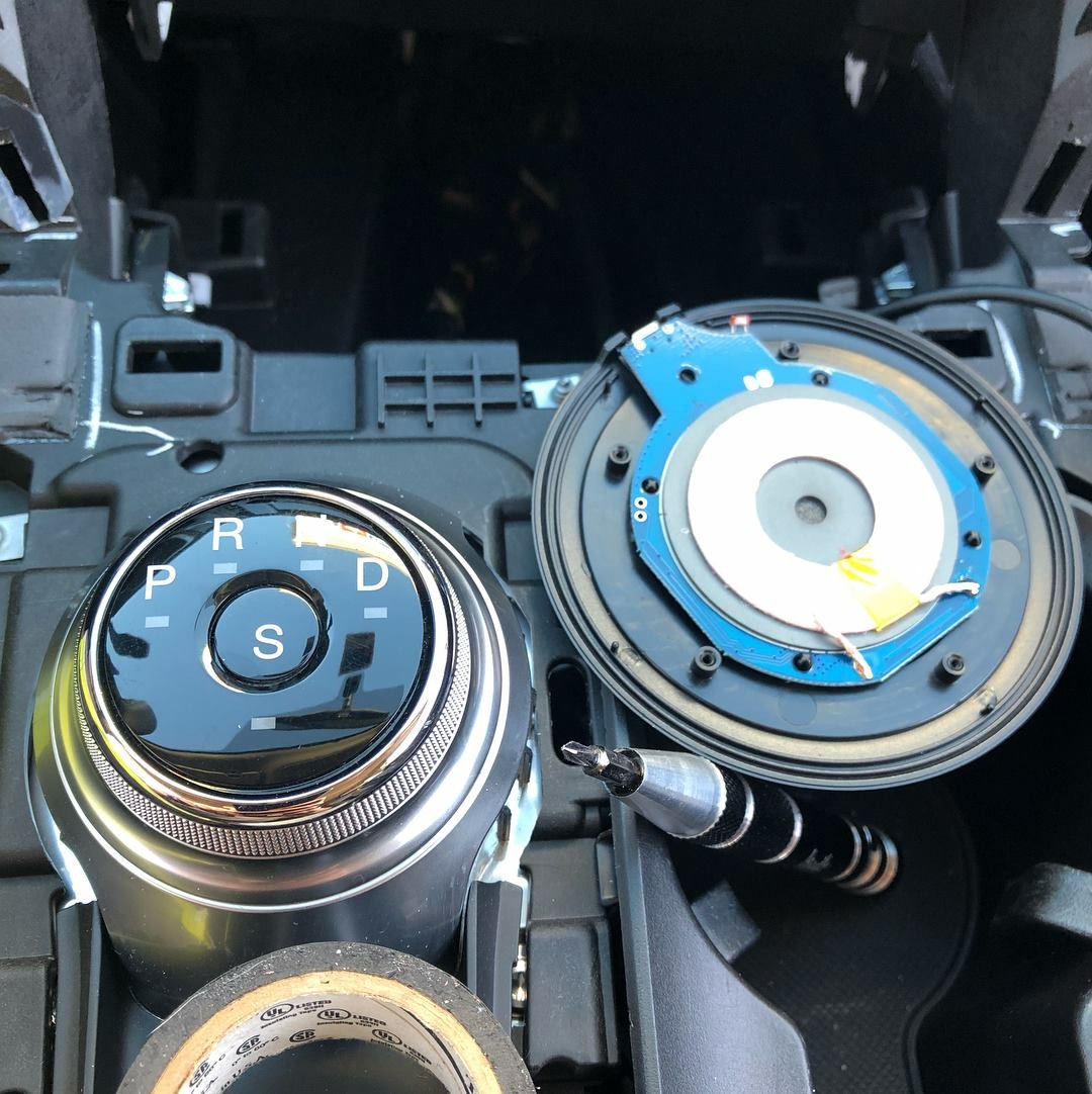

My car’s a 2017 Ford Fusion, and it has a recessed area underneath the infotainment system (in the center console) which fits an iPhone 8 Plus perfectly. I disassembled the wireless charger (purchased from Amazon) and modified the housing to allow for ample coverage and installation. I removed several trim pieces from the center console and ran the USB power cable to an Aukey USB power outlet inside the console under the armrest.
All of the wires and the charger are hidden, so it’s a 100% clean installation. The charger works every time, and I don’t have to find a sweet spot for the phone to sit.
I’m pleased with the result, as I was initially going to use an add-a-fuse to power it, so no extra supplies or soldering needed.

looks good. you my friend are a lot handier then i am 🙂
