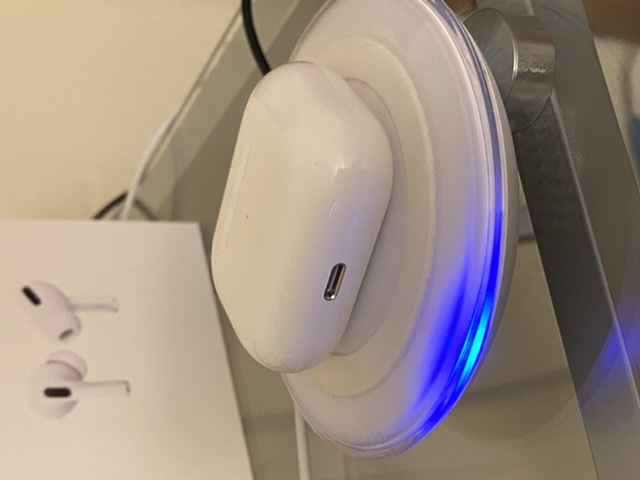

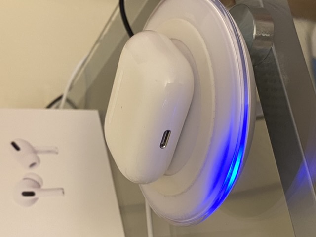

I am curious if people are using the wireless charging feature on the Airpod Pros. Since I have both a wireless stand in my home and in the office, I like to put my airpods on this "cheap" Amazon ordered wireless charger which works for my Iphone.
When I put my airpods on there, I can see it charging but sometimes after maybe 5-30 minutes, the charging will stop. I would think it is charged but when when I check it was partially charged.
It could be an alignment issue but are the airpods that sensitive?

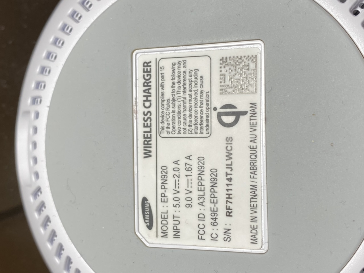

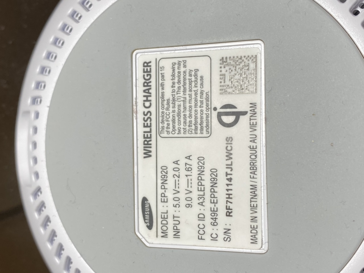

For reference. This Samsung Fast Charge works flawlessly. The Blue light doesn’t shut off, even after charging to %100.
