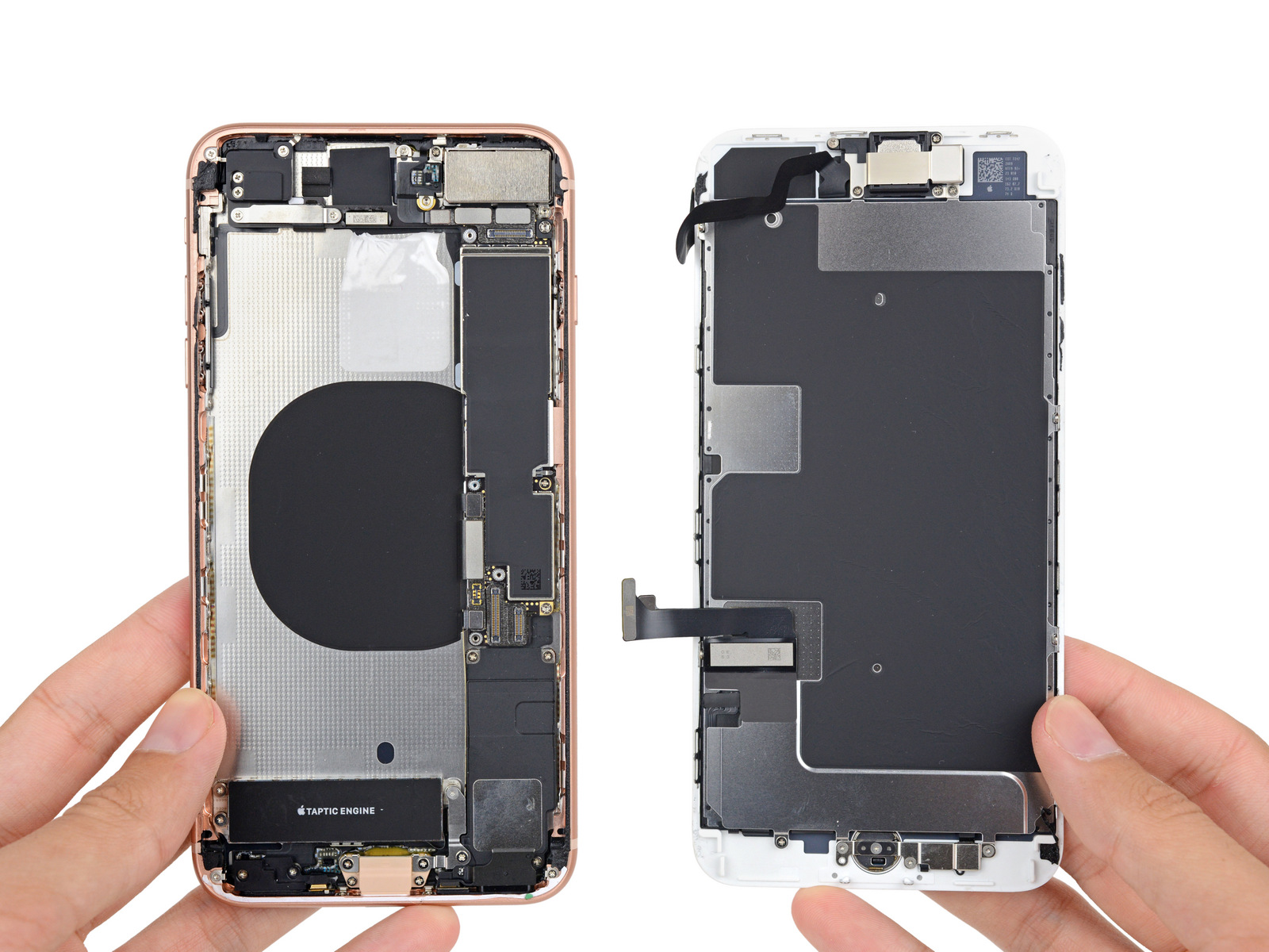

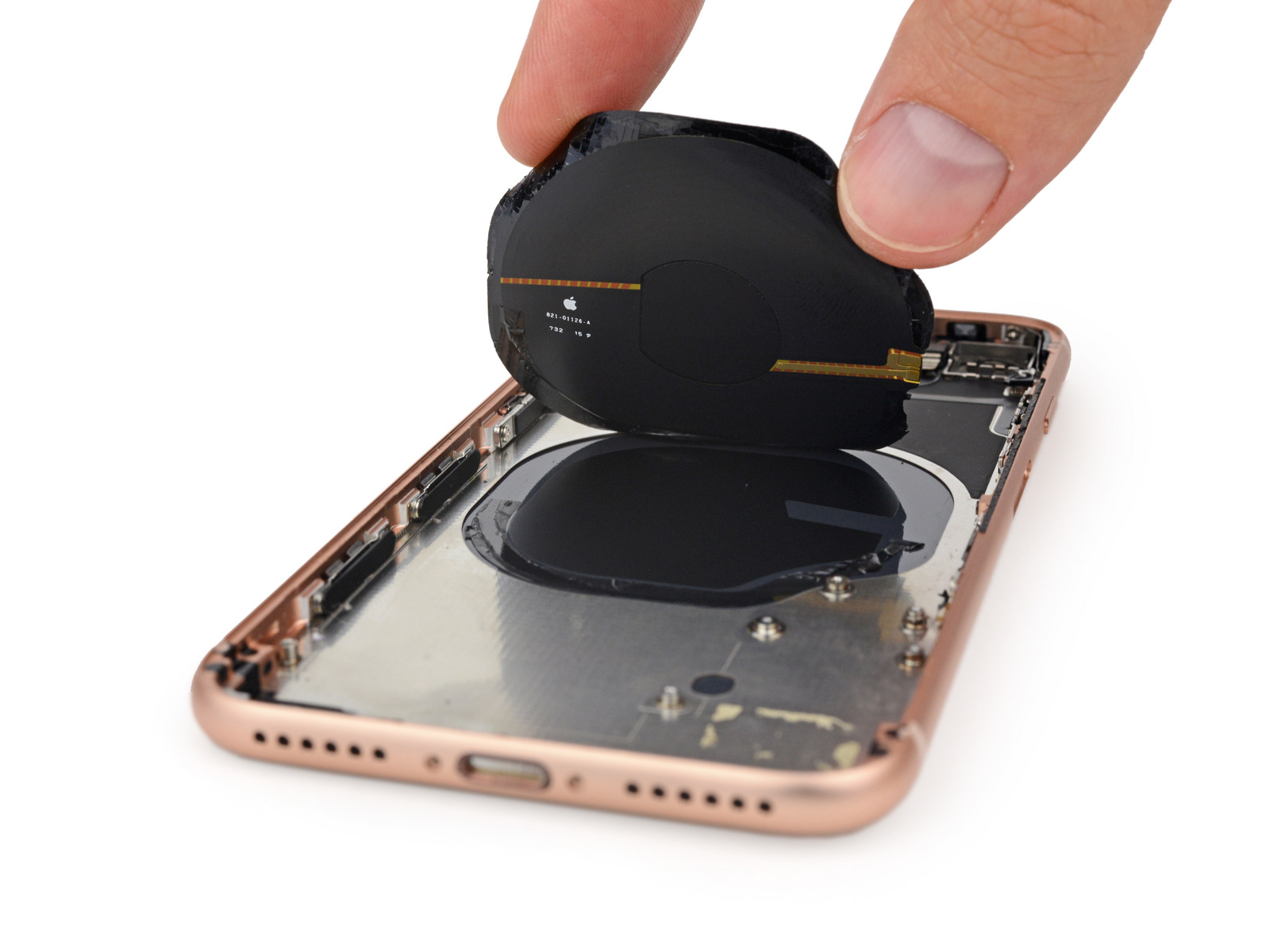

So I believe you have some misconception that the Qi charger inside the iPhone is taking up some massive amount of space. In fact the Qi Charger is nearly paper thin... As iFix it described it...
iFixit said:
  • We dig through some black tape that covers some copper tape that covers some black tape ... wait a second ...
  • That ain't just black tape, it's the elusive Apple-branded, Qi (pronounced "chee")-enabled wireless charging coil!
Source: https://www.ifixit.com/Teardown/iPhone+8+Teardown/97481
I can't tell you exactly how much potential mAh could be gained by using this space for extended battery, but I am pretty sure it's less capacity than that found inside an Apple Watch (205mAh.) Where an iPhone 8 Plus has 2,675mAh... This additional space couldn't be more than an additional 50mAh... Assuming Apple could/would even take advantage of that space as creating a cell to fit that space would be needlessly expensive for little gain
Remember these Terraced batteries were a big deal in 2015 When they were introduced with the MacBook Pro... and even then, these layers are not thin enough to take advantage of a space no thicker than black electrical tape...
source: https://www.wired.com/2015/03/apples-new-battery-tech/
Bottom line: Removing the Qi Charger wouldn't get you any more Pokemon Go time. Those of us who DO appreciate wireless charging don't have to sacrifice anything to make you happy.
View attachment 756939 View attachment 756940
