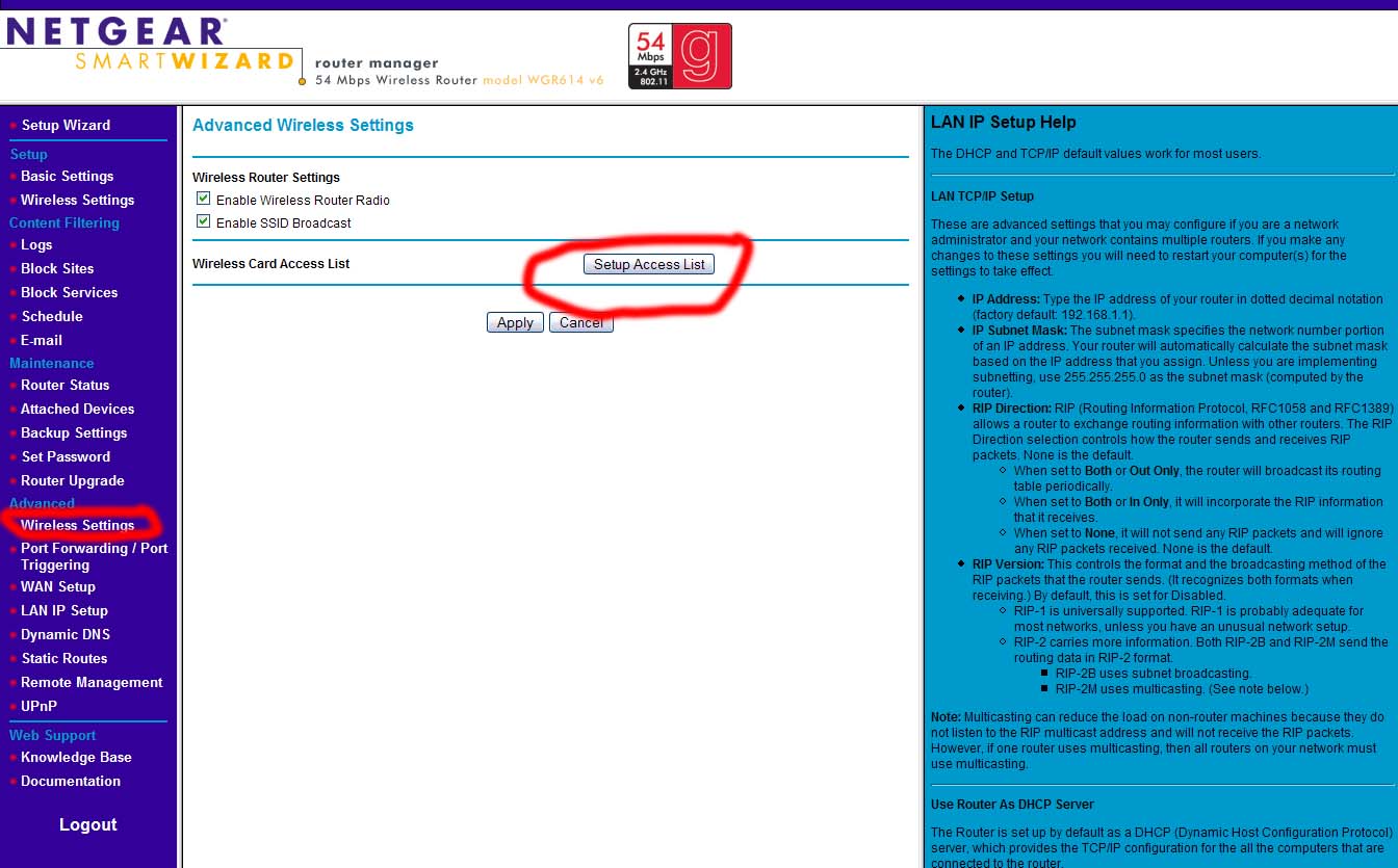

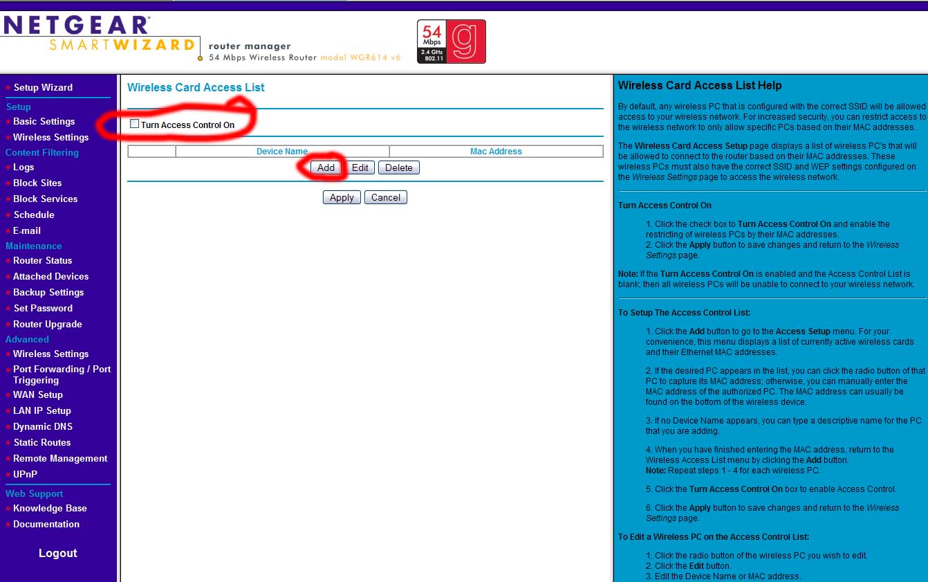

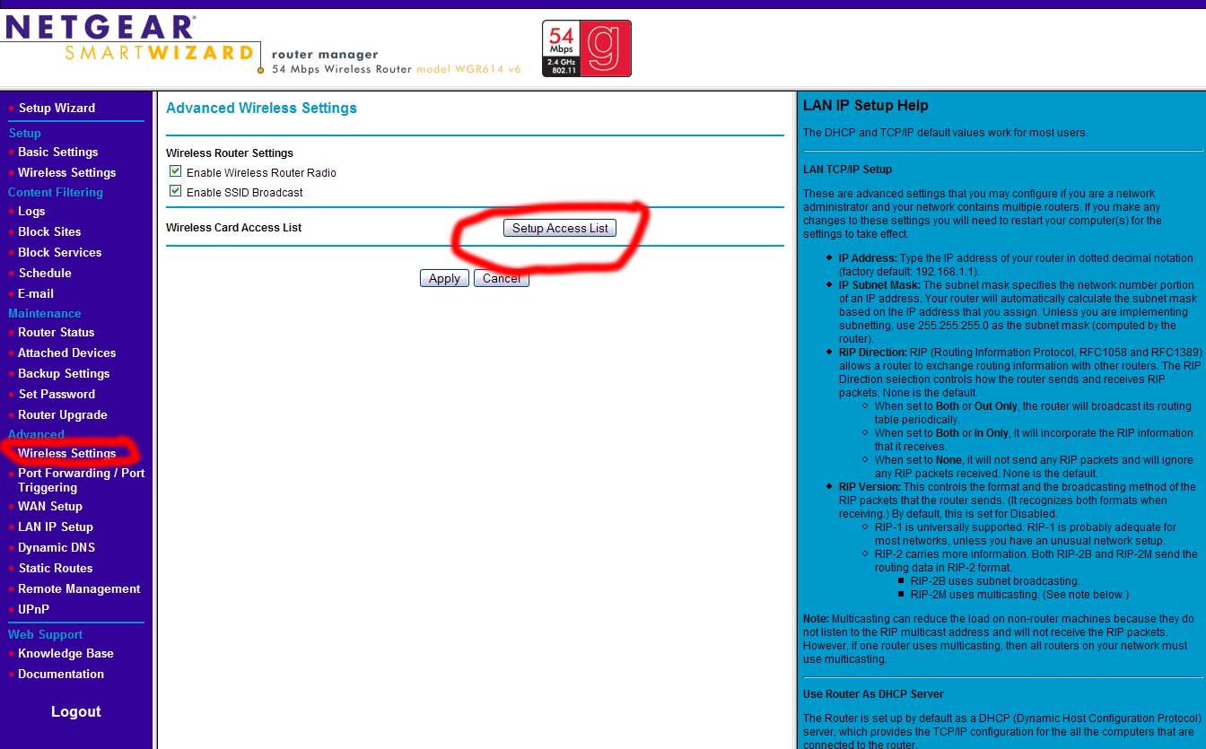

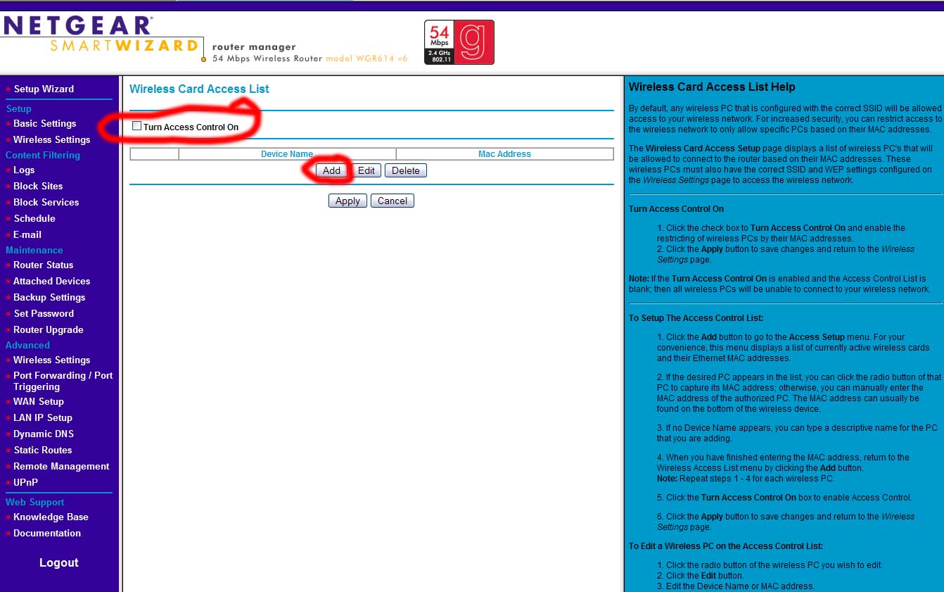

Well I do use a Netgear router but the configuration screens may differ between models. You will need to access the user manual from Netgears website for your specific router if this is of no help. Anyways the MAC address filter is in "advanced" -> "wireless settings" -> "setup access list". If "turn on access control" is not checked then Mac address filtering is not being used. Also of note in "Setup" -> "wireless settings" you can check your routers security options and what the security key is, if any.
If you notice on the right hand side the Netgear gives you some information about what the different options do and how to use them.
