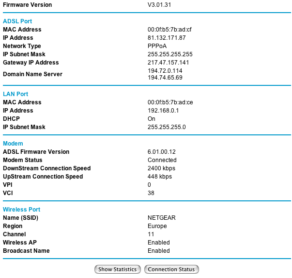

I posted a picture of my modem settings, maybe the fact that DHCP is on is causing these problems? Maybe my router just needs a reboot as it hasn't been turned off in a week?

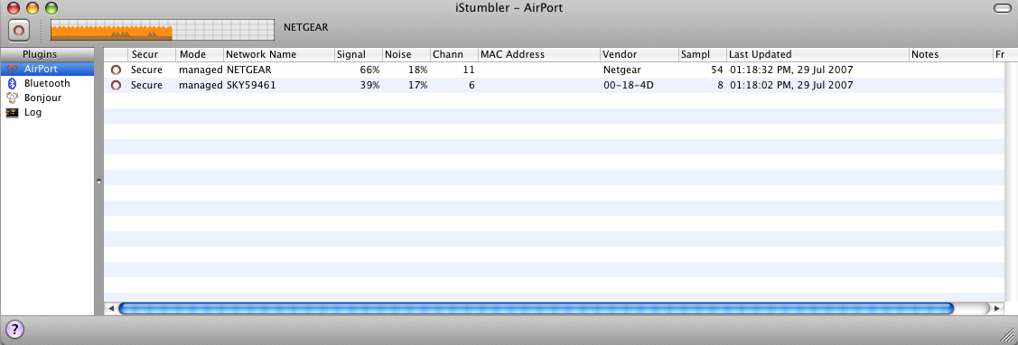

Does anyone know if there's a way to have my Airport completely ignore all other networks and only show mine in the drop down menu? I do have interference robustness turned on. I can sometimes get up to 40% noise on my network according to iStumbler.
Here's what iStumbler says about both networks -
