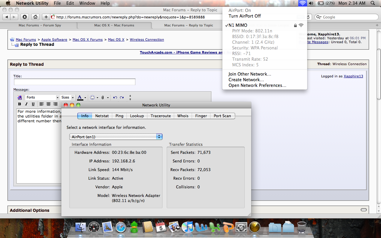

For more information, use 'Network Utility'... type it in spotlight. or find it in the utilities folder in applications. This shows the link rate (for some reason a different number then the option click method)
