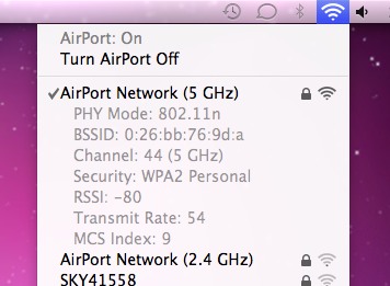

Oooh - how do you get all that extra info in your wifi list?
I'm a little worried about the changes in data rate - I use AirPort disk a lot and, surely, it affects the speed at which data can be transferred?
Alot of things effect your link speed tbh. Other computers, microwaves, mobile phones, wireless phones etc etc. Anything that uses radio tbh. It dosnt have to be on the same freq to cause issues. If it makes enough noise that will cause a problem.
