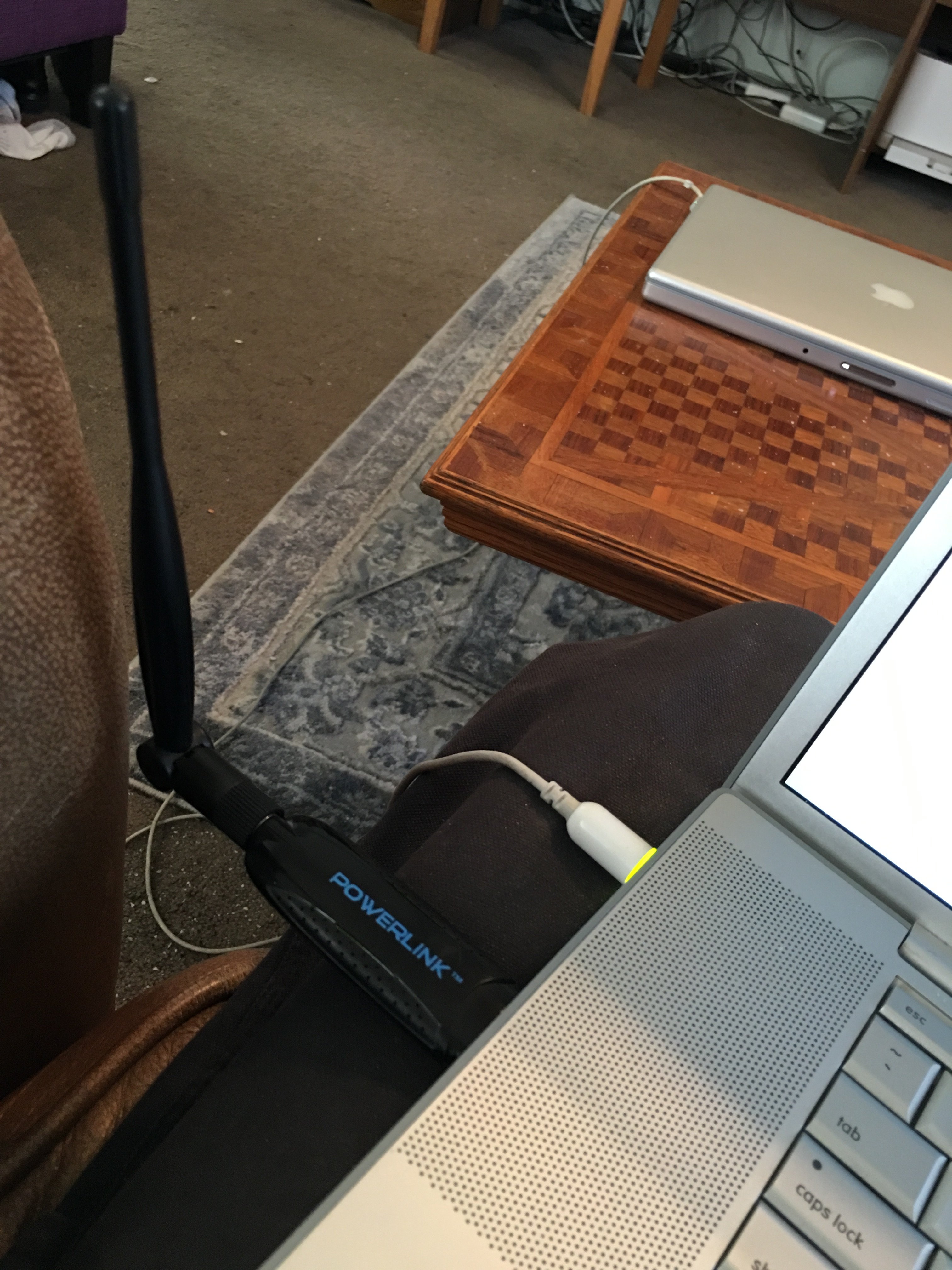

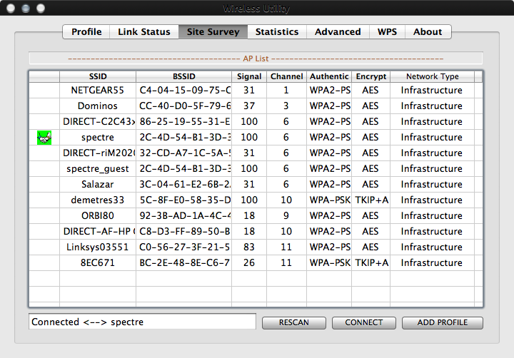

We moved to a new home in April 2018. I have been in the process of cleaning up the absolute mess that is the garage (still a long ways to go). Part of today's work had me run across an old Wireless N USB adapter that a user here sent me for my G4. There is another smaller one outside somewhere, but I will take what I can get.
An Internet Wayback Machine search yielded a driver through the manufactuer of the device for 10.5. The chip is a Ralink RT3070. So, this old PowerBook G4 is now using 802.11n. Just means I got to be careful moving around in the chair though. 😀
Speed in T4Fx is noticeably faster, as is the home network. This means my bottleneck is the Airport Extreme card.
I also do not know why I was expecting 5Ghz, but this device is apparently not capable of that. 2.4Ghz channel only.

EDIT: Added the adapter to a USB extension cable. 😉

I have rediscovered the issues I had with this device back with my G4. It would appear that if the device is disconnected the profile you set in the Wireless Utility that has the WiFi password does not fully connect. You get a signal, but a Self-Assigned IP address.
If you re-enter the password to connect back to the WiFi it works again. So, essentially every time you disconnect you have to re-enter the WiFi password.
If you close the Wireless Utility app you shut off the wireless.
Not something I wanted to be bothered with on my G4. However, for this laptop I'm willing to eat it a bit (at this time). Once you're connected it seems to be solid.
