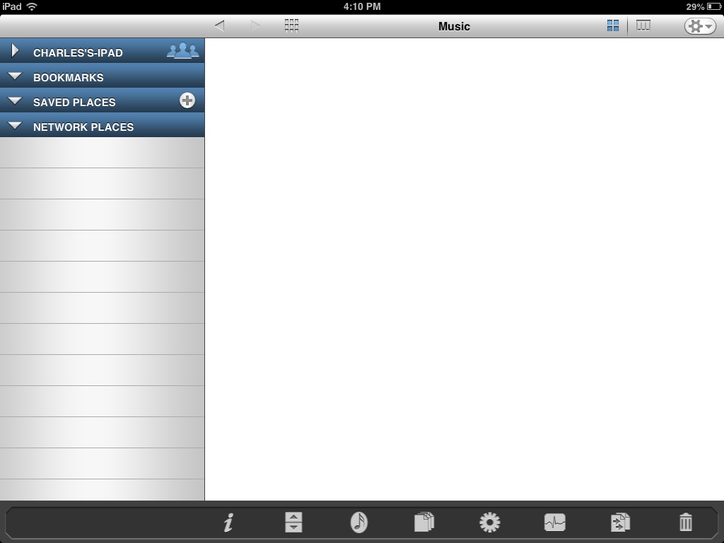

Files Connect HELP!!!!!
I purchased Files Connect and have no idea how to connect to the hard drive that is connected to my wireless router via USB.
My device is iPad Mini.
If anyone would be kind and patient enough to explain this to me, that would be great.
