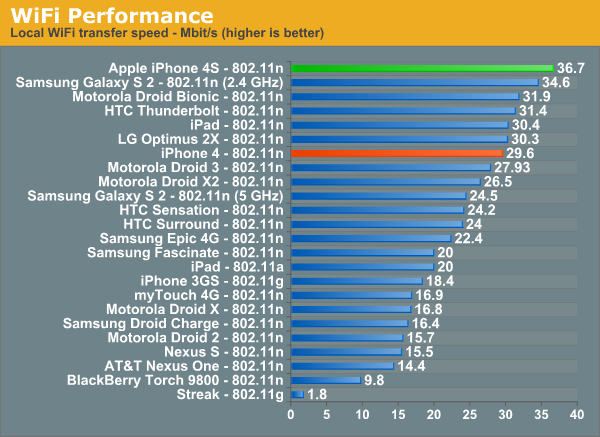

No. i-devices have only one antenna and max out at 65Mbps. To reach the full 300Mbps your device needs to have three antennas.
65Mbps is by the way plenty of speed for an i-device.
Real world tests show even less
The appropriate antennas for these high frequencies look ugly, so we cannot expect high data rates on iDevices and similar small devices, like smartphones.
