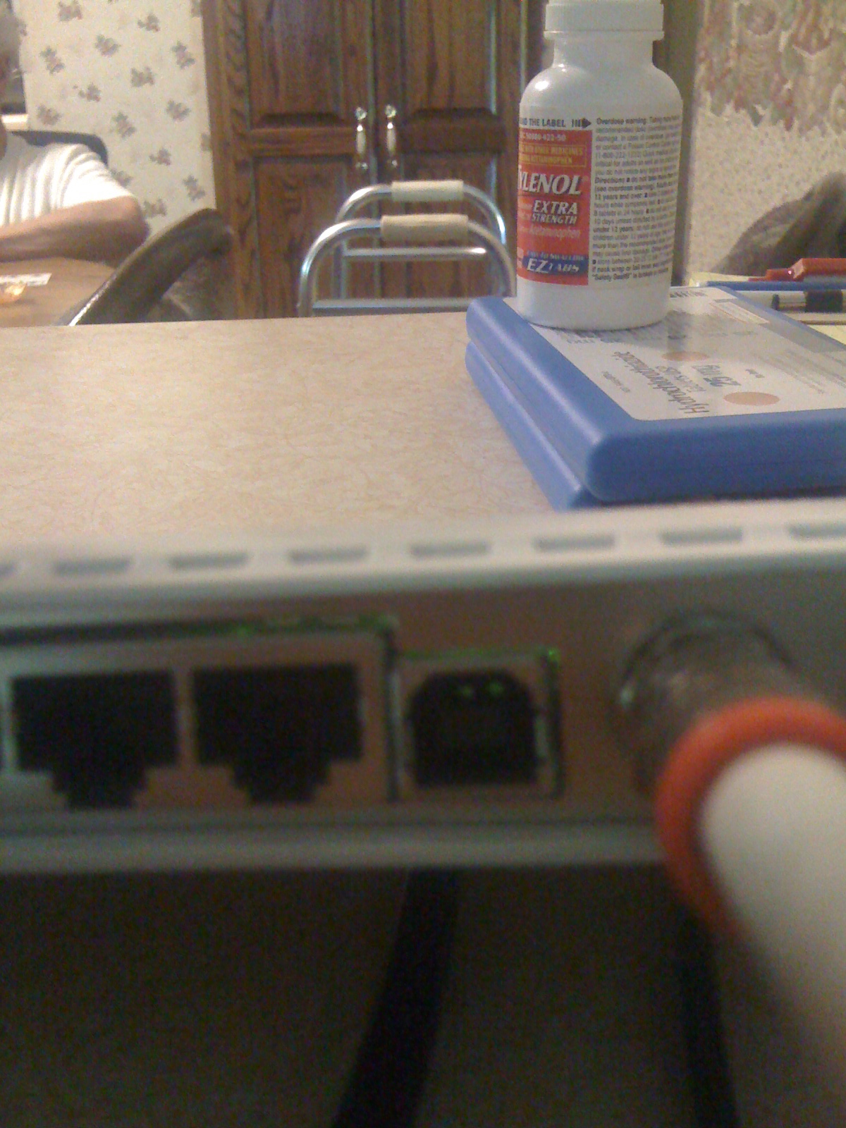

No on thhe printer... but my router identifies this as a usb but usb ports dont fit in it... can someone explain that?
That looks like a Netgear. What model is it (should say on the bottom)?
Also, rectangular USB connectors will physically fit in most ethernet jacks!😛
I see the USB port, but it might not be designed to connect to a printer. If that is a coax cable on the right, the router is probably also your modem, and a lot of modems have USB ports to connect them to the computer if you have a computer without ethernet/wireless. If that is the case, you probably can't use that USB port to connect a printer since the router is not expecting one.
My D-Link has a USB port like that and it's only to connect the PC to set up the router before it connects to the network. But like galstaph said, I'D go with a lttle print server that connects to the printers USB port. Cheaper than a new printer.
