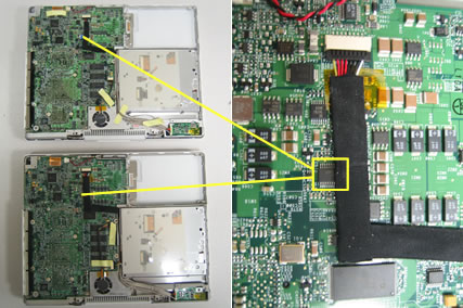

...but i fixed mine by soldering the gpu, which is the chip under the hard drive cord. a helpful site...URL="http://coreyarnold.org/ibook"]http://coreyarnold.org/ibook[/URL]
btw, that was today. and i did it w/a screwdriver and the stove burner!
