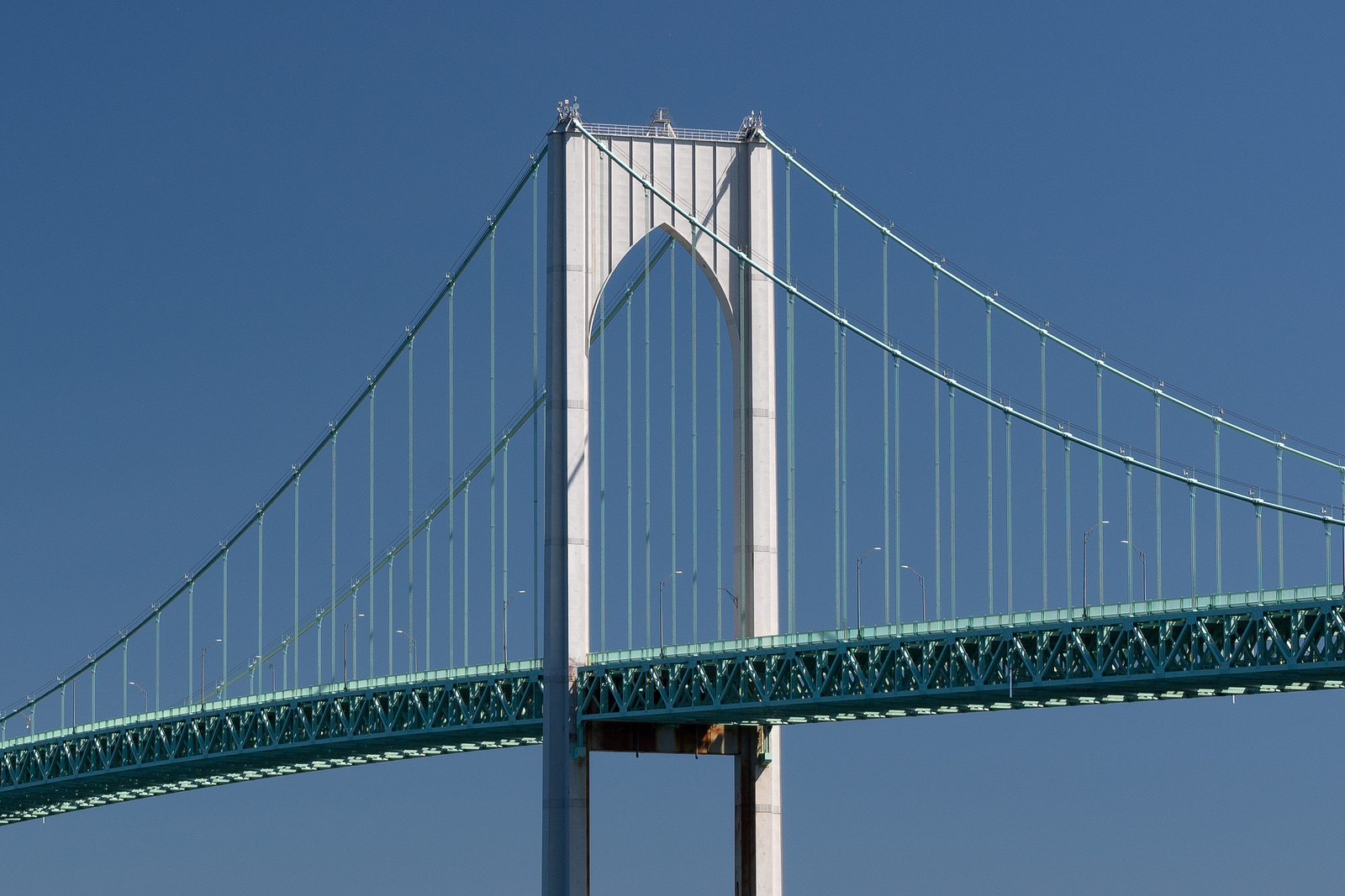

Shot this today of the Newport bridge. Sony A7RIII, Zeiss Batis 85mm @f/11, ISO 100, 15 stop ND filter with an exposure time of 91 sec. Focus was set manually on the big rock in the foreground without the filter attached. Obviously on a sturdy tripod with a remote release.
The sharpness is kind of wonky throughout the frame with the nearest tower blurred though objects nearer and farther away are sharp. It's not a lens issue or a technique issue--I have to blame the ND filter. It's a Singh-Ray filter which isn't cheap, but sharpness is really wonky for no obvious reason. Things that should be in the plane of sharpness aren't. Not field curvature as the lens isn't known for this and my copy of the lens doesn't have it either. A 10 stop ND filter didn't show this behavior. Hard to imagine that the bridge itself was moving during the exposure as the pattern of spotty sharpness doesn't relate to structural elements.
Something commonly seen with 15 stop ND filters? Planning on contacting Singh-Ray as this behavior makes the filter pretty much useless.

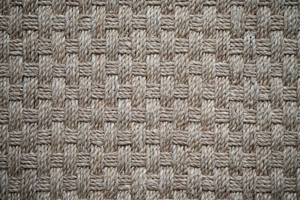

That was my thought too. Spent today testing the filter in question. Some pics below. On a good note, I received an email from Singh-Ray stating that they had passed my images to their engineers who felt it was a bridge motion issue. But they want me to send the filter to them for testing. I included the images below (as well as some other examples) in reply.
In both cases shot with the best technique I know of. Sturdy tripod (Really Right Stuff) and a solid head (the Cube). Shutter tripped externally.
Sony A7RIII with Zeiss 135mm Batis at f/4 and ISO 200. Focus acquired with AF without the filter and then camera focus set to manual to retain focus for both shots. IBIS off for both shots. My usual sharpening applied to both shots in post and minor exposure adjustments made in post to make both shots similar. Otherwise no tweaking. The first example without the filter, the second with the filter.
Not sure how well these examples will look on the site. Very, very obvious when looking at the actual images (and not pixel peeping). Sending my filter back to Singh-Ray. Also trying Formatt-Hitech as an alternative....
1/50 sec without a filter
243 sec with the 15 stop ND filter

Got the replacement filter from Singh-Ray. Also got a set of filters from Formatt Hitech.
The replacement filter from Singh-Ray is much better than my first filter, but still with significant loss of detail. The Formatt Hitech filters are significantly better.

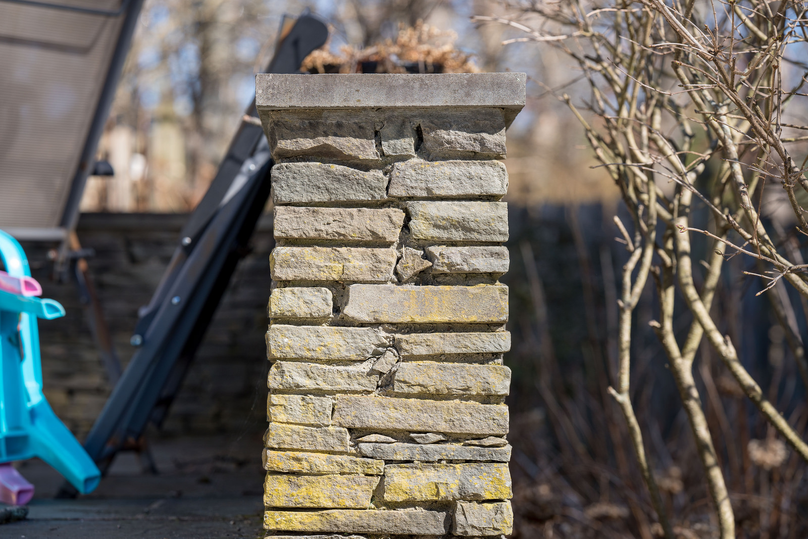

Including a series below. All shot with the same camera (Sony A7RIII) and same lens (Zeiss Batis 135 f/2.8). All shot from the same position on a Really Right Stuff tripod with cube tripod head. All shot with a wired Sony release cable. All shot with focus acquired using AF without filters and then set to manual to keep focus constant between pics. All shot @ f/5.6 and ISO 100. Since this was about focus and not color shift, all images set to auto WB in LR. All images shown with the initial uncropped capture and then with a center crop that was copied in the initial image and then pasted to each. Sharpening of 56 in LR applied to all (roughly my usual sharpening in post to any image).
No filter. 1/200 sec exposure.
Center crop of the no filter pic.
Replacement Singh-Ray 15 stop ND filter. 122 sec exposure. Definitely better than my first copy, at least in this uncropped image.
Center crop of the Singh-Ray replacement filter image. Obvious loss of detail compared to the unfiltered image. For some applications this would still be an acceptable image as the loss of detail wouldn't be noticed. But it remains a significant loss in detail. This is from a replacement filter which Singh-Ray presumably thought was acceptable given my problems with the first filter.
Formatt Hitech 16 stop ND filter. 243 sec exposure.
Center crop of the Formatt Hitech image. To my eye detail is very slightly degraded compared to the unfiltered image, but it is *significantly* better than the Singh-Ray image. Very usable either with cropped images or with large print sizes.
The Formatt Hitech system is a bit more cumbersome to use as it requires a filter holder and isn't screw in to the lens. However, the filters come with the holder system (at least as I purchased them). Slightly more of a PITA to use, but easy to use the included step-down rings which also make the same filter work with lenses having different sized front elements. Because the filter itself is large (100mm for the ones I have), vignetting isn't an issue and they can be stacked.
Really happy with the test images I have taken with the Formatt Hitech filters. Will be returning the Singh-Ray filter.

Update using the Formatt Hitech ND filters. Specifically regarding color shifts. I don't see any, even with very long exposures.
Same subject as my original post. Again using a Sony A7R3 body but this time with a 70-200 f/4 lens. For this shot f/11, ISO 100, 5 min exposure. On a RRS tripod with geared head (the cube) as true for all the other shots. Wired remote release. 13 stop Formatt Hitech ND filter stacked with a Formatt Hitech circular polarizer. The combo is roughly equal to 14 to 15 stops of ND.
This was close to a "perfect" exposure when exposing to the right (i.e. exposing to avoid highlight blowout). In post, underexposed it by ~1.2 stops.
Sharpness is maintained despite the filters. The loss of sharpness using the Singh-Ray filter *wasn't* likely a reflection of bridge movement with the long exposure. I think it really was a filter issue.
More importantly, color fidelity is maintained without color shifts that can be seen with ND filters and very long exposures (something I did notice using Singh-Ray filters and very long exposure).
