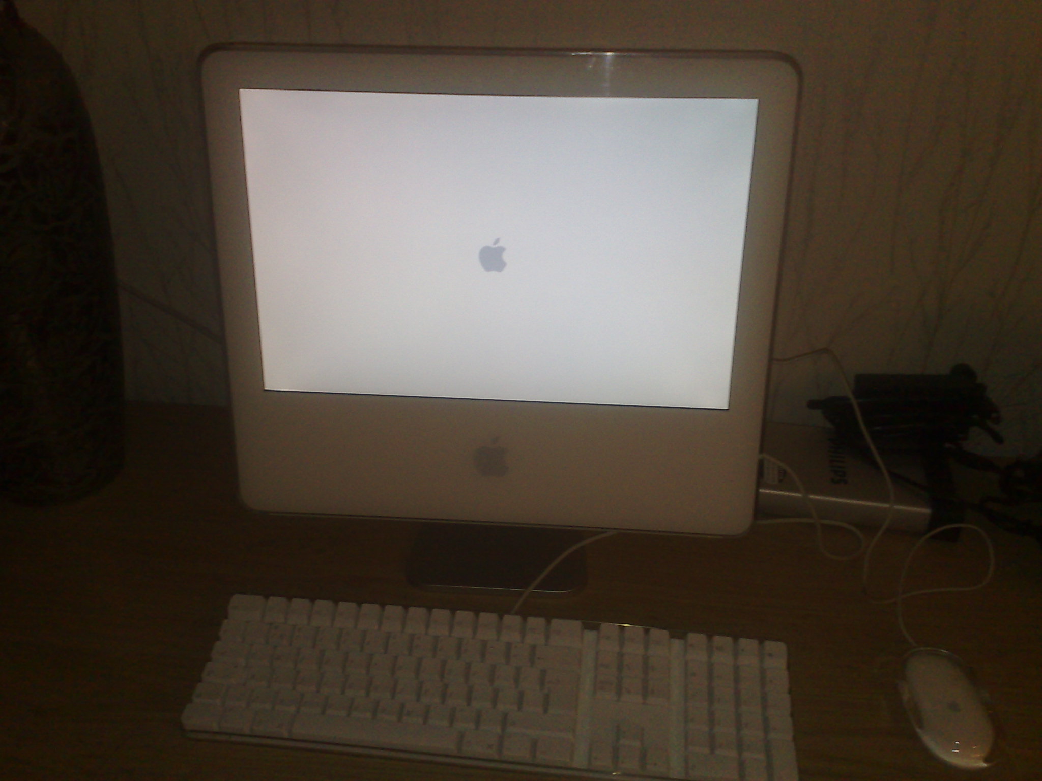

Hi,
When I press on power button, I hear start sound and then I see a grey screen with apple logo.. after a few seconds I just hear fan noise.. It doesn't boot up..
What is the problem? I'm newbee.. please help me

i dunno.. im a big noob.. that's my first mac.. i got from my friend and he said that it won't boot..
i posted a screenshot

That's an iMac G5 (PowerPC, not Intel).
