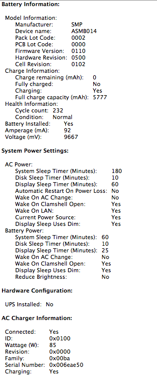

I don't see system information under utilities. However, I did snap this screen grab from the power menu under the system profiler......
Sorry, I don't remember if they changed the name of that utility in 10.7 or 10.8, but System Profiler and System Information are the same thing.
It looks like your battery is not charging at all. I would guess that something is wrong with the battery or the charging circuitry on your logic board.
