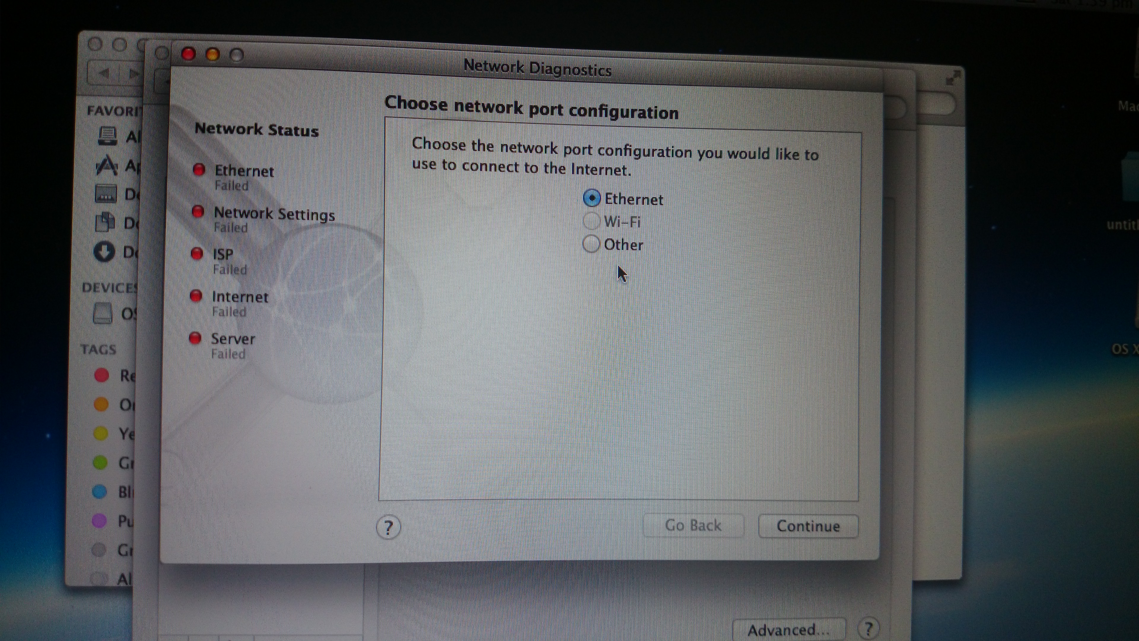

I can't seem to figure out how to connect to the internet internet um trying to tether off my phone like I do know windows but I can't get wifi to turn on
In network port configuration, down the left side there is a list
Ethernet
Network settings
Isp
Internet
Server
All of them have a red dot and the word failed underneath them
I'm not sure what to do as this is my first Mac

i have attached a pic of my internet problem
also opened uo another thread regarding reboot problems as well

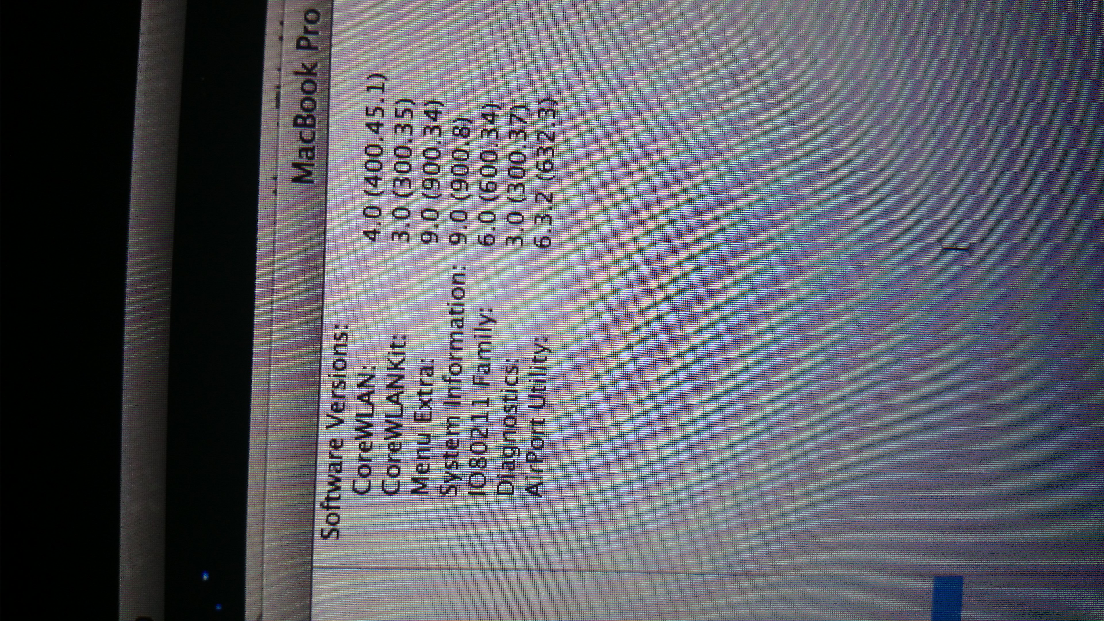

Click :apple: in the top left then "About This Mac". Hit "More Info" and then "System Report". On the side of System Report will be a Wi-Fi section. Select it and take a picture of the screen. If it doesn't recognize the card, either the Wi-Fi card is bad or was removed before purchase.

i dont know if it is recognizing it or not

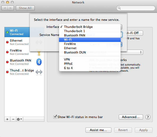

Try opening System Preferences and clicking Network. In the left towards the bottom, you will see a plus sign. Click it and choose "Wi-Fi" as the Interface and call it "Wireless". See if you can select a network in the right side of the window and hit Apply.

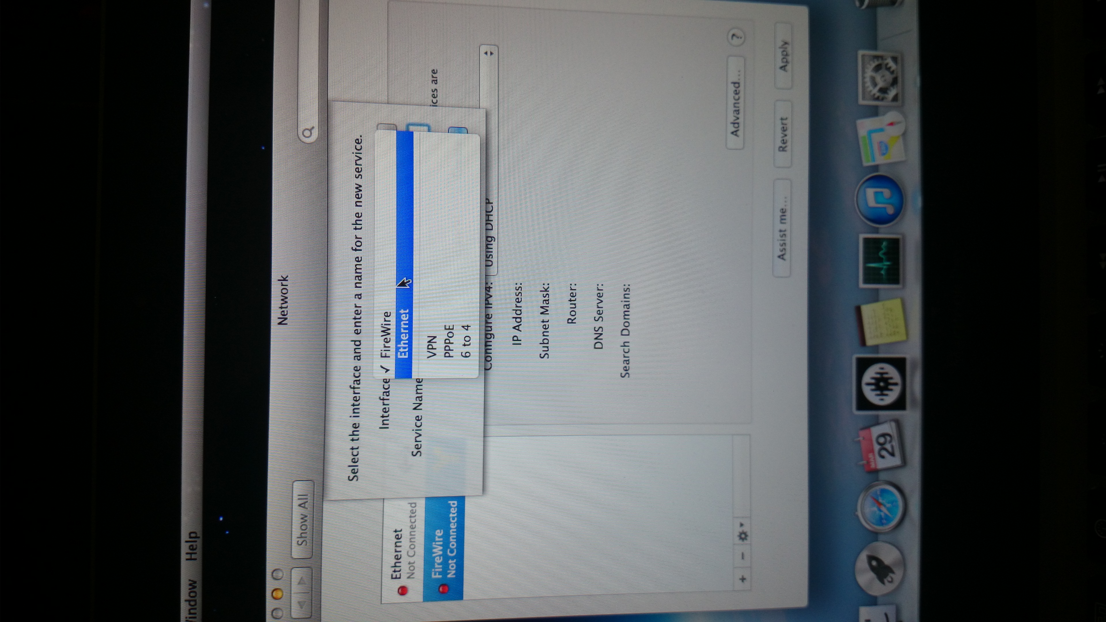

this is all i can see
It appears that either the Wi-Fi card is not working or removed, or there is software corruption as a result of improper imaging by the previous owner. Either way, it should be fixable!
