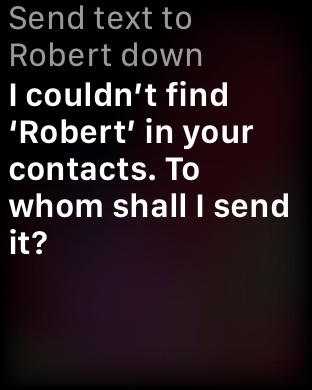

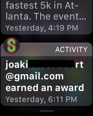

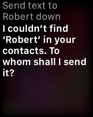

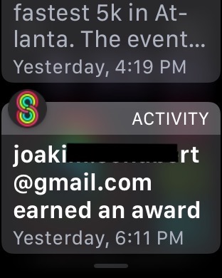

So out of the blue, my Apple Watch running lasted WatchOS and iOS Beta 12 just stop syncing my contacts. I've done everything from restoring, and even using the Watch App to resync the data. The calendar works but my contacts aren't syncing. So when I get a message, it's just the number and not the name. No contacts are in it either. So I can't make a call using Siri.
Thoughts?
