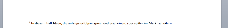

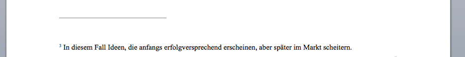

I have some trouble with the footnotes in Word 2008. As you can see in the attachment there is quite a lot of empty space between the horizontal line and the actual text. I'd like to have the line almost right on top of the text. Unfortunately, I have absolutely no idea, what the trick is. I hope you have 😀

Found the solution 😀
View -> Draft
In Draft mode: View -> Footnote
and then there at the bottom is a menu... where the footnote separator is selectable. Yeah... and there were some lines... don't know why 😕

Thank you so much... that worked for Word for Mac 2011!
Had me stumped for ages!!
