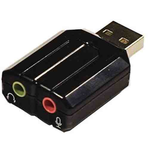

I was just looking around and would this perhaps be a good option?
If I'm mistaken on this, others are welcome to jump in and correct me.
The audio-out jack supports both analog out and digital (optical) out.
The digital/optical connector is shaped differently than a standard analog stereo mini-plug, and when inserted, it activates the digital/optical output.
The "red light" you see at times -is- the digital/optical output. When this is on, the analog output is OFF -- hence, no sound.
This sounds like your iMac is getting "unintentionally switched" into digital mode, even though you inserted an analog plug into it.
I'm thinking that perhaps the shape or size of your particular plug may be doing this.
Do you have a DIFFERENT plug you can use?
If you're plugging your headphones (or whatever you're using) directly into the iMac, you might consider an "extension cord" (has a plug on one end and a jack on the other) and use that "between" the iMac and your plug. Could be a "cheap fix" that works...
If that doesn't help, the USB audio adapter in post 2 might work.
There are also USB "DAC's" (digital audio converters) that provide excellent sound, but they're almost certainly more expensive...

Here is the thing. When I plug in anything into jack connection (speakers/hearphones etc) it still seems to be playing up, with the sound cutting off all the time. I assume I would need a USB audio adapter to do that, right?
If nothing else seems to be working at the audio out jack, you could get some kind of USB-based audio adapter.
I believe you need to plug the USB adapter in, and then go to the sound preference pane and specify that audio output be sent via USB, and NOT through the [problematic] audio-out port...
Just wondering, the USB adapter you showed in post 2, where did you find that?
Cheers!
I will order one and see how it goes. The one on the picture is just a random one from Google Images. I think I'll get a cheap one from eBay and if it doesn't work then I get an iMic, which is more expensive but compatible with Apple.
Cheers!
FWIW, that one you've pictured is a SYBA SD-CM-UAUD adapter. Cheap, and quite good actually. I've used one and it works well.
