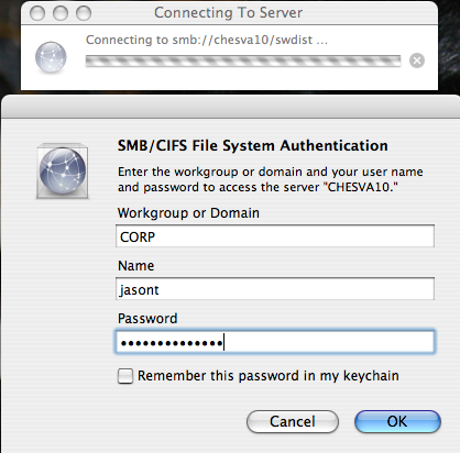

Weird, I have no problems connecting my 10.4.8 MBP to server shares on my companies Active Directory network.
Are you typing in the correct domain name as well as your username/password?
