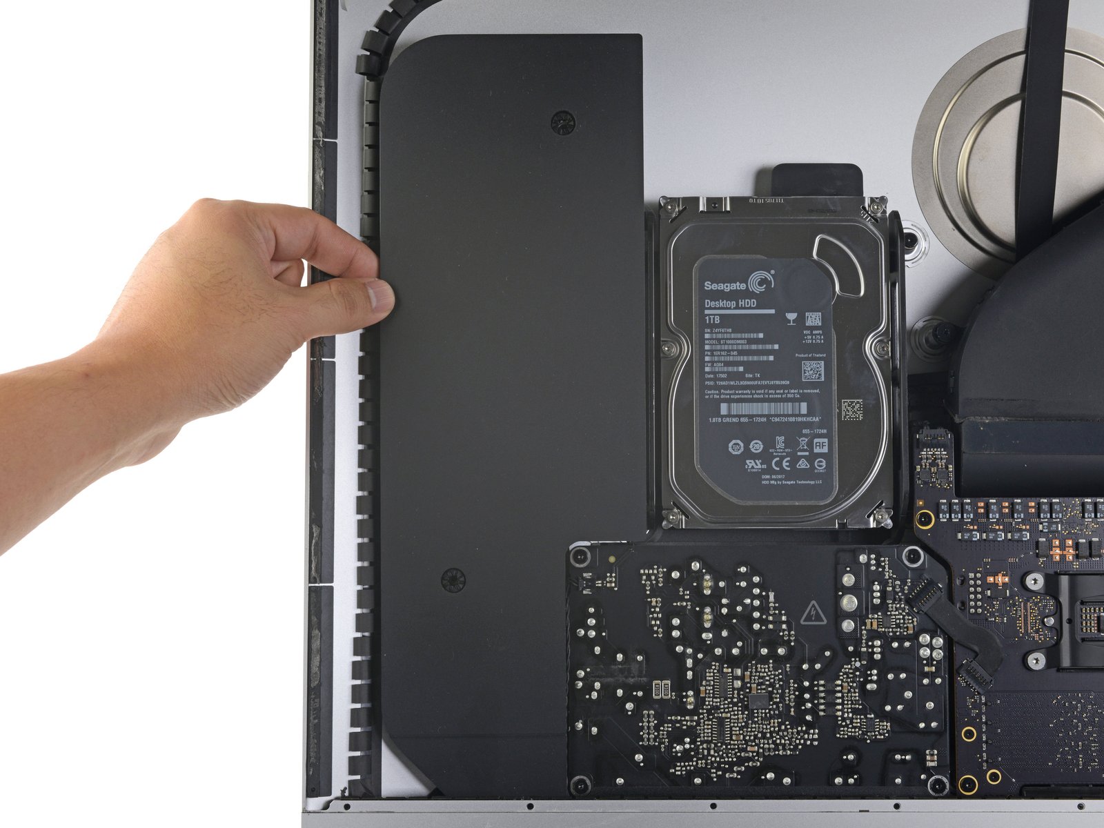

Thanks all, so the 1TB HDD and 32GB SSD are two seperate components then ? I got the impression it was a single hydrid drive (HDD + SSD).
So the drive shown in the picture below (from iFixit) is just a 1TB HDD ? And the 32GB SSD is a drive fitted somewhere else ?

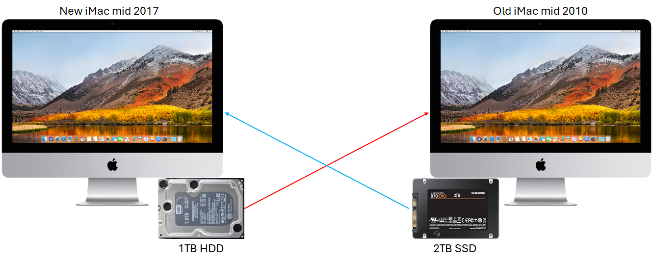

If thats the case, I only want to move the 1TB HDD to the older iMac mid 2010. I dont want to touch the 32GB SSD in the newer iMac mid 2017.
Basically I am just trying to swap drives between the older iMac (which was broken but I fixed it by baking the video card) and the newer iMac as shown below...
The old iMac had the 2TB SSD, the new iMac has the 1TB HDD
As the new iMac will be the primary machine and the old iMac will be the secondary machine, it makes sense to fit the bigger drive in the newer iMac.

Since you insist on installing the SSD internally...
As the 2TB SSD has already run fine on the 2017 iMac, now all you have to do is to purge and remove the Fusion drive from it, to clear space for the 2TB SSD.
Basically the Fusion drive or any part of it will not be able to run normally in the iMac 2010, you can't do anything but wiping it off and do a clean install of Mac OS.
1) Create a USB installer of Mac OS X High Sierra. (You can do it from the iMac 2017, if it is still running High Sierra)
2) Purge the Fusion Drive: Boot from the external SSD, run Disk Utility and delete the Fusion volume.
3) Swap the drive: Swap the 1TB HDD with the 2TB SSD on iMac 2017
4) Re-assemble iMac 2017 and test run: As the Fusion drive was purge, there is no Mac OS file on the 32GB internal SSD, iMac 2017 is supposed to boot directly from the 2TB SSD without any interference.
5) Assemble the 1TB HDD to iMac 2010
6) Plug in the USB installer and install Mac OS to the 1TB HDD.
