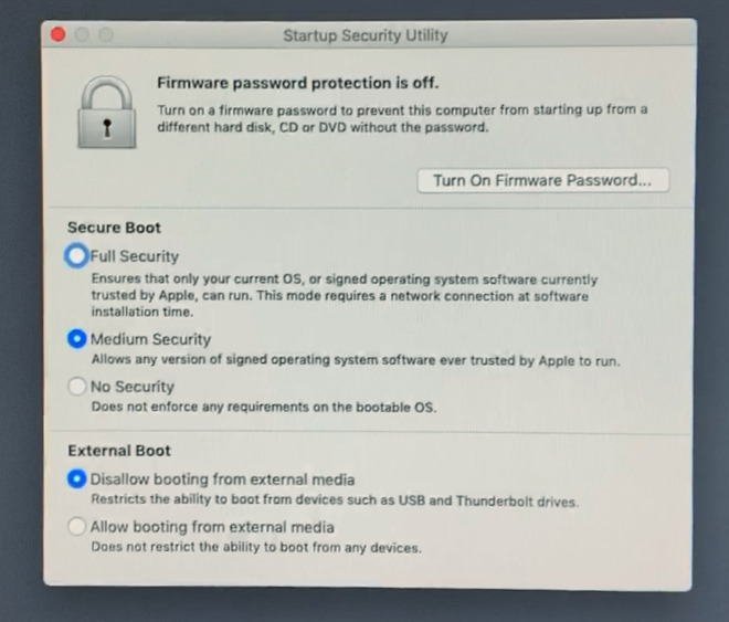

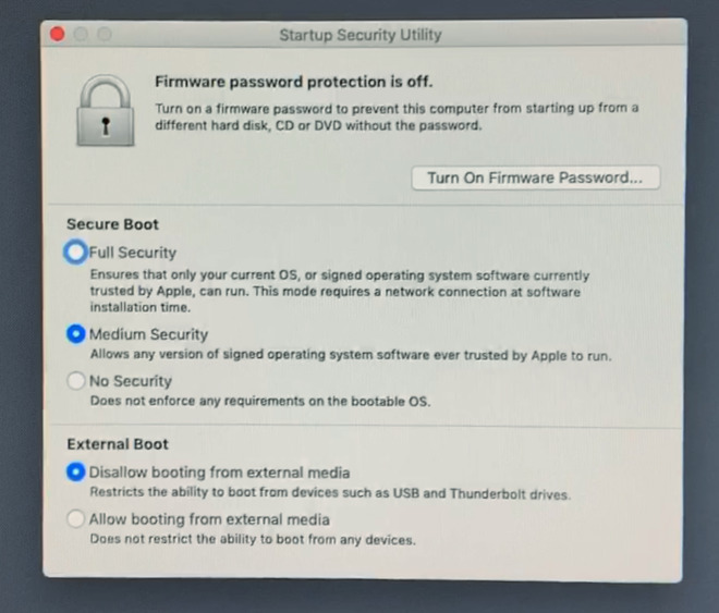

Buy a Mini with Mojave. Change the Mac Mini T2 settings to medium security -> Allows any version of signed operating system ever trusted by Apple to run:

Looking at those T2 security settings it might even be possible to maintain that on High for the most part, then drop temporarily to medium when you just need to a VM or external drive.

It's unclear how and what the T2 security chip will do if you roll back to an unsigned Mojave copy; meaning that what you made with the USB installer is an unsigned Mojave copy. The T2 security chip design was to prevent booting from an unsigned operating system, either from an external drive or from a network boot. You can bypass this security feature by setting it to medium or low, but you'll lose a number of security benefits when future software demands it and with the T2 protection, some software may inadvertently be blocked even if, as you said, is capable of running in 64bit. Sort of like the iOS devices; you can move forward but you can't roll back to the previous version easily. So if you start out with a signed Mojave copy, then updating to Catalina and onwards is best.
